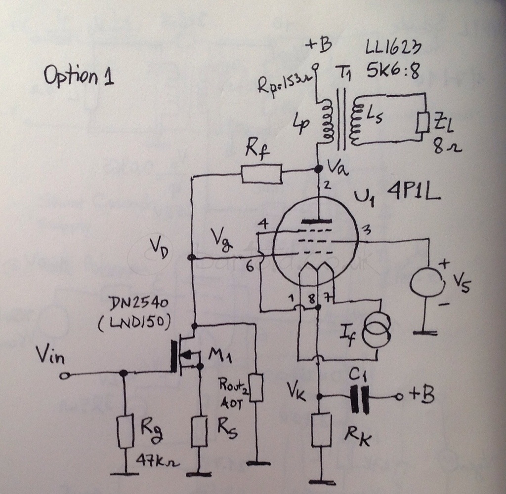

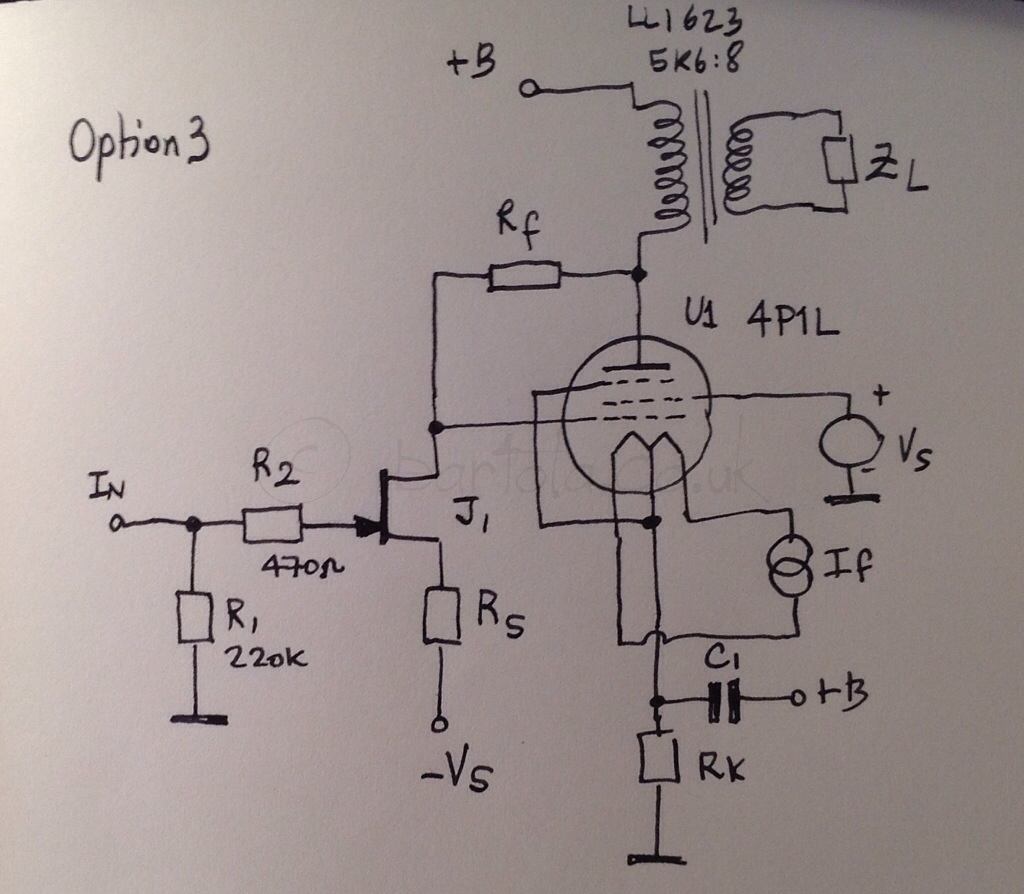

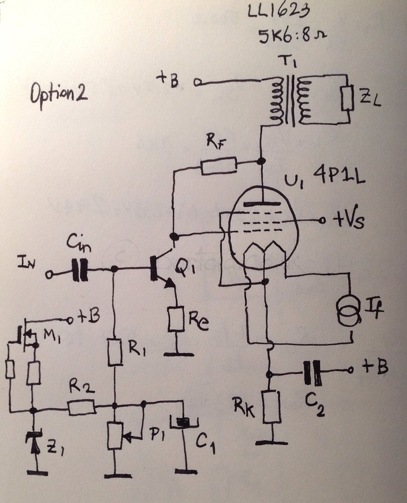

Thanks both for the great input, I'm learning a lot with this experiment.
So here are the 3 options to test:
1) Option 1: HV depletion FET using DN2540/LND150
Disadvantages: may be difficult to calibrate given FET variance of parameters. Also output capacitance proved to be increasing distortion at HF. Challenge is to test with better OP and higher Id to increase slew rate. Also may need a shunt resistor to achieve the FB level desired.
Advantages: I like sound of depletion FETs. Simple circuit and no additional power supply.
2) Option 2: Bipolar common emitter driver
Disadvantages: bipolar sound? Needs an additional supply for bias and also an input capacitor.
Advantages: easier to calibrate due to parameter consistency and tolerance. Lower output capacitance to improve HF response
3) Option 3: JFET input using LSK170, BF862, etc.
Disadvantages: jFET distortion at higher signal levels. Additional bias supply required for source. Difficult to calibrate given FET variance of parameters.
Advantages: jFET sound. Low output capacitance to improve HF response. No additional input capacitor required.
Did I get these right?

You got it Ale. And yes, simple ckt is the place to sharpen the feel.
Some notes you may consider :
We match semiconductors for simple gain circuits with little or no loop feedback due to device variance. Idss and Vp on JFETs, hfe and Vbe on bipolars and Vgsth and Gm on MOSFETs. Otherwise we are forced to operate the device away from the sweet spot or use more feedback.
I may repeat things you already know but just in case. The Y(ellow), GR(een), BL(ue), V(iolet) suffix are used by many japanese manufacturers to grade their bipolars on hfe and FETs on Idss, details usually found at the bottom of the first page of the datasheet. European manufacturers prefer A, B, C, D, E suffix. While Fairchild prefer to just put different part number like J111, J112, J113. Not so sure on others.
On option 1, the need to raise Id is to find a more linear OP. Main problem is low Gm (slope of transfer characteristics) that varies nonlinearly with Id at low Id value.
On option 2, when filament bias is used, current diodes or cascoded JFET CCS feeding the zener or LED can be supplied from the gyrator (+) end of your filament regulator. Hfe matching is not mandatory but improves imaging and separation.
On option 3, if an input coupling cap and biasing network similar to option 2 is retained on breadboarding phase, no additional supply is required. You may pursue further improvements if the "JFET sound" justify more efforts.
