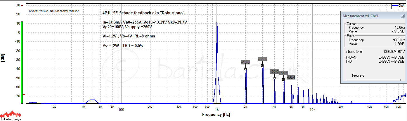

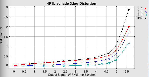

What's causing 3HD to increase faster than 2HD nearing 3W output? Is that normal for a 4P1L getting near clipping? Maybe the onset of grid current?

I will post the anode curves when I get the chance but the wider the signal is spread out is exposed to curves not that evenly spaced. This spice model doesn't include a proper grid current model so you should expect more grid current to kick in and higher third order distortion as a result.

When added the blue, red and green curves exeed the value of the black curve. How can that be?Nope. See legend. It's THD. Blue and red are 2nd and 3rd harmonics 🙂
You don't sum them up directly, Wikipedia for you: http://en.m.wikipedia.org/wiki/Total_harmonic_distortion

You don't sum them up directly, Wikipedia for you: Total harmonic distortion - Wikipedia, the free encyclopedia
Ale, I hate to be nit picking but it seems your software is comparing harmonic powers to the fundamental power, so these numbers should add up. A better method for obtaining data would be the ratio of harmonic amplitudes to the fundamental amplitude. Outcomes differ but I guess it's for the sake of the argument not that interesting..
THD is a square root of a sum of squares of all harmonics (in normalised values, not percents).

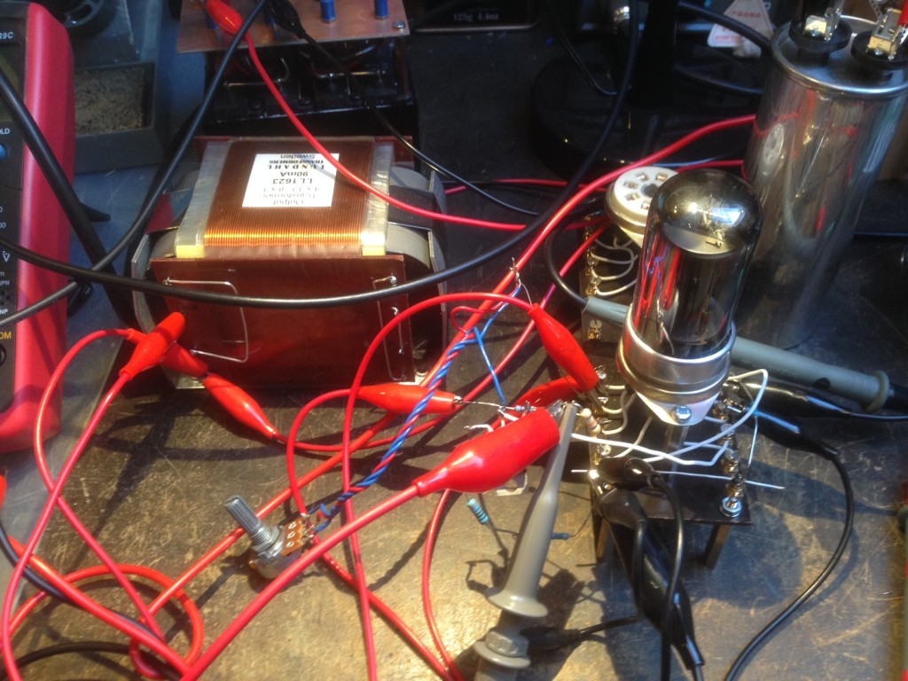

I couldn't resist the temptation and did a quick breadboard of the single-ended 1 x 4P1L circuit. Interesting results after increasing the screen voltage to 160V and dialling the feedback resistor with a potentiometer. 2W at 0.5% is not bad at all and very close as the simulation. I like the harmonic distribution. Lowest distortion is achieved closely to the point it turns back to pentode mode:

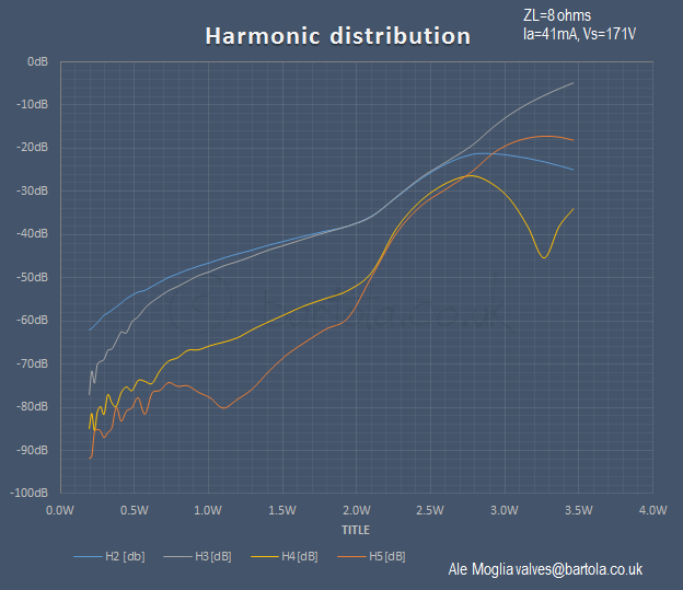

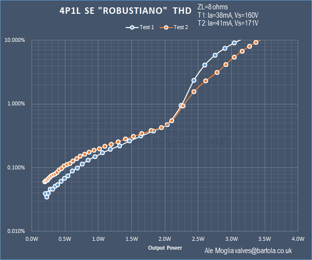

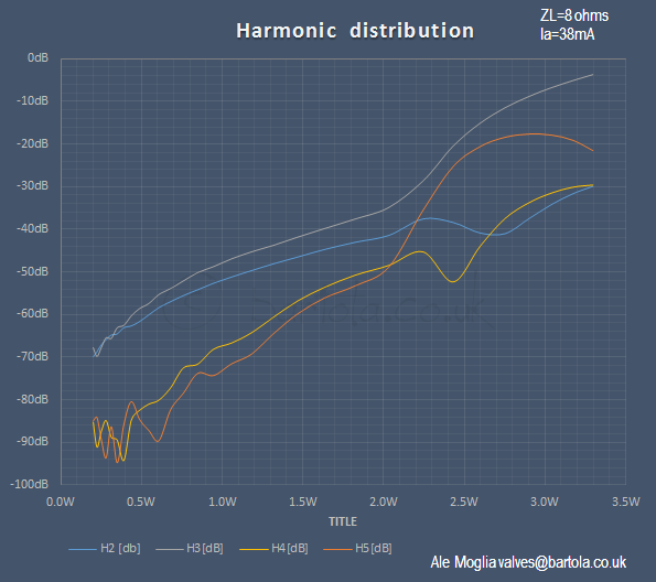

Here are some further tests using automated measurements. Firstly I tried same configuration running the 4P1L at closely 38mA and 160V screen voltage. Second test, I dialled up the screen voltage to 171V and tweaked feedback to get current up to 40mA
Interesting to see that the performance is more triode-like and has a higher THD at lower output levels, however at higher levels the THD is lower. Mainly dominated by H3 and significant rise of H5 given grid current I suspect:
Here is the harmonic distribution of the first test (more pentode like)
Here is the harmonic distribution of the second test (more triode like):

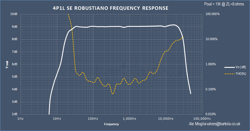

From a frequency response perspective, it performs very good with -3dB from 10Hz to up to 35kHz at 1W tested level:
What surprised me was to find out the increasing distortion at HF. Will this be due to the 4P1L grid capacitance or the DN2540?
Any ideas?
