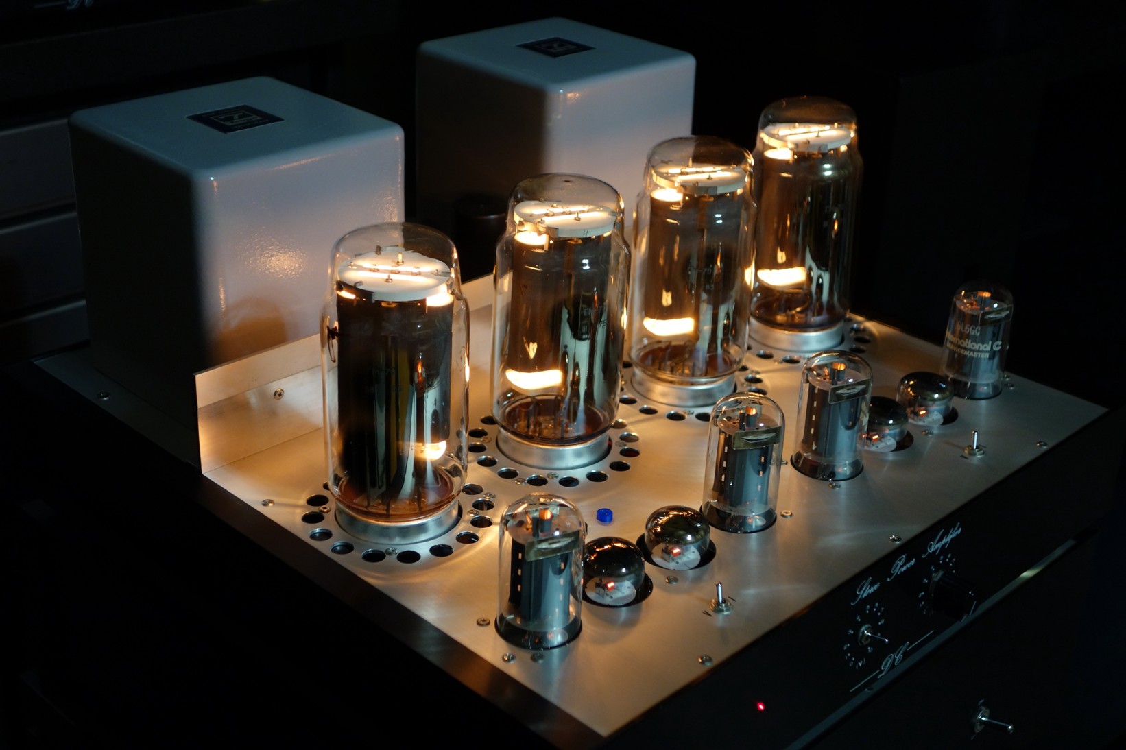

Can I ask what is the ideal load impedance for 4P1L Push pull Parallel?
In PSE I think its around 2.5k/8...DO I need to double it Ra-a = 5k?

I believe Ale measured the plate resistance as 1.6K, so a pair would be 800 ohms by that calculation. So go by the average 300b or 2a3. So 2.5K would be the lowest you'd want to go PSE, but you may want to choose 3K or 3.3K.
Double that for PP, like 5K to 6.6K

nice amp as usual from you. I have been thinking for some time to use the same operative conditions for the 4P1L's (i.e. 280V at 25-30 mA each) for a class AB2 amplifier. Ale can tell you this as well because he run some simulations.
In theory it is possible to get 25W into 8R from a parallel push-pull with 2.5K plate-to-plate impedance. The power increases to about 32W if the load from speakers drops to 4R (i.e. same secondary for 1.25K primary impedance). THD should be around 3% in both cases.
THD will be about 1% at 14W for the 8R load and at 10W for the 4R load. From this point distortion with 4R load will increase slower than 8R because of less grid current and 4P1L curves are more linear with lower plate load. This explains why max power output is higher for the same THD with lower plate-to-plate impedance.

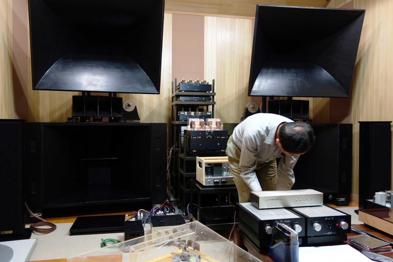

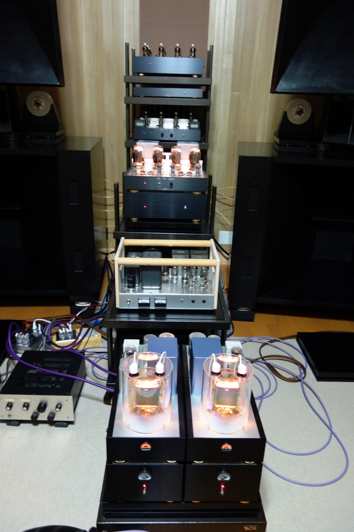

On last Sunday, we had an interesting get-together at my friend`s listening room for comparing three amps e.g. a)GM-70 PP(100W), b) 833C SE(70W) and c) mine: 4P1L PSE(10W). The SP system used was of 4Way all horn type and its efficiency was of over 100dB. We (five) had a feeling that there was not significant differences in between concerning to its sound performances, although there must have some personal preferences.
Thanks to the 100dB SP system, I was amazed of its performance with my 10W amp. I believe that it must be attributed to the power requirement for the SP system being sufficient with 0.5~1W, the THD of 4p1L amp is ca.0.76% at 1W and most of which were from H2. Therefore we had a good feeling as far as its sounding in general. As this 4P1L PSE amp is single stage, and no cancelation of H2 occurred with voltage amplifier stage.
