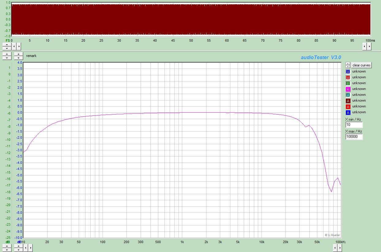

At what power was that taken?If someone is interested, Transcendar 5k:8 (10W) SE transmission curve (EMU0404 + 700R):
5k or higher is ofc super for those that can live with a watt or so in total. Strange discussions sometimes. The application matters.
This is only the transformer measurement (EMU0404 -1VRMS- +700R resistor as generator, 8R secondary loading).At what power was that taken?

This is the Transcendar (5k, 10W SE transformer) curve at 8W (C3g, powerdrive, 300B).

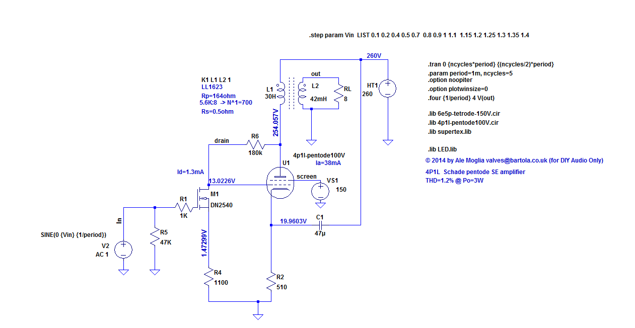

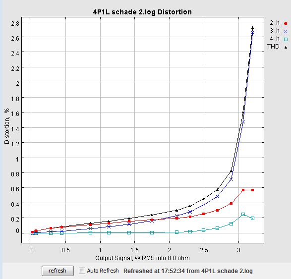

I know that Michael Koster tried this before with a 6L6 and liked the sound of it. Has anyone tried this on 4P1L? It looks like 3W can be extract from the 4P1L in pentode mode with an interesting harmonic profile. It may prove to be difficult to balance in real life given DC coupling.
Just a quick simulation and idea to see what ideas may spark 🙂
Cheers
Ale
Cheers
Ale
