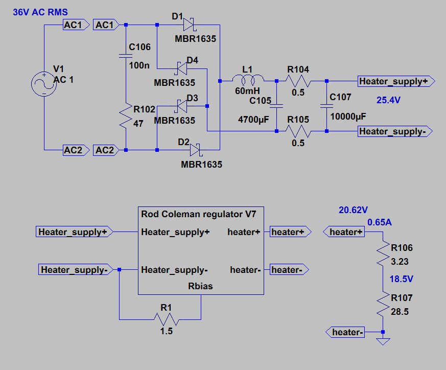

but next step will be choke input for that as well.
For choke input you must to use at least 36-38V AC transformer.
Yes - around that. It may be a bit less. I'll try 31v secondary first and see where I get with that - 25v and 6v in series. Then I can try 25v and 9v in series. When I have the right value I'll order from JMS. They do a good value 100VA transformer and you can specify the secondary.

I simulated a bit...with 36V AC you will on the border (old version R.C. regulators need at least 5V over output voltage).
Reichelt.de has 2*18V transformers (I use 100VA ones for 1-2A R.C. regulators).

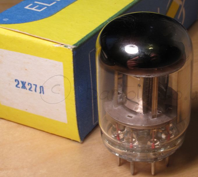

Nice looking tube indeed. Some more info from Ale
2Z27L triode | Bartola Valves
mu of 16, low heating current, interesting! Maybe with a gyrator load? Would have to use somewhat higher B+ to reduce distortion. I think the datasheet says max plate dissipation is 1W and 0.3W on G2??

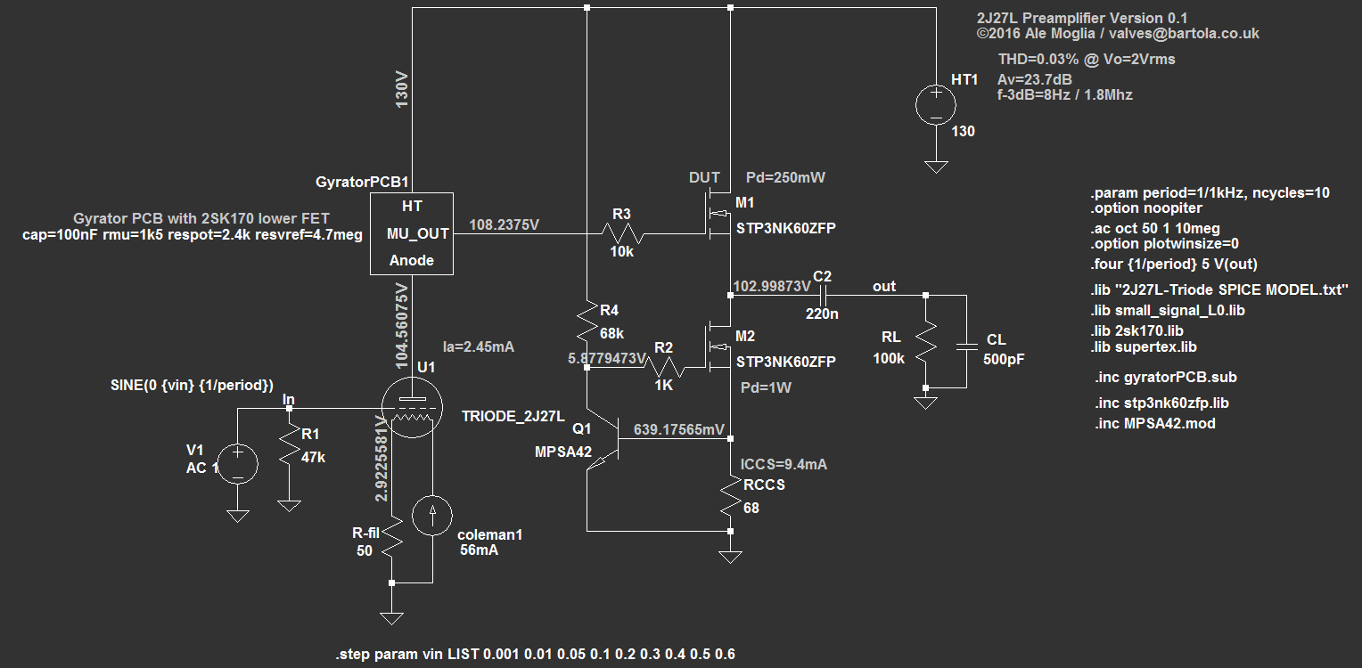

HI Erik,

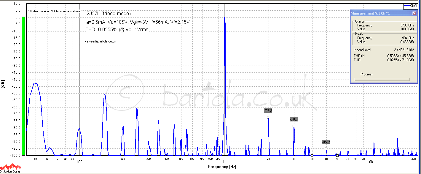

Yes, a beautiful candidate for a preamp when more gain is needed. I tested this back in 2012. This valve is not as linear as 01a/4P1L and others but will perform really well as preamp if a follower is added to avoid slew rate issues when driving challenging loads
Here is an idea for a nice DHT preamp. The simulation below correlates well with my measurements here

And you're probably right that it could be run hotter to improve distortion performance. I will build it as-is and listen to it. The use of the output follower is a must given the low current and anode resistance of this little fellow.
With 56mA filament demand I guess a set of batteries would work, but there is a hassle in re-charging them. Been there done that. Thomas Mayer implemented the 01a with filament current derived from the HT. This could be done with a DN2540 CCS to the HT but then the HT needs to be sized to manage +120mA and also a considerable heatsink for each CCS (6-7W of heat dissipation per channel)
just some thoughts...
http://www.klausmobile.narod.ru/td/data/_2j27l.GIF
