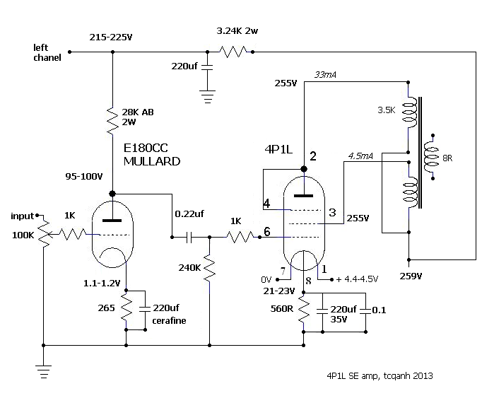

My 3.5K- 8 0hms OPT has separate winding for G2 (say G2 winding). There are some options:
1. G2,3 connect to anode.
2. G2,3 to G2 winding.
3. G2 to G2 winding, G3 to anode.
4. G2 to G2 winding, G3 to cathode.
Which is better ?

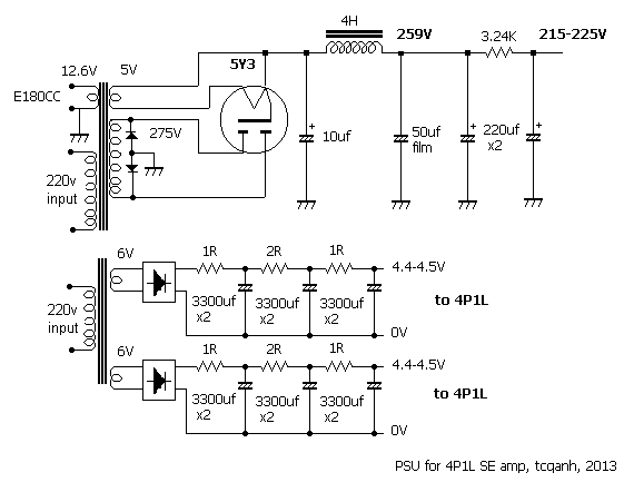

I did choose plan 3 for my amp: 5Y3 rectified tube, Mullard E180CC driver runs 95V 4.5mA, Svetlana 4P1L (date 6x) runs 235Vak 37.5mA with auto bias. Sound is wonderful. It beats many penthode tube SE amps that I've built before, like 30P1s, El84, 6V6, 6L6GB... even El34, 6550.

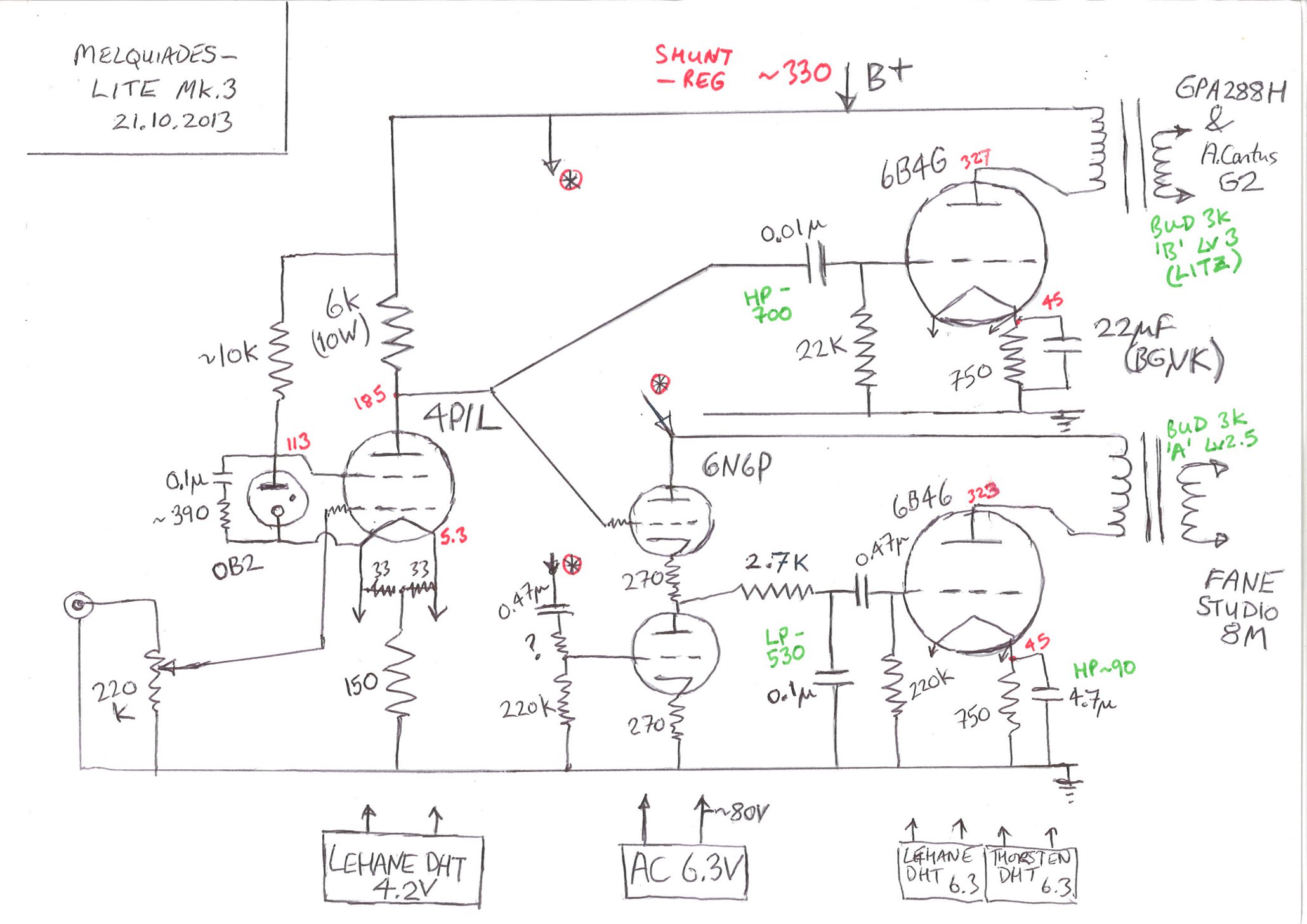

There is the other option of using 4P1L in pentode as a driver , which I have mentioned before, and found to be extremely successful both with 6B4G and 300B .
For an example of the set-up, see circuit attached - just finished building this one for our meeting in Yorkshire last week . This happens to be a two-channel amp to drive two horn drivers , with internal crossovers, but the set-up and principle of the 4P1L driver is there - just build the upper 6B4G channel with a more suitable coupling cap and grid-leak .
This driver retains the 'direct-heated' sound, but achieves more gain without going to three stages or the inevitable low-end time constant of an SE interstage .
Gain on this driver as shown is about 22 , rising to around 32 if you use a cathode by-pass cap .

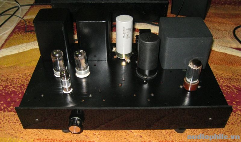

Here is my favorite amp, very simple, easy to build, quite cheap, output ~ 3W, deadly quiet with noise 0.6-0.8mV. Sound is so sweet and It beats my 300B on midrange 🙂
Could you clarify the impedences on the primary of the output transformer? Is it
3.5k on each primary or 1.75k adding up to 3.5k? I haven't seen separate coils
used to achieve what looks to be an ultralinear setup. Very interesting,

These opt are diy product from a friend. Plate and g2 winding are the same turns and have same 3.5K impedance. I guess it operates like something between triode and ultralinear, so I can get more power than one in triode.
Interesting. It looks like one winding of the primary is simply acting as a feedback loop.
Feedback? Its a normal 50 percent between pentode and triode to me. Ultra linear concept. Evolve plz
Edit. I see now, its on G2. Sorry. Yes please?
If two windings were in series and its center point were connected to G2 it could be UL, but they are in parallel.
