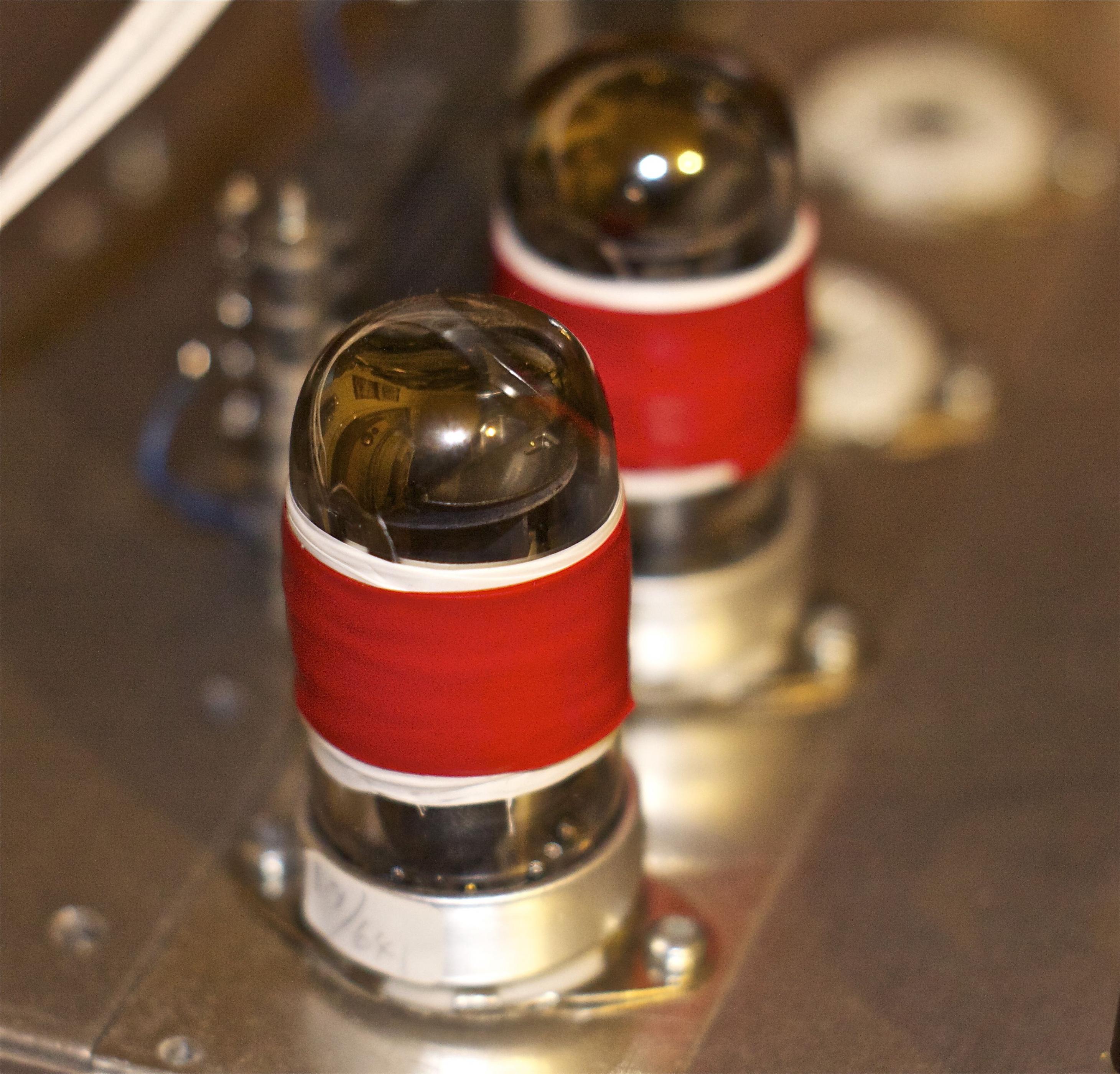

You aren't having microphonic problems on the input? I had to abandon the 4P1L as an input, way too microphonic in my amp.
I'm not having microphonic problems, not in the driver stage with 4P1L. I wrap the tubes in plumbers teflon tape and secure it with insulating tape. My chassis are all solid 4mm aluminium, plus I run the filaments at 600mA. Between all this it works fine. With 2v in it's pretty secure. When I was using it to amplify 0.5v it was more of a problem, so for that I was using a 26 preamp. Right now, though, I don't need that extra stage.
