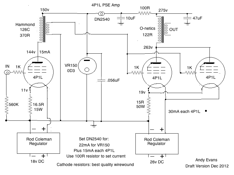

Peter - I am sure you are thinking that a 300b output stage will be the best. Everyone does. But this would be wrong. I built several 300b SETs and I can tell you that you will get better sound out of a PSE 4P1L output stage in filament bias. I'm re-posting my amp and preamp schematics. If you build these pretty much exactly as shown you will be very surprised at what you hear. The filament bias - no cathode bypass caps, small resistor - is what makes the sound ultra transparent. And this in itself is enough to make it a better choice than a 300b with large resistor and cathode bypass. Add to that the 4P1L is a very fine sounding tube in its own right, and you will see what I mean. I'm converting all my 300b SETs to PSE 4P1L. It's fairly easy to do this - two 4P1L in parallel have 1.3A current and are biased at 2x35mA = 70mA. You do need 28vDC for the filament supply to Rod's regulators, one for each pair of 4P1L, but that's not difficult.

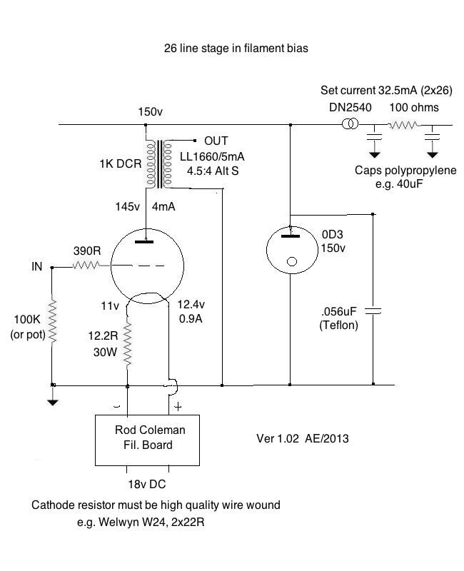

I only use DHTs so that's all I'd recommend - 26 into 4P1L, both in filament bias. Same transformers as in my schematics, but you would need to run the driver stage with more volts on the plate and probably more like 20-30mA through it. You could use the Hammond 126B. Haven't tried that - just the 126C. So in filament bias you'd be looking at more like a 24vDC supply to Rod's regs. Say 25mA, -15v, 200v p-k. You could use a couple of 105v glow tubes.

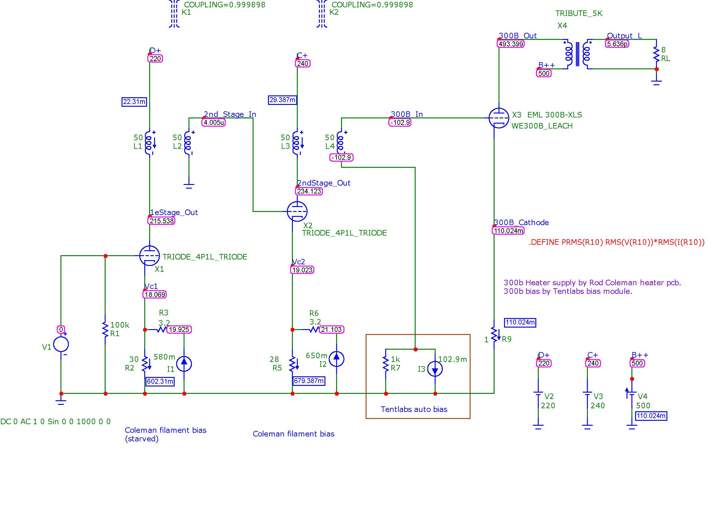

I also want to go for all DHT, I like how 2x 4P1L simulates and a quick test with 6J5-4P1L-300B sounded promising.
With the 4P1L-IS-4P1L-IS 18W would require 3.85Vpp at the input, driver clipping starts at 5.6Vpp (1.98Vrms)

26 is much better sounding than 6J5, especially in filament bias. 4P1L is microphonic for an input tube.
Primary Impedance of the O-Netics

Can you tell me the primary impedance of the O-Netics output transformer for your 4P1L amp.

Rp of 26 is much higher than Rp of 4P1L which requires interstage with higher inductance.
Maximum anode voltage of 26 is 100VDC lower than 4P1L, planning on using 2x Salas SSHV2 with LC-> split LC, not practical with 100VDC difference between 1st & 2nd tube.

The O-netics are 3.3K.
The 4P1L can be used as an input tube, though recently I've preferred 26 partly because I have 2 stages of 4P1L after it. When I used it I put several layers of plumbers teflon tape round the bottle, with insulating tape round the final layer. I also have massive chassis in 4mm aluminium. Even so it was just under control and always on the verge of whining. Never had any problem as a driver tube. I also run the filaments in parallel at 1.9v. You should really be looking at some sort of rubber isolation as well as a massive chassis.
The 26 is robust and I wouldn't say you need several to get a working one - all mine have been pretty OK with few exceptions. Yes, you do need 150H of inductance or more if you can. That's why I use the LL1660/4mA. It works for me in 4.5:4 but you can use more step-down if you don't need the gain.

The 26 as input starts clipping at about 1.8Vrms input in the simulation is that about right in real life? It does not really matter as max power of the amp will be reached at about 1.3Vrms with 1:1 interstage.
