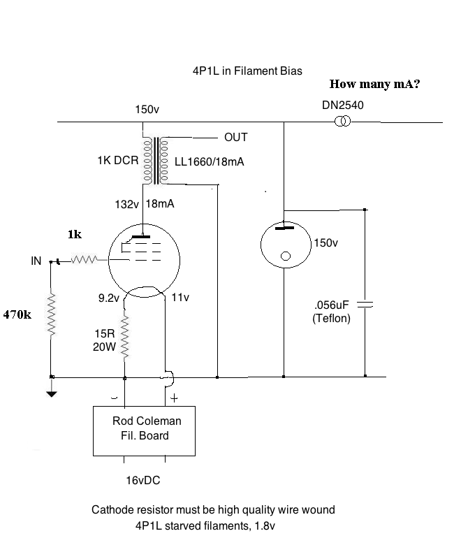

Could I use 3 resistor of 47R like these https://es.rs-online.com/web/p/resistencias-fijas-de-orificio-pasante/1995937/ in parallel as cathode resistor?
How many mA have I to set the CCS?
Those resistors should give you around 15R at 36W. Close enough for jazz.
If you are using glow tubes, it's useful to read the instructions for using them.
http://www.mif.pg.gda.pl/homepages/frank/sheets/141/g/GL874.pdf
You will see that for the octal glow tubes they need 22.5mA and the 7 pin ones need 17.5v. Subtract the minimum current from the maximum current and divide by two. Then add that to the minimum current. So for 0D3 max is 40mA, min is 5mA. Difference = 35mA. Half of that is 17.5V. Add that to the minimum 5v and you have 22.5v. For the 7 pins the max voltage is 30v, so current you need is 17.5mA. That is true of all glow tubes of these types.
So what you then do is add the current through the glow tube to the current through the tube(s) you are using. For 2 x 4P1L at 36mA, add 22.5v and you set the DN2540 for 58.5mA.

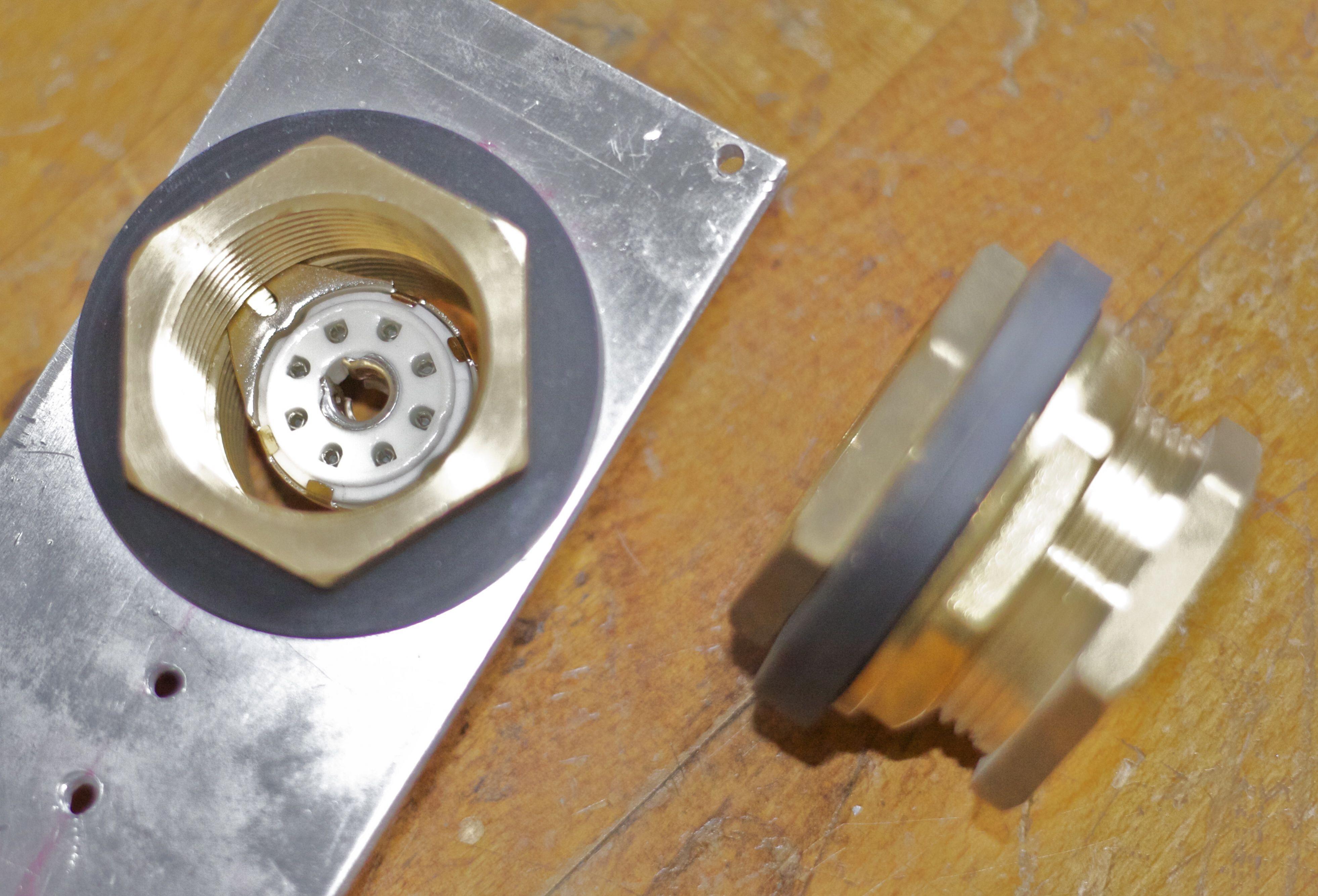

For a 4P1L preamp you need to do something about microphonics. Here's my latest idea using 1.5" plumbing parts. The brass parts don't touch the top plate - the rubber washers come in between, top and bottom. The tube socket is held between the two screwed pipes. I haven't tried it yet - should work! It's pretty heavy.....
Andy
Andy
Clever idea! I gave up on the 4P1L in preamp or input mode, just couldn't beat the microphonics. Let us know how this works out.
