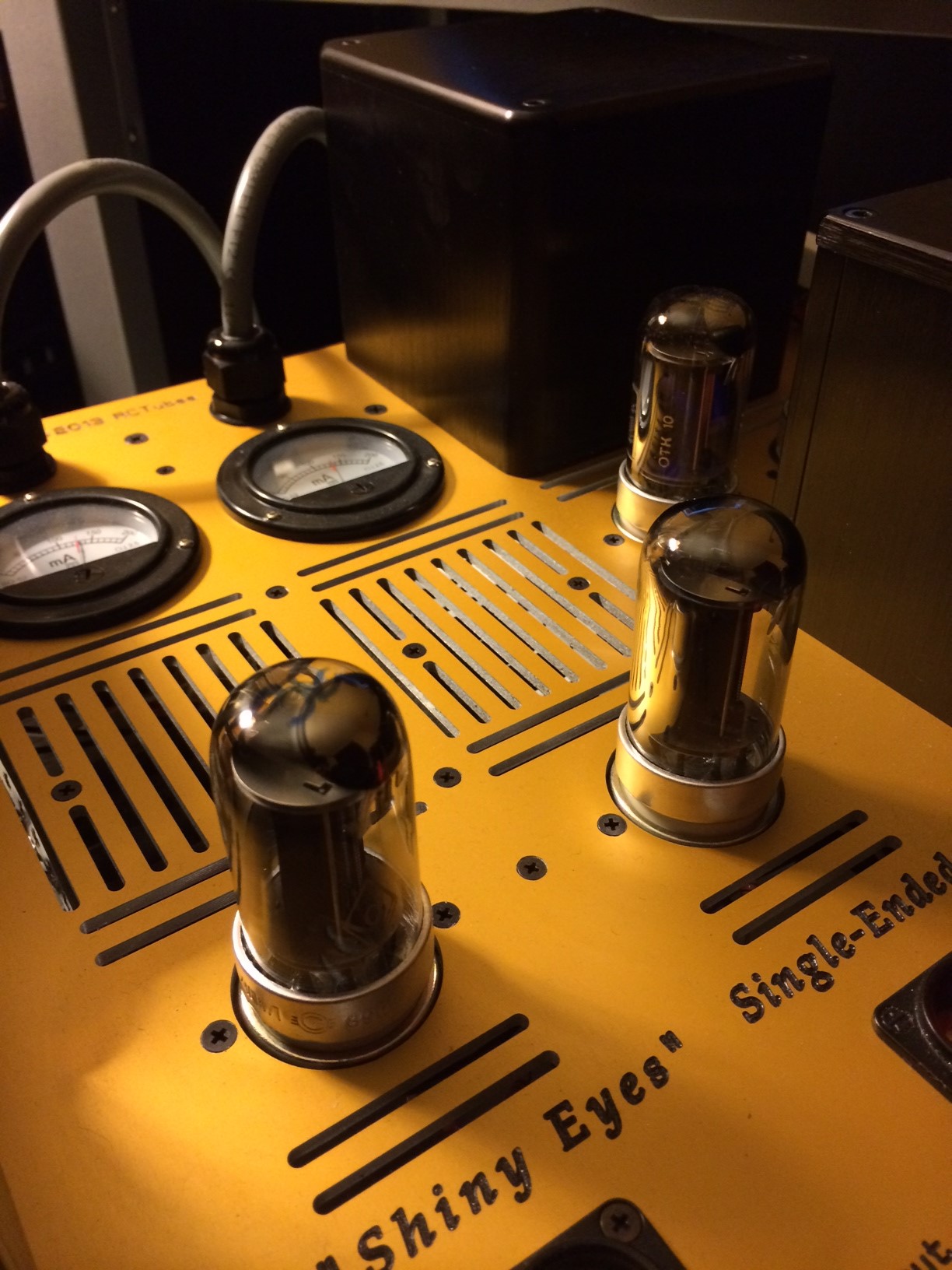

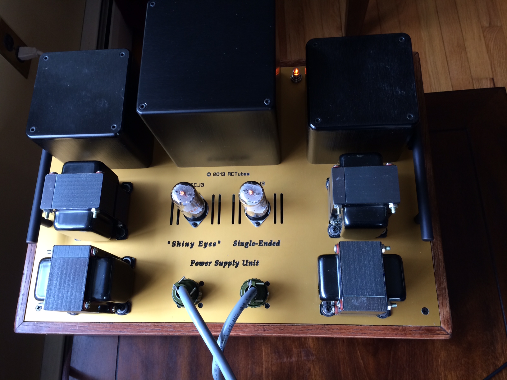

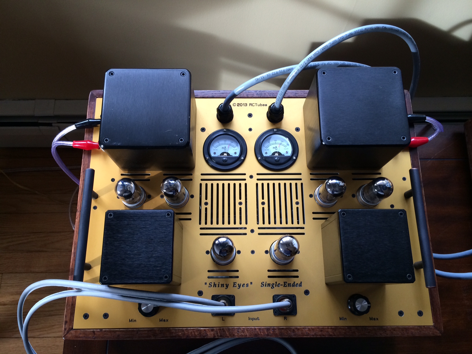

Andy,
I will post few details and pictures of my second amp in the series named "Shiny Eyes" ( first is a parallel push-pull with 4P1L that I posted in http://www.diyaudio.com/forums/tube...dahl-zero-global-feedback.html?highlight=4p1l )
For more details you can visit my blog at simplepleasuretubeamps | Thermionic Tubes and Sound Revelations .
Here is a short description: driver 4P1L @ 154V/36mA/-8.5V filament bias starved at 560mA loaded on a LL1692A Alt"T" 2:3.5, final stage PSE 4P1L @254V/36mA/-21V filament bias at nominal 1300mA, loaded on a LL1664/70mA/3k:8. Rod Coleman filament regulators (agree with you that are well designed, not very expensive and ready to use). I built it using two identical oak enclosures with anodized 3mm aluminum top plates from ProtoPanel ( very good quality and price, they usualy have sales at 40% off). Power supply is a monster at over 50 lbs, using separate transformers for main ht, final's filaments and driver's filament, a total of 5. Rectifier tubes are 6CJ3 and filtration is CLCLC with all 8H/150mA Hammond chokes and most of the caps are Epcos polypropylene in oil. I used a 104dB headphones and could not hear any hum. I recently built a pair of small reflex speakers (I have an extra enclosure for whoever is interested in the US, too heavy for international) using MarkAudio's Alpair 12P full range drivers that am using to listen to my amp. Sound is amazing and you know it.
