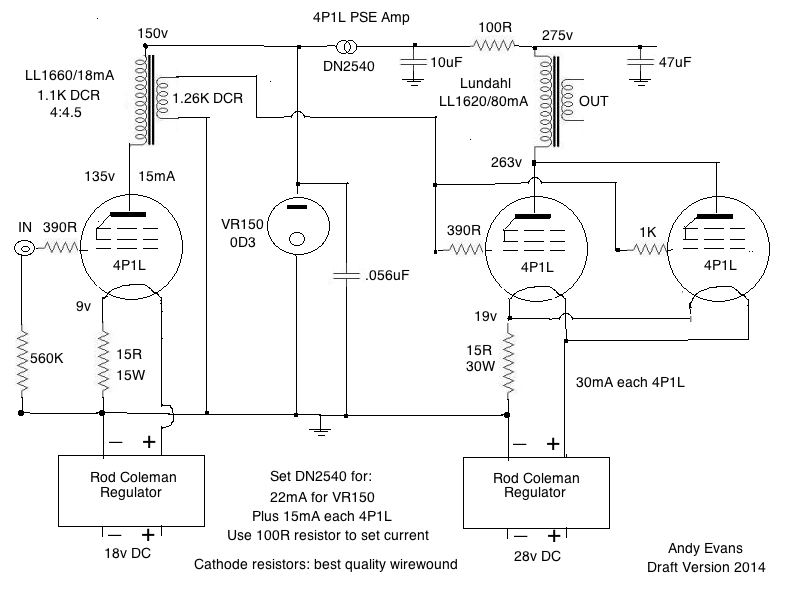

Yes, that's what I was thinking. Isn't it an indirect way of tying the screen to the anode? Not feedback at all, since it's in parallel.
I dont know about the interior of a 4P1L but is G3 internally connected to cathode or not? Local feed back ist taking parts of the output compensating the input (g1). Well UL is a form of that, it takes part of the output compensating not on G1 but on g2
But what have we here? If the windings are identical, is it virtually the same as connecting that point to the plate?
Here we have signal on g1, power on anode. G1 transforms to an enhanced inverted signal on anode device which is OPT. OPT is divided in two 50/50 windings who recieves signals from both anode and G2 simuntaniously. Very special form of UL.
DC voltage at G2 and A are different, due to Ia > Ig2. Datasheet reads 35mA to 6,5mA respectively. As for AC condition my understanding is: IL2pri is a function of Ug1 and Ua and, I guess mostly, current induced due by L1 winding.

Plate and G2 have the same phase in OPT.

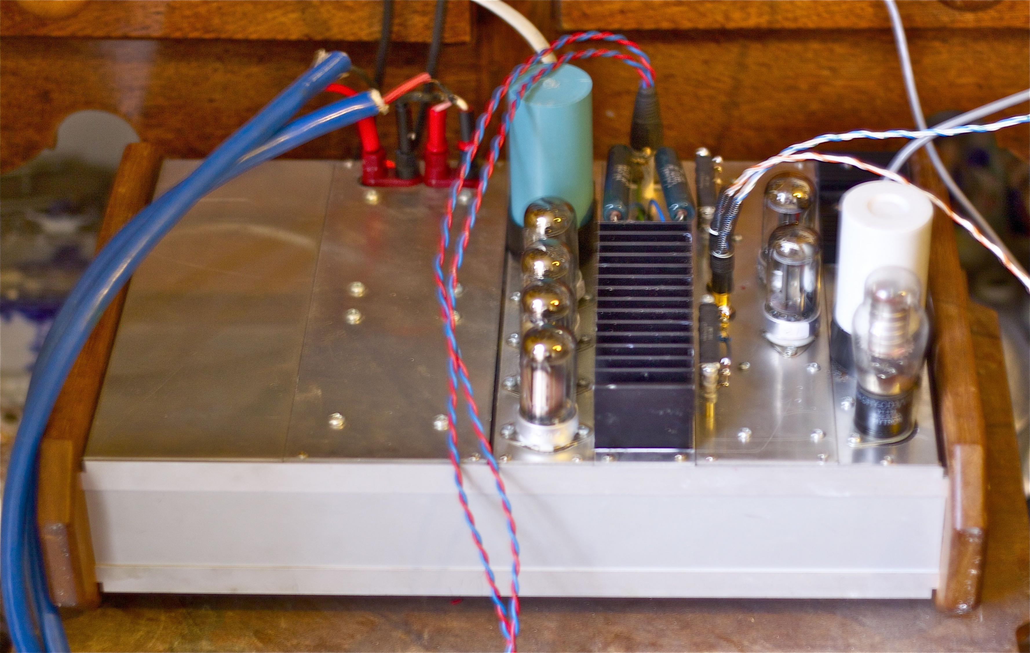

Update on my 4P1L PSE. Here's a couple of pictures. The PSU and filament supplies are in separate chassis. I've been using this now for over a year, and no desire to use anything else. I've never been so happy with an amp build. I can't think of a better design for this power output - slightly more than a 2a3 SET. I attribute a lot of the success to using both stages in filament bias - no coupling caps and no cathode bypasses. Cathode resistors are 15 ohms for each stage. You can see the heatsinks and large wirewound cathode resistors which you need for filament bias.
What I have upgraded is the transformers. The interstage was Hammond 126C which is good, but the LL1660/18mA is better. The OPT was Audio Note Trans-152, then the cheapest O-netics, and now the Lundahl LL1620/80mA which is the best. I'm interested in upgrading the OPTs. Maybe Hashimoto H203S which is rated 7 watts. Or whatever. But the Lundahl is dynamic, detailed and has good bass, so pretty happy overall.
I urge anyone with time to spare to build this - it's better than all the 300b and 2a3 amps I ever built. And no more expensive 300b or 45 or 2a3 tubes - what a welcome relief!

The tubes are cheap - you risk nothing by building one. You'll need filament boards from Rod Coleman, but they are very good value as well. Don't economise on the cathode resistors, like aluminium clad or ceramic. You need the best wirewounds like the porcelain ones in the photo or the Dale surplus stock ones in the input. Heatsink sizes as shown.
Minor edit to the schematic - grid stoppers are all 390 ohms (not 1K). No particular reason for the value - just what I had. You can experiment. With 2v in from my DAC this drives simple full-range speakers like the Mark Audio Alpair 10s I use. That's in a small/medium room. No need for a preamp. The mu of the 4P1L is around 11 - makes a difference in the output stage over the usual suspects.
Don't be tempted by anything other than filament bias in both stages - it's crucial to the sound quality! If you can use a choke in the supply so much the better. Hammond 159ZA for one 4P1L and 159ZC for a pair in parallel. Your chassis needs to be solid - particularly the top plate - since the 4P1L can be microphonic. Not an issue in the output and never bothered me in the input, but I do have a very solid chassis. It helps to run the input tubes at 1.9v (parallel filaments) and you can also wrap layers of teflon plumbers tape around the bottle and finish with some insulating tape to hold it on. I've done that and it works fine.

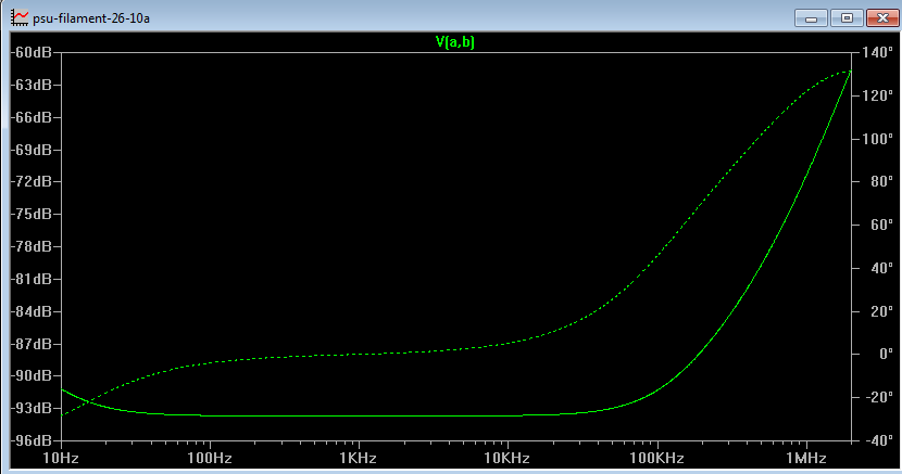

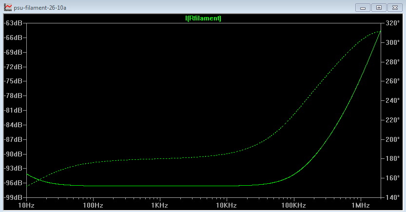

That day belongs to 2011 🙂 I already posted a diy version that has the same or better performance. I used Rod's initial idea, a cap multiplier (or gyrator) in front of the filament, a CCS after the filament (credit to Rod for the idea), and created a circuit up to the performance I wanted. You need to know what you're doing to adjust some of the circuit's resistor values to set the current. This is not a copy of Rod's commercial circuit, which has never been published, as far as I know.
P.S. Rod's initial circuit that I started with can be found here http://www.diyaudio.com/forums/tubes-valves/38248-new-dht-heater-7.html#post2024952
