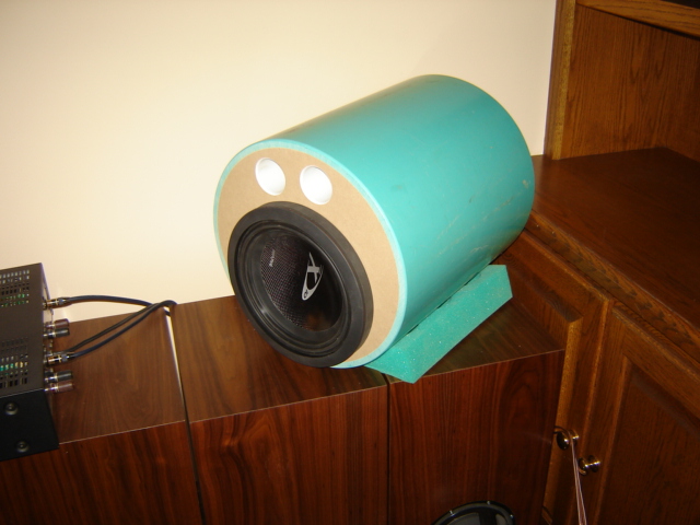

Was your PVC perfectly round? Mine was not close to round, so there was no way I was going to get my baffle fit inside the tube. I had to overcut for the outside and use a router to trim flush.
Greg
Greg
Greg,
It's pretty "round" only had to push one side in a bit to get the front/back in. [disks were router cut].
Once the back piece was installed, loaded it with spay 90 glue and poured in quartz sand (that stuff is very nice, if you find find some). I repeated that a few times, until there was a good thick layer. Any thing like that will require a good long drying time; week or so.
This box never sounded like a pipe (or boomy). Of course this is a good project for someone that doesn't have a lot of room to work in. I did make a small wood stand for it, after this pic.

The green PVC box needed something, maybe bigger port(s). I'm sure the port sizes in the box are from Perfect Box and/or copied the tuning from the factory designed box (pic on #33)
Just to throw an idea out there
, might be kinda fun to cut a smaller pipe and add an exoskeleton port.
Still have the 1000 watt woofer and 5' green pipe - think I need a powerful amp to get it going.

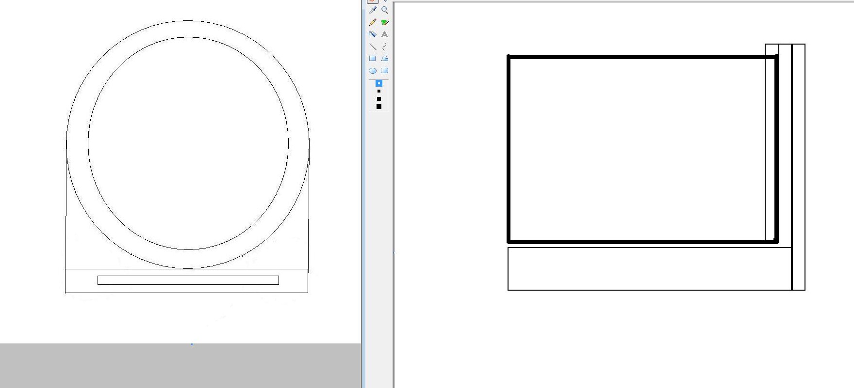

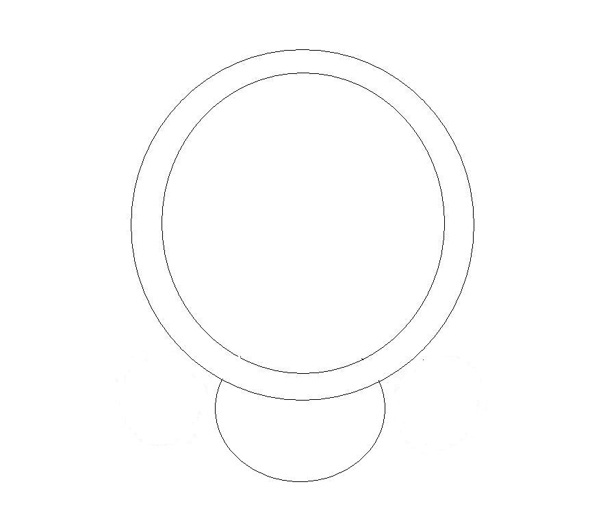

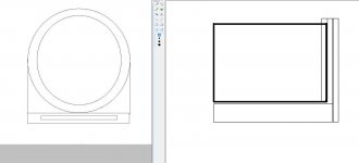

So here's an idea that wouldn't be hard to build; using a round PVC as the box and the same port as in the square box (12.5" x 12.5" x 11").
Could router cut rings that fit on the outside of the PVC, a few should do. From there, make up a square base and connect the two with a full size back plate... The heavy line is the PVC pipe.
*Woofer for the example: SWX-1042D
