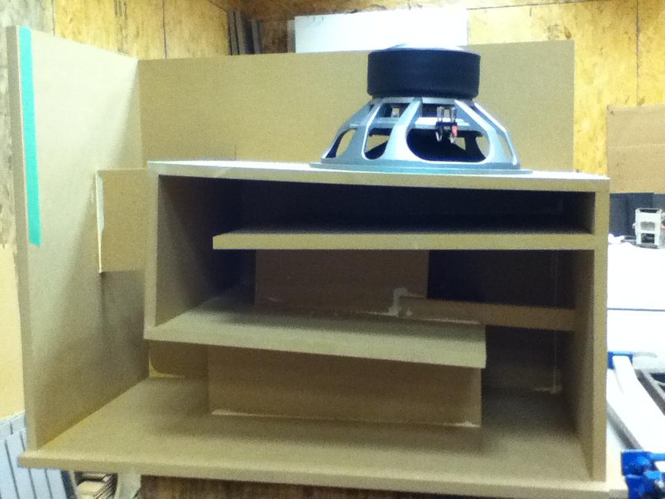

Well no on 37hz,I decided to order 2 B&C Speakers 18PZB100 B & C SUPER 18" 1400W WOOFER got them right at $550.00 for 2 with shipping,So they should fit anything they get put in ,
I have the box 24"x24" x 30" with the peavey low rider in it ,Their is 2 4" round ports on the side at the rear(I can add more holes or slot it ),I am considering putting 4" tubes inside 10"long and test it,then add another side to direct the ports forward,What do you think?

I checked the tuning, it's about 37hz.
Is that your goal?

What could I do to lower them to maybe around 25 hz or so ?I checked the tuning, it's about 37hz.
Is that your goal?

For movies I prefer much more extension than you can reasonably get from a TH without compromising SQ. That being said if all you need is 30Hz extension with efficiency and more than average output a TH is a fine but not small choice.

Here's the "plan" so far the 12" kickers like low hz,so they will get a sonatube in the 15 to 50 hz,30hz to around 150,the TH,then Dr200 and maybe some super tweeters, comments,Ideas are welcomed,

Do you have any data on the Xmech for the 18PZB100? The manufacturer lists Xmax=Xvar=8mm.
