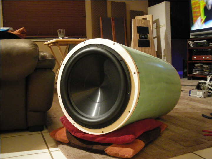

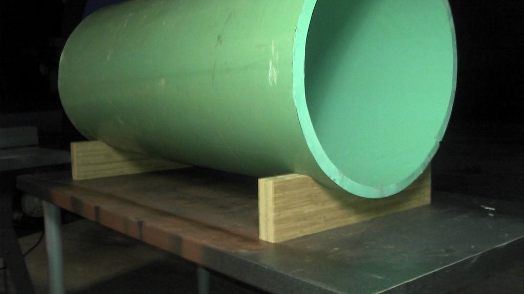

I used heavy duty PVC pipe. About 3/4" thick and very heavy.
They look fantastic ! My only question is, what's the largest size they are available in ? (diameter wise, i mean)
Mine is schedule 80. See this chart:
PVC and CPVC Pipes - Schedule 40 & 80
My piece was not perfectly round, so to make end caps, you will want to oversize them and then go around with a flush cut router bit and the out-of-round won't really matter. If you get really luck, you might be able to find just the right diameter and screw the driver directly to the tube.

Believe it or not, did that with 5.25" in a 6" PCV pipe a long time ago...bolted them up high in a van - torpedo looking things, with a outside vent pipe (used a 90)
Yes tuned with the exterior pipe, 1.5"
