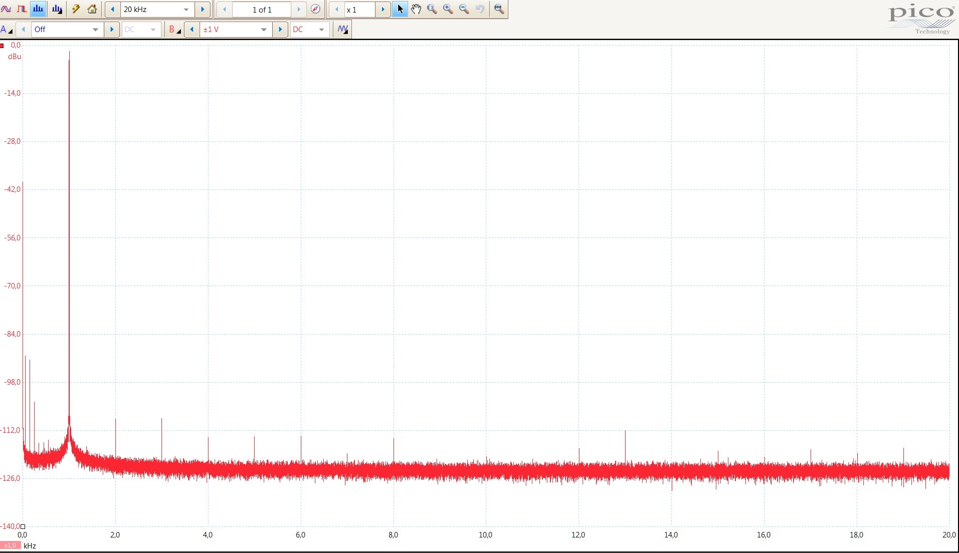

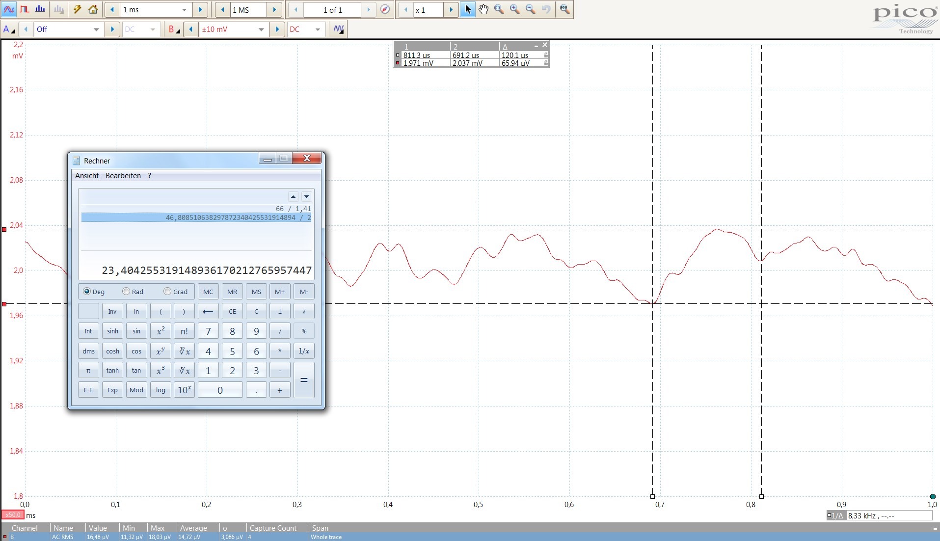

more plots, if anyone wants to have fun and compute SNR more precisely.
From 1ms waveform I selected a zone with ca. 5-8KHz noise: the RMS there is ca. 23uV.
Not exactly good for 25mV follower role, but surely absolutely impressive for a 0dBu (+14dB margin) Line Buffer + Headphone derivation in the format of 1-BJT real estate.
Many Thanks to LV and Marcel!

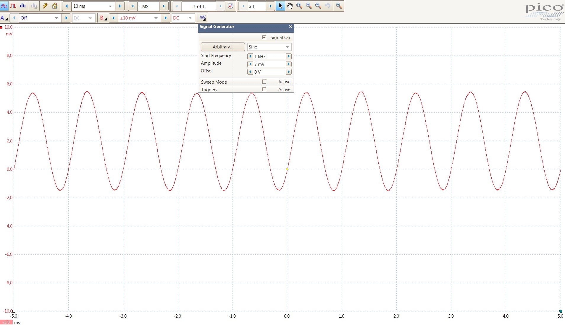

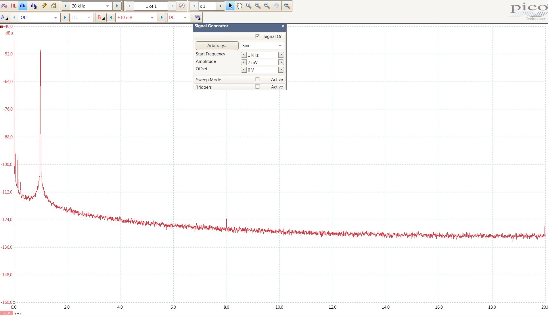

RemeasureClean_LM317T_ShortedInput_Time_100ms_ALP200KHz_DLP20KHz.jpg225.6 KB · Views: 46
RemeasureClean_LM317T_ShortedInput_Time_1ms_ALP200KHz_DLP20KHz.jpg255.1 KB · Views: 54

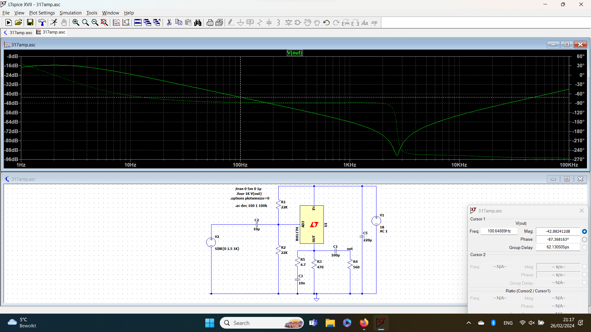

Regarding the PSRR, I didn't measure anything, and this is the simulated result:
Rather underwhelming, but it is mainly caused by R1, injecting a signal into C2. R1 should be split and bypassed if you need a good PSRR. I'll measure the actual PSRR tomorrow
The PSRR will need a filter on the bias. ie split R1 into two resistors and filter capacitor. Or, you could use a bipolar power supply.one more question: what is the PSRR of this circuit?

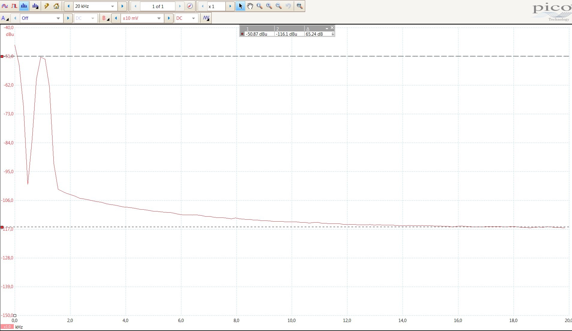

After 1h of working ('warming up') the waveform's noise rms in 20KHz has reduced to 7uV average and 10.9uV peak (in 3sec). Longer than this I cannot do, as the DC shifts and nulls the measurement. Pretty cool.

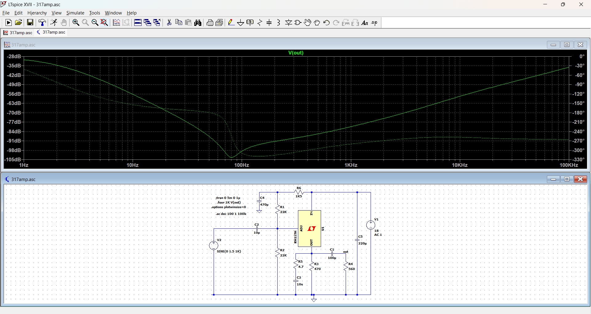

I have measured the PSRR in reality (on the ST sample, but I don't think it matters much).
I have left the bias on the regular 18V supply, and connected the test amplifier to the 317 only. The signal was 4Vpp riding on 18V.
At 100Hz, the PSRR was 86.6dB and at 1kHz 88dB.
These figures are quite good, probably better than those from the datasheet.
I have left the bias out, because it can be filtered as much as one wants, like this for example:

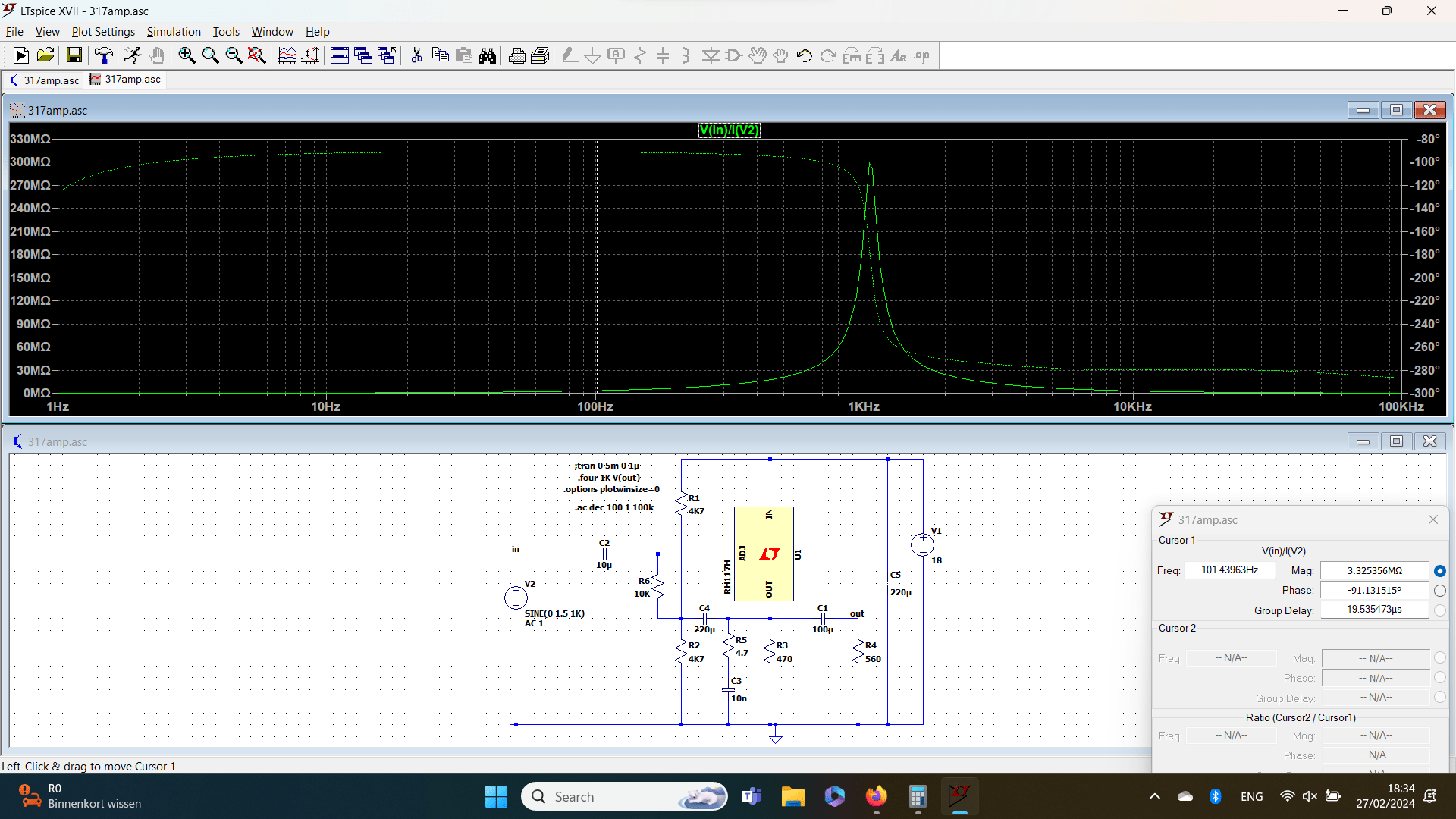

This is the bootstrapped version, to increase the input impedance:
It brings the impedance to ~3 megohm, except at 1 kHz where it rises to 300M, due an unfortunate choice of values in the example.

One question, the resonances which are apparent (100Hz for PSRR, 1KHz for Z_in): how they come about?
Are they specific to 317? Or to 317+circuit values? Or common collector topology ? I don't know (yet) how to simulate your results at my end, but will these resonances exist also with BJT?
Care to share the LTSpice project, to save some good chunck of my time?
I do resonances all day, by profession, and I learned generally to try to avoid any unnecessary ones. Especially when I need a large bandwidth solution.
