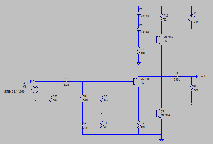

One BJT line amp/buffer
The bootstrapped version probably comes with Prio 3-4, at the end.
I'll keep in mind to reserve a few nodes and sufficient real estate if at all possible.
No intention to try the high input Z before clarifying how to deal with aerial 50Hz and the neon lamps, WiFi, Bluetooth, 3G/5G etc.

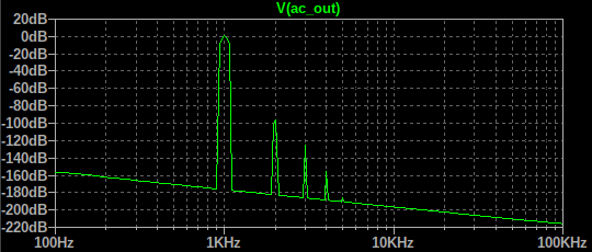

I have tested the bootstrapped version, and it behaves exactly like in the sim: the input impedance is raised to several megohms, with a huge increase at ~1kHz (probably not 300 meg, but very high).
The circuit remains well-behaved in all conditions, including open-input, and the frequency response and distortion remain unaffected.
The circuit of post #116 should have a 12.35 kohm impedance minimum at 0.3228687 Hz, if I calculated it correctly. Admittedly, that is very far in the subsonic region.
Is there any reason not to just stay simple and effective with BJT's?
Distortion is 0.0015% and is a common and reliable circuit (y)

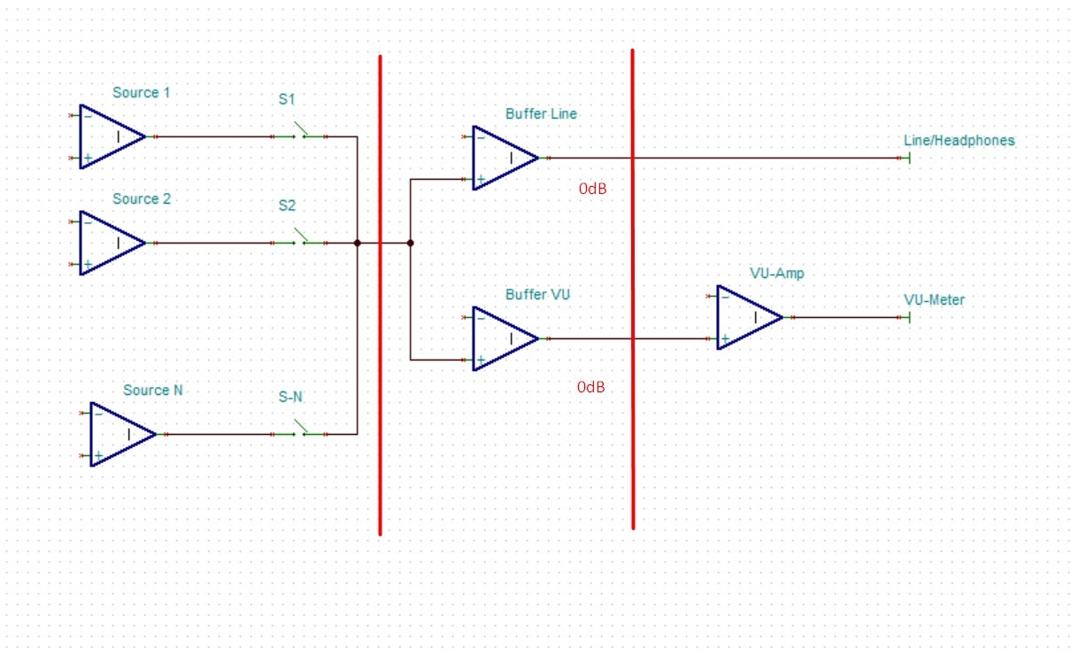

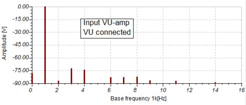

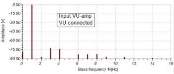

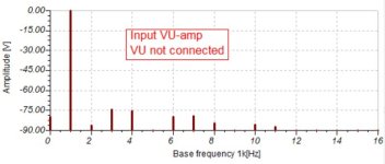

Plan is the following.
Ideally the VU-amp is to be connected at 'Buffer Line' output (so, have one single Buffer). If VU-amp does not make the Line-Out dirty (reverse isolation >90dB).
If not possible, then I need a second buffer, for VU derivation.

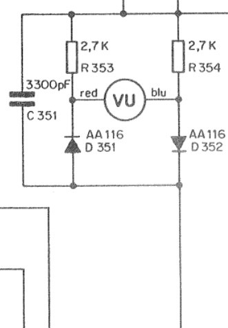

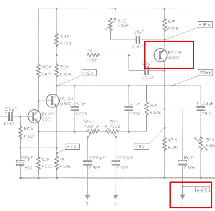

In particular, I copy the VU-amp from Revox A77 (Recamp card):
- theory & praxis tells, that if they could put it there, directly in the heart of the REC Preamp/EQ (no buffer involved), then it should have no back-feeding into the EQ node.
So, I should be able to connect the VU-amp input to the LineOut buffer.

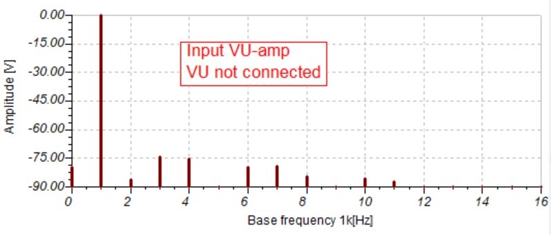

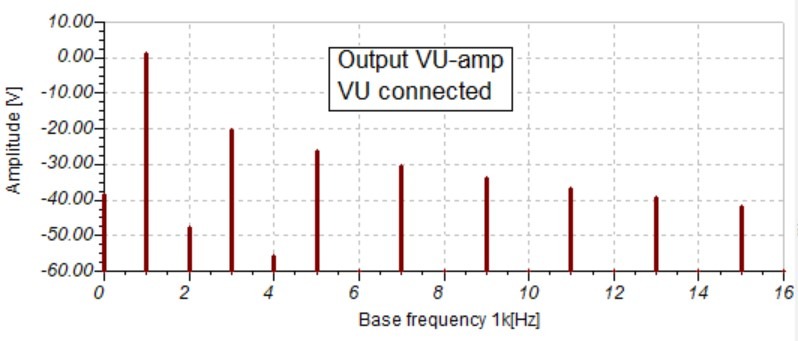

Momentarily this does not happen: I am testing without buffer, simply after Selector switch. VU-meter works fine and is correctly calibrated, but I observe quite an impact at the VU-Amp input (back isolation poor). Indicates that it will impact the signal Line Out, making it dirty.
As written at beginning of this thread, I suspect this is an effect impedance mismatch effects. I need to put buffers (find&allocate 1-BJT footprints for each of them).
On the other hand, I do not see why Revox implementation is innocent but mine is wrong. Of course I do not like to waste a second buffer only for VU.

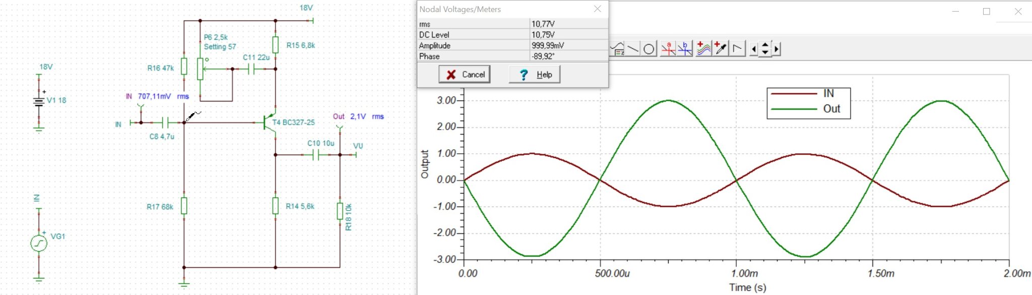

what I can note:
  • I did not use R507 (1KOhm)
  • also C508 (180pF) not used
  • the P504 (500Ohm) simulates good with 1.2KOhm value, but in reality the best VU-calibration I could obtain was with 0 Ohm (short).
Having R507, C508 and P504 (non zero position) implemented, the reverse isolation is still equally poor.
I suspect that in reality the source impedance is not zero as in the simulations... ? Could this explain the case?
I also measure(!) that source output is still correct 0dB but Vu-amp input is like -20dB. I t should be a direct connection, but apparently is not.
