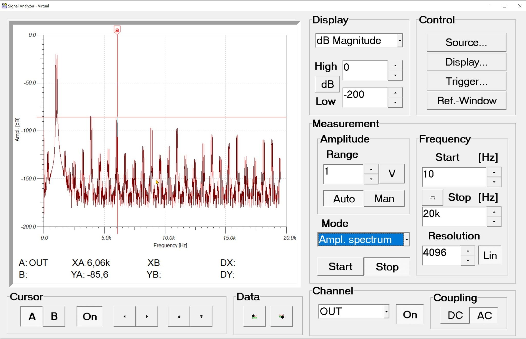

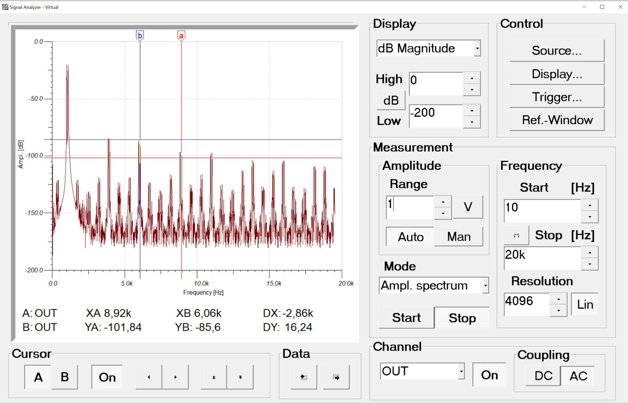

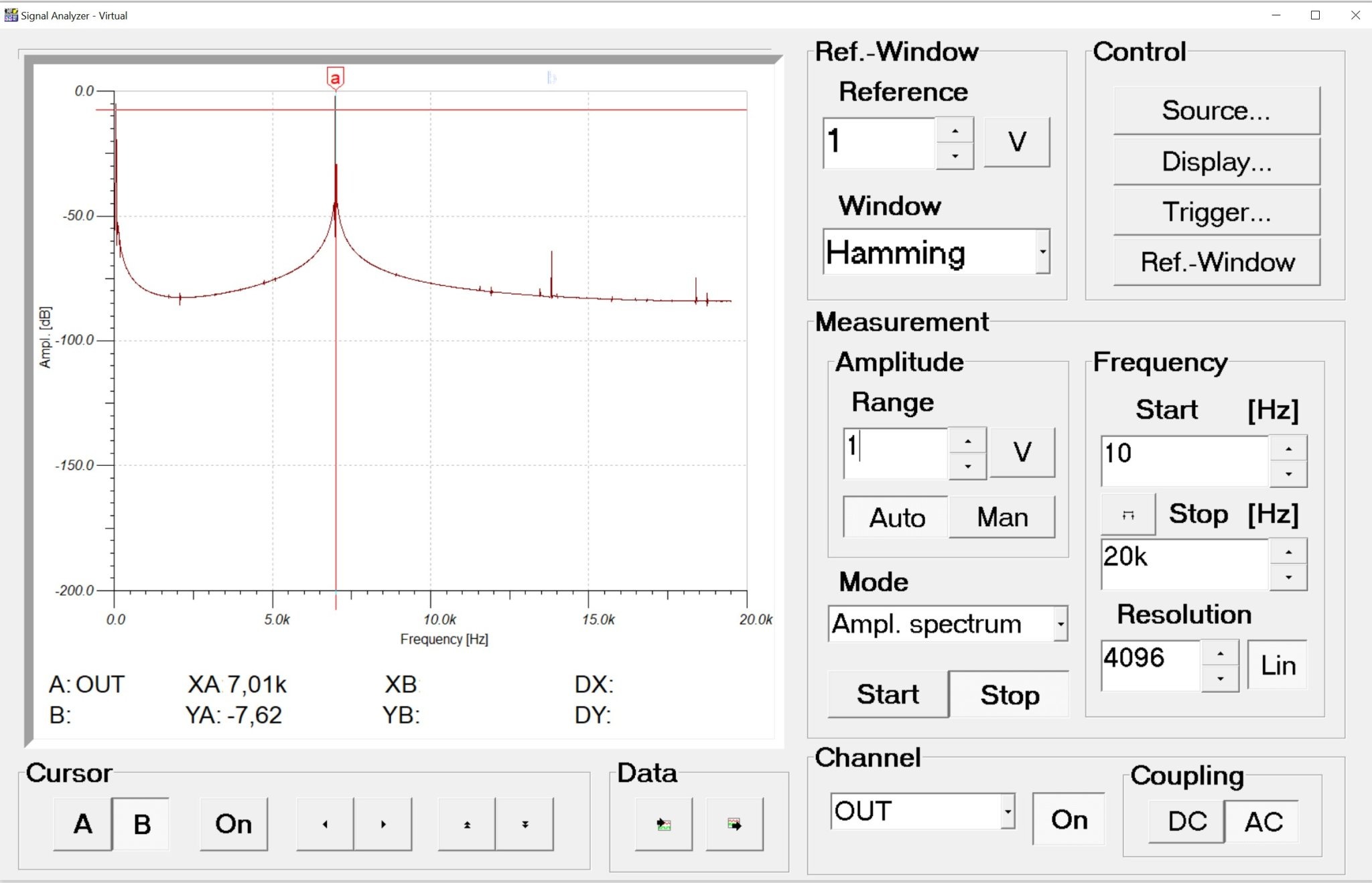

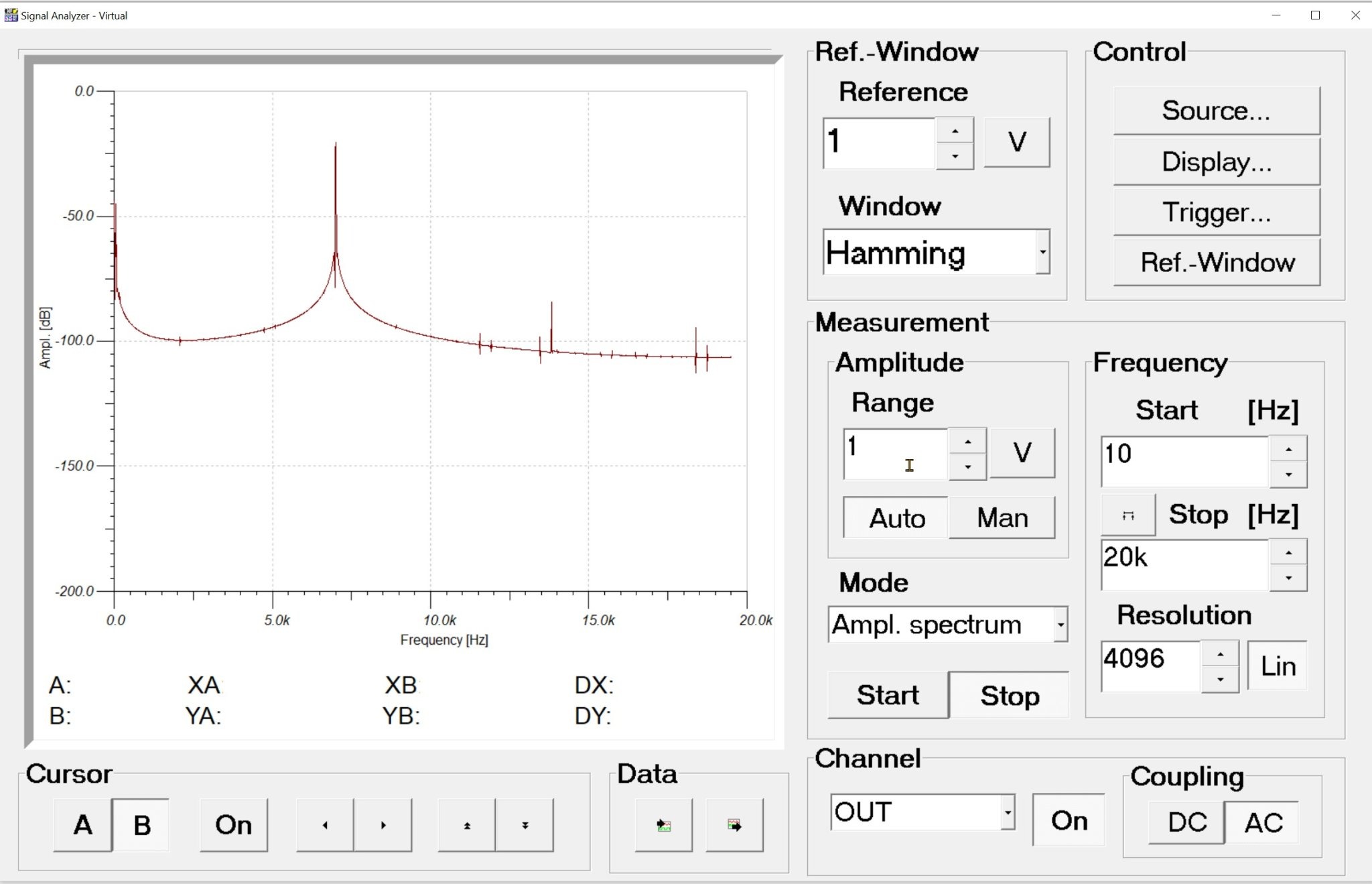

I have simulated with TinaTi its proprietary transient model for 317, and results were close to the LT-Spice proprietary model of 117, but more realistic at -102dB for 1Vp input at 1KHz.
In measurements I could measure -96dB H2 for same conditions. The H3, simulated at ca. -136dB it cannot be measured, as displayed noise floor was -111dB for this level. Still, ok-ish. If VU-amp and headphone derivations are connected, the H2 level increases marginally, only to -95dB, and noise floor average(!) drops from -113dB to -111dB (measured with BW20KHz divided in 4096Pts, and with LP@200KHz)
If input level is decreased to -10dB or -20dB then the harmonics get smaller than the noise. I checked the values also for other frequencies, like 2K, 4K, 6K, 10K and 14K, and it passed with same performance. So, the listening test should require that voicing signals will stay below -5 or even -10dB level (0dB is 0dBu). Barely a limitation.

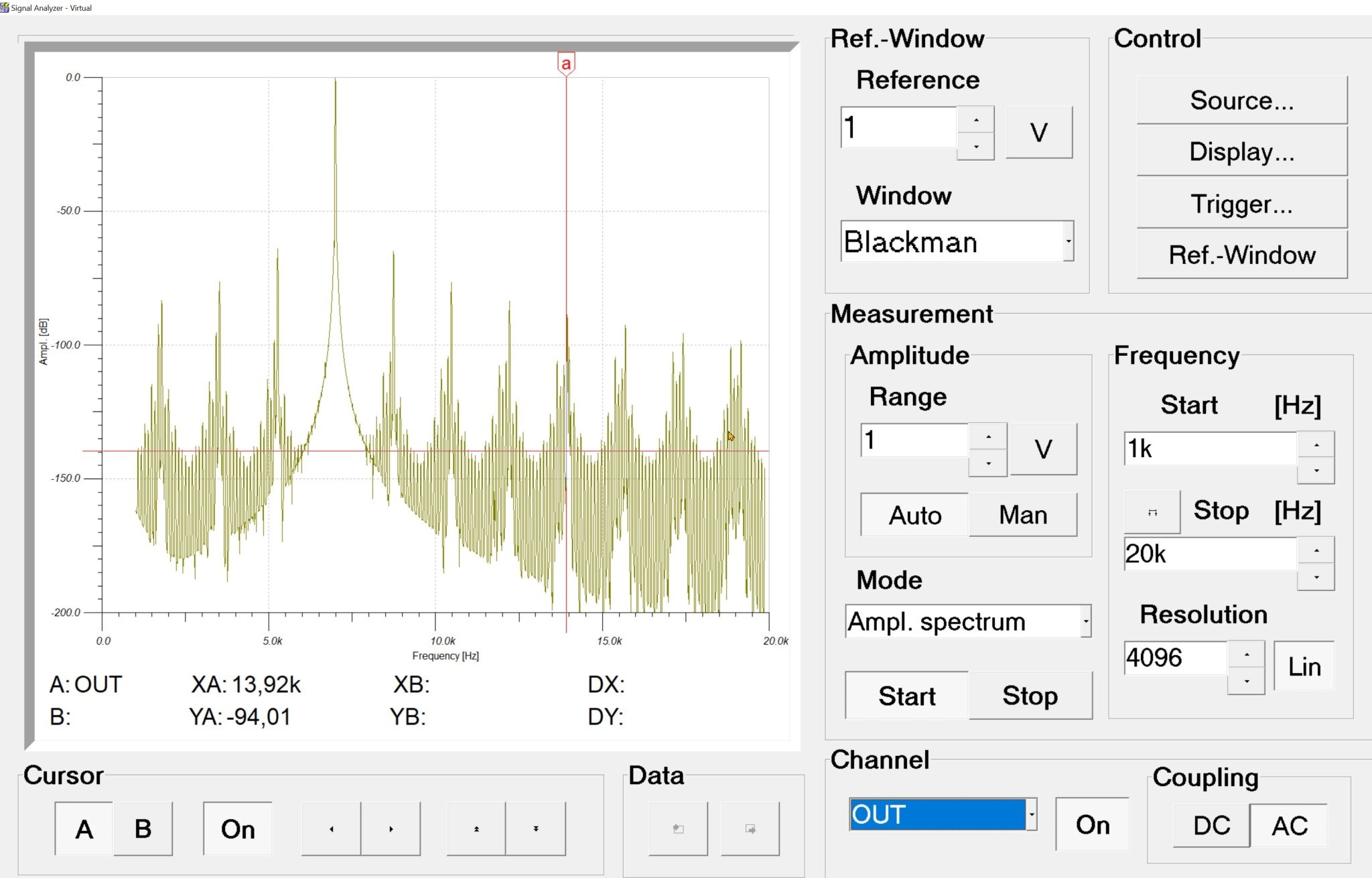

The SNR and THD being promisingly low, I tried to simulated the IMDs. This is the last concern about 317 performance.
Unfortunately the standard 10:1 ratio of 7K+60Hz IMD method show a beating of 1KHz which I cannot interpret.
I will try to measure it.
If this measurement is passed, the listening test cannot be skipped.

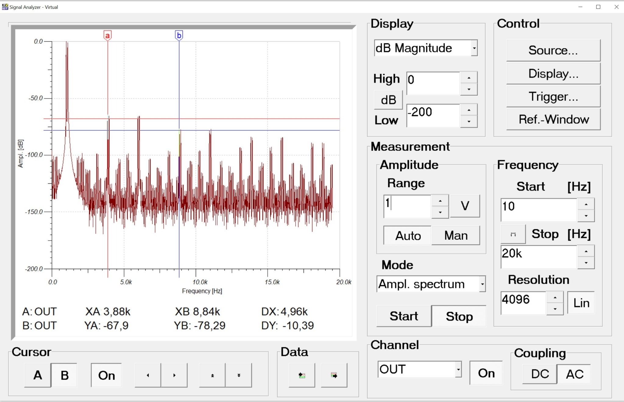

I cannot do measurements so fast, but I will post more 'simulation IMDs'.
Any idea if this will sound acceptable as usual, or terrible?

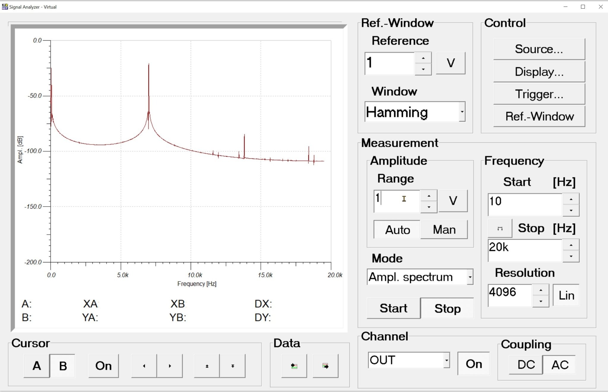

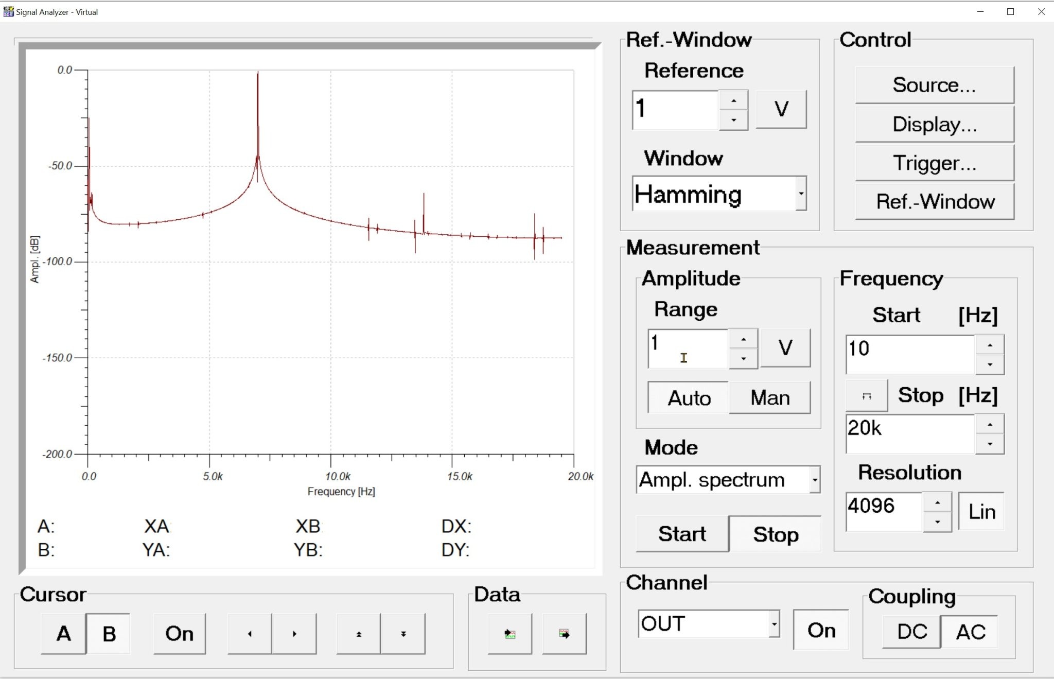

The simulation results with 317 today are on the edge, with -50 to -60dB products. If these products would come by THD alone, I know that I can easily hear this level for pure tones. Except that the IMD products are more similar to H3, hence more towards high pitch and metallic.
funny thing which must be mentioned, I simulated IMDs for all versions which I have today (1 BJT-CC, 1BJT-EC, 317 plus the original 3xBJT line amp):
  • the winner by -68dB is the 317
  • the second place is shared by the original circuit with 3xBJT, the 1x BC547 in CC topology (emitter follower) and the 1x BC327 in CE topology (the VU-amp from Revox): with -65dB.
Thanks LV and Marcel to bring me in this point!
My conclusion is, that I should not bother with A/B/C tests. Just the 317 one and verify that I did not do any trivial building mistake.
Of course, I am open to see&study any other examples where the IMDs are significantly smaller, for example better or much better than -80dB. If possible, -96dB or more. For reference we can use 1:1 (0dBu output) 1100/1000Hz tones. We can use the 60/7000Hz method as well, no problem.

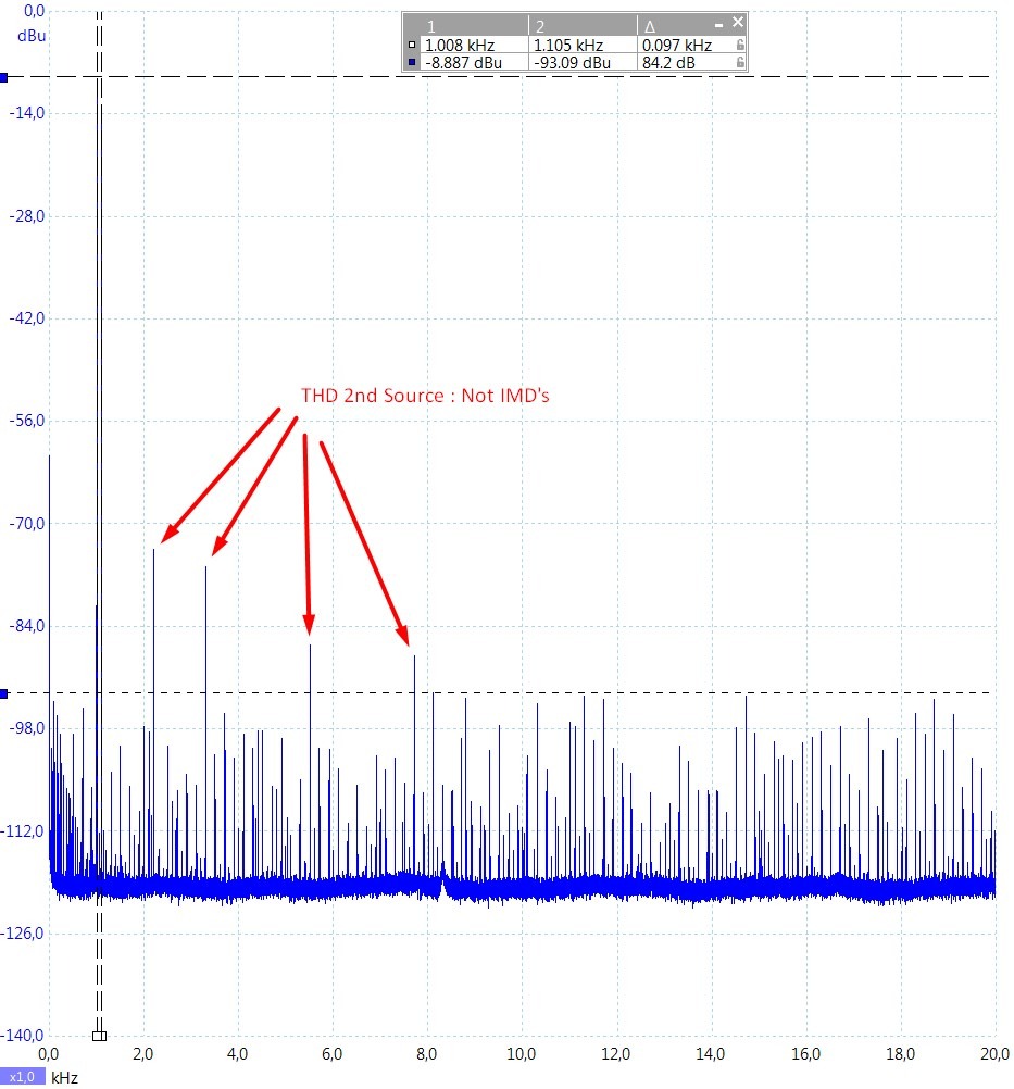

correction of simulation results: the measurements show IMDs are better than -90dB, probably -93dB (close to the theoretical CD quality).
My setup is limiting, as second source is not as good as the first one and I record too many harmonics below 100dB. I don't know for sure which one is what.
I think that for this application the 317 is excellent.
Sorry I have'n bother to test the others. Probably they are equally good.
