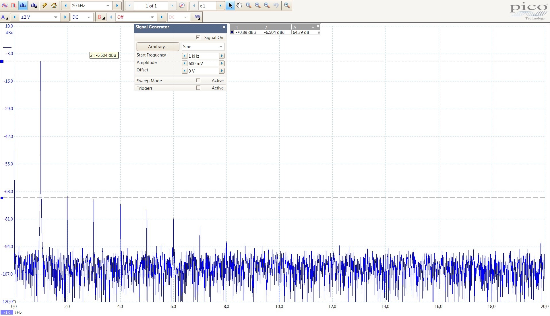

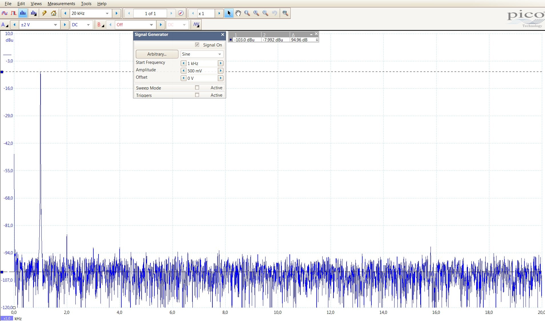

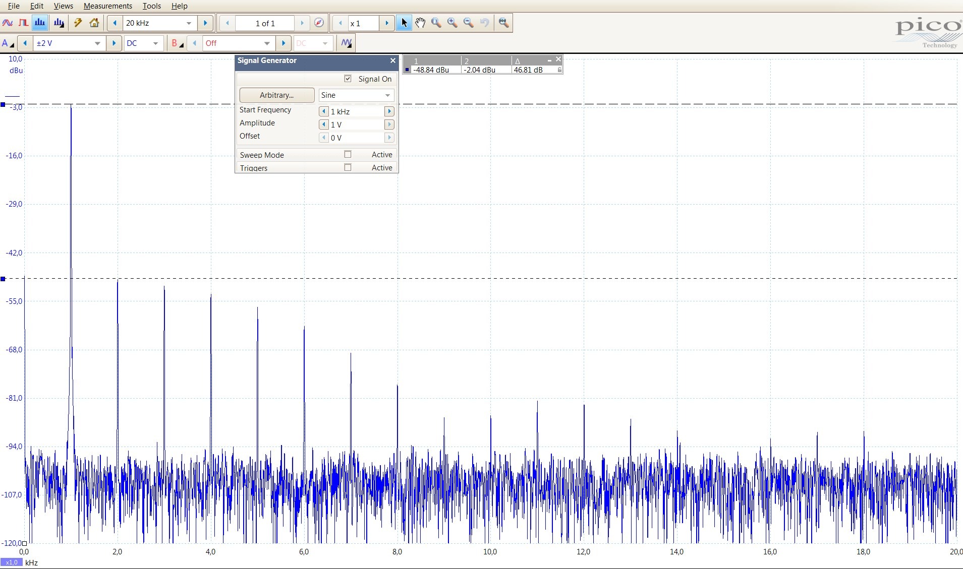

The noise and THD results are below.
Descriptions are in titles.
Setup is identical as schematic above. Nothing was changed.
Maybe I have done something wrong, or it is still something wrong with the HF behaviour of the circuit, as the circuit is distortion "free" only up to 500mVp.
Beyond this input amplitude, the harmonics rise up immediately and stay constant at around -45dBc to -50dBc.
I will appreciate your check and feedback.
I need SNR and THD up to 3Vp range, at minimum (best would be 5-6Vp) to function well in its Line Amp role.
P.S. I will remove now the 560Ohm load and replace it with something like 5K or 10K. Maybe the load (simulation of the Headphones, which is not the focus) is the problem.

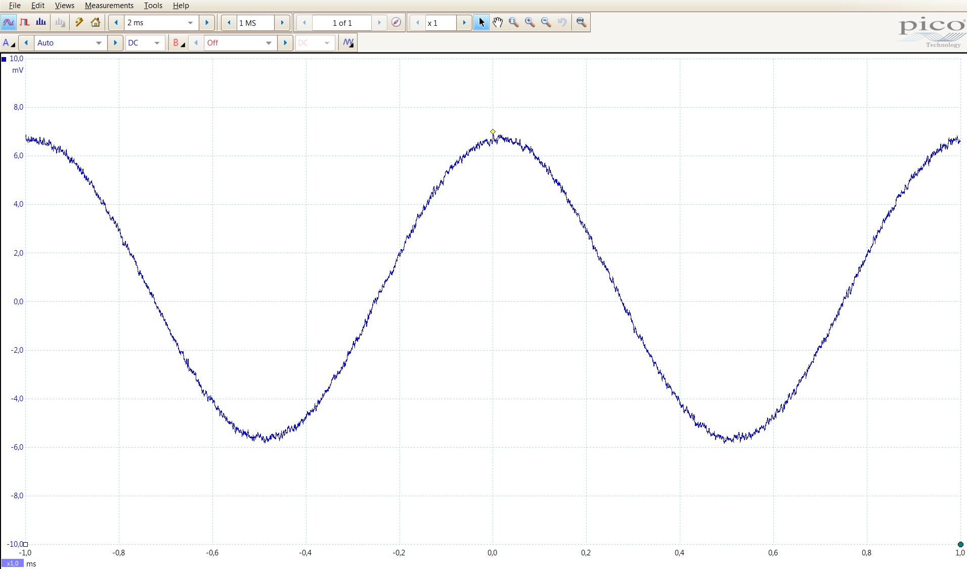

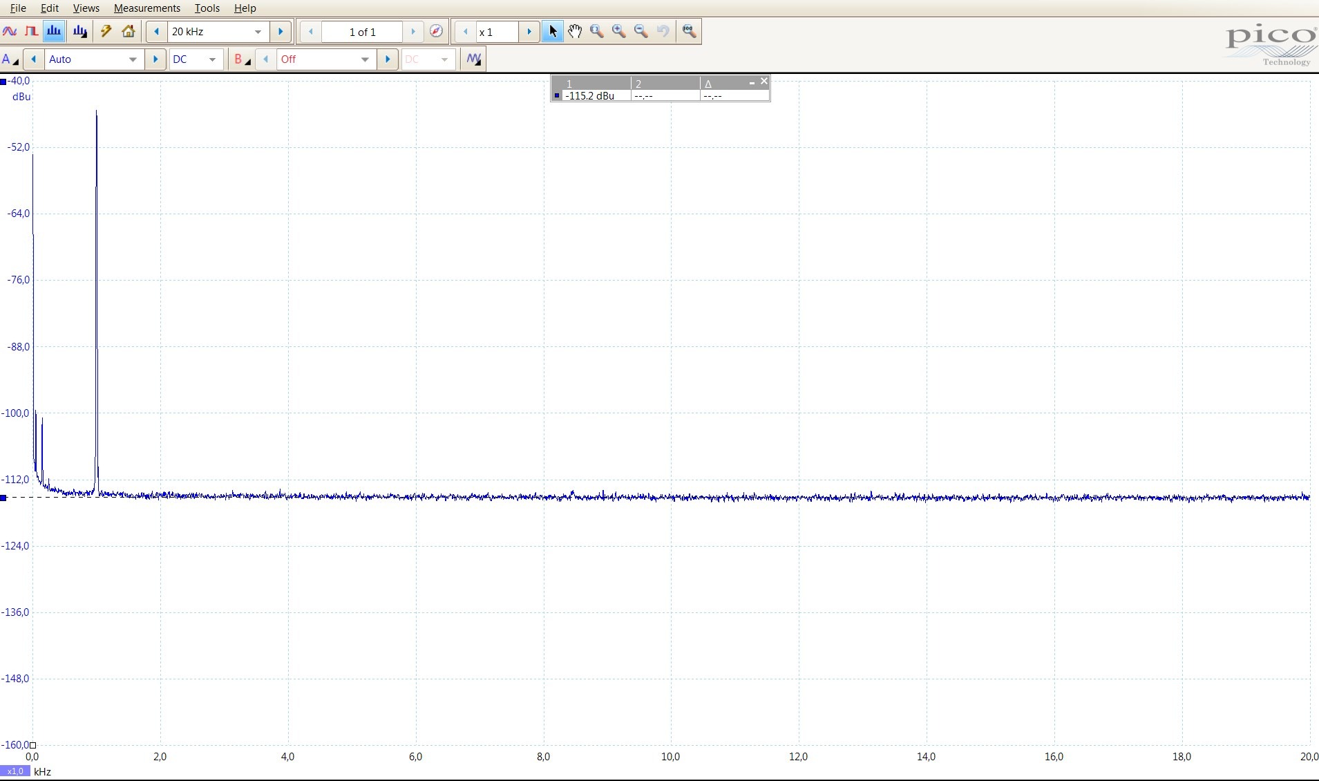

I see noise floor down to -113dBu for less than 500mVp input.

I can measure the time mode (oscilloscope) with LP200KHz and additionally a filter of 20KHz, and obtain a Vrms value of the noise with known BW.
Indirectly I can then 'calibrate' the SA-mode and work out its time constant / i.e. sample rate and dead time combined.

it does look extremely dirty. I was equally confused, as in such condition I would not expect to see -113dBu noise floor.The time-domain waveform looks extremely noisy. Is it real or just a display artifact?
Sadly, not an artifact. Surely has an explanation, but I have no idea how to interpret it. First time when this instrument puts me a question like this.
That's why I attached it additional to the freq. plots. Maybe you can tell more.
The emmiter follower was clean also on time domain, not just in frequency. Same for all my projects so far.
And 500 times the noise of a transistor follower in the same conditions.....

I don't understand how the distortion appears: on my own setup, I made tests at 8Vpp out, and there was still some margin available.
Isn't it an issue with the SA configuration? Maybe the input is driven into overload, and you need to insert an attenuator, internal or external?
I hope your SA doesn't have a 50ohm input, because that would cause overload, for sure
