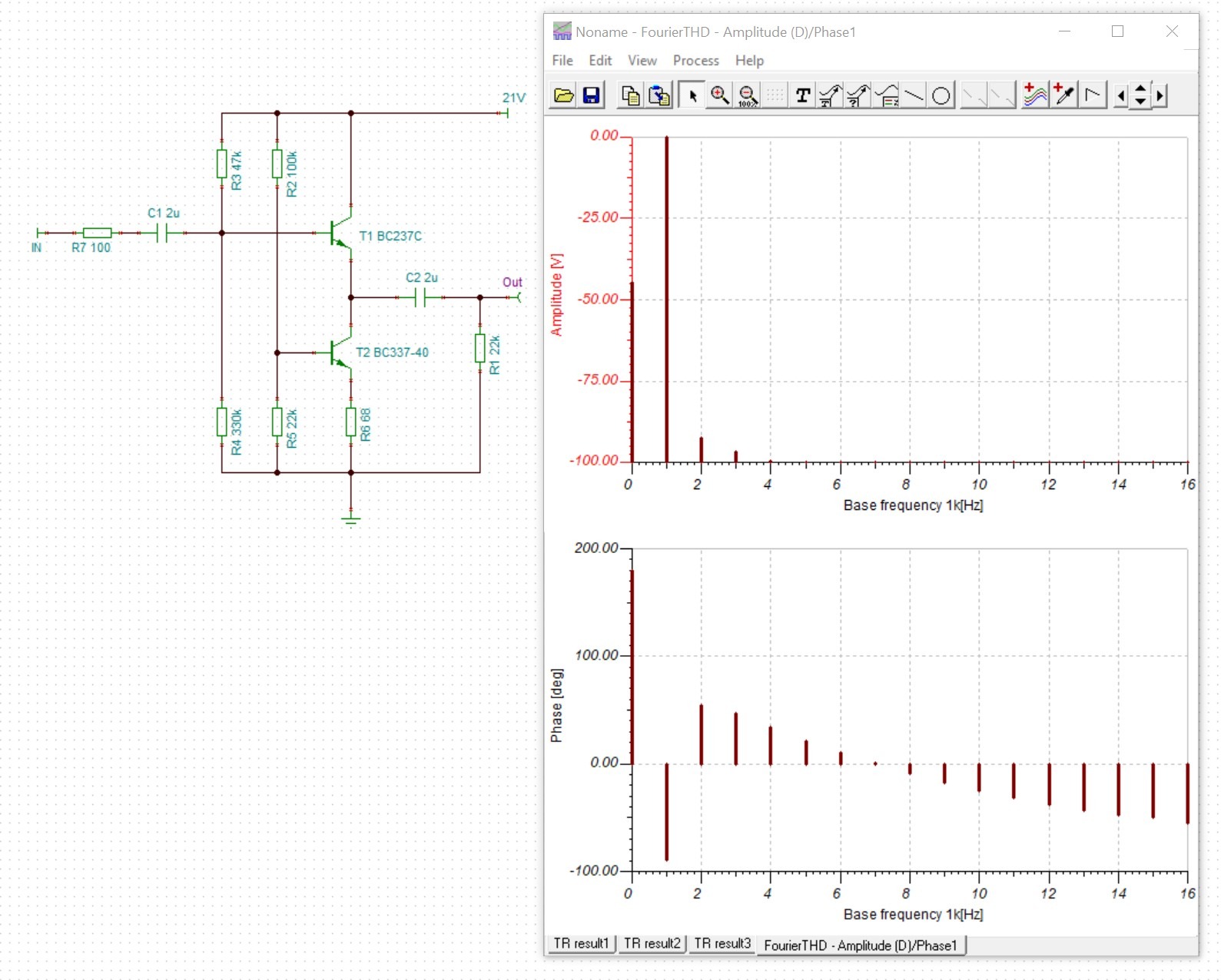

I built it and the results were slightly better than simulations: using 2xBC550B and for 0dBu the H2 is ca. -104dB. The noise was nice at -107dB (with 4096bins in 20KHz) and H3+ were slightly below this level.
One question: I was not successful to find its input impedance Zin by simulations. Do you have an estimate for it?
(seems to be lower than LM317 configured as per LV schematics with 2x20KOhm biasing, could this result be true?)
Could it be that it is less than 1KOhm?

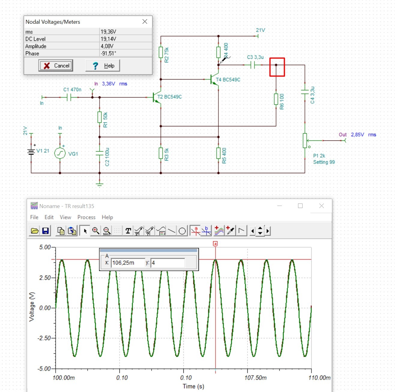

I have another 2xBJT proposal for a buffer, this time inspired by the Revox's TIA ideas (Rec amp stripped by EQ, and of course modify the gain settings resistors): the simulation results are very good or at least decently good (SNR>130dB, THD<0.0002%)... Clearly a better contender for 1xBJT (inclusive also the simple LM317 without CCS) ... BUT only up to 1dBu input!
Headphone requirement is out for this proposal. I can simulate good performance with >2Kohm loads.
Still, somehow I cannot find a solution to avoid the asymmetric clipping at around 1.3V. Or, if I find a way to increase clipping to 2.3V, then distortions are horrible.
Any helping hand please, to bring the clipping at >6V and still keeping the small THD+N?

Mostly a basic arithmetics problem: you try to drive a 2K load with a stage having a collector load of 6K8.
R5 and R4 should be at least 5x smaller.
In addition, the quiescent base voltage of T2 might be somewhat insufficient for the excursion you envision.
Proper DC bias conditions should be established before trying to go further

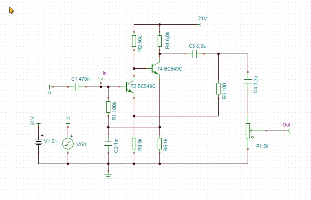

Thanks, I do believe it is basic arithmetics but I also believe it depends who you ask.
I am staring at this circuit for more than 1 year and I still cannot understand it, nor I find anywhere to read how it works (even less how to compute its bias. All I see is chocking everywhere, up and down. Playing with parameters, I see too many 'windows' and I am already dizzy... a nightmare for me.
Exactly the help asked 🤔
Say the least, I am curios to learn what the proper bias is when defined by experts. A few explanatory words from professors will be also helpful.
Then, the THD aspect which is seen to perform 'good' only when bias of second BJT is 'wrong'.
I know that number of answers is inversely proportional to number of questions, but I am desperate enough to try my chance.
In contrast to above, from below I understand that output is not exclusively T2, but also T1.
The output node always puzzled me: say 15uA into C3, plus 200uA into C4 and 250uA into R6 (all with phase, such as sum is null). This supports the statement above.
Then, the 2K load should necessarily scale the R4 and R5, or the R2 and R3? Apparently the latter.
But then, what is the role of the T2, apart from being instrumental in making a virtual ground in the T1 base?
And, how it is then proper to bias such circuit? In simulations I see that smaller R2 makes things go wild and higher R2 effect is to tame it.
Any case, question is how this circuit is supposed to work "nominally"? The higher the Aol gain (as amplifier) makes T2 contribute more and more to the output node (hence R4, R5 more relevant) and the lower the gain (as buffer) makes T1 contribute more to the output than T2?
To rephrase: if I want to add a CCS, where should I place it and how to compute it?
T4 is the main output transistor; T2 is the error amplifier.
In fact, the circuit is conceptually a CFP, but it uses same-sex transistors which complicates the implementation and necessitates various capacitors. The topology could be useful where only N-devices are available, eg. tubes, but with transistors, the best option is to use the regular CFP. The performances can be made identical if the transistors are of a comparable quality.
The logical place to put a CCS would be to replace R4, but it would be problematic since the voltage on the collector of T4 would become undetermined: the sense for the DC feedback is taken from the emitter
