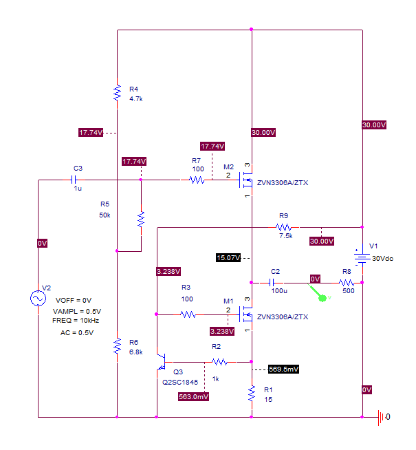

Since your headphones are 500 ohms, I could likely come up with something that could easily be constructed on a bit of perf board using a pair of Zetex/Diodes, Inc. E-line mosfets ( the ZVN3306A comes to mind) and a single TO-92 NPN transistor for each channel. Having a 500 ohm load really reduces the need for a lot of bias current to drive things. It also greatly reduces the size of output coupling cap needed for adequate bass response.

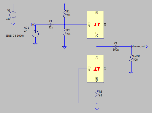

Why not just configure another LM317 as a current source?
Nice and simple with good specs. You can even get them in TO-92 if your careful of dissipation.

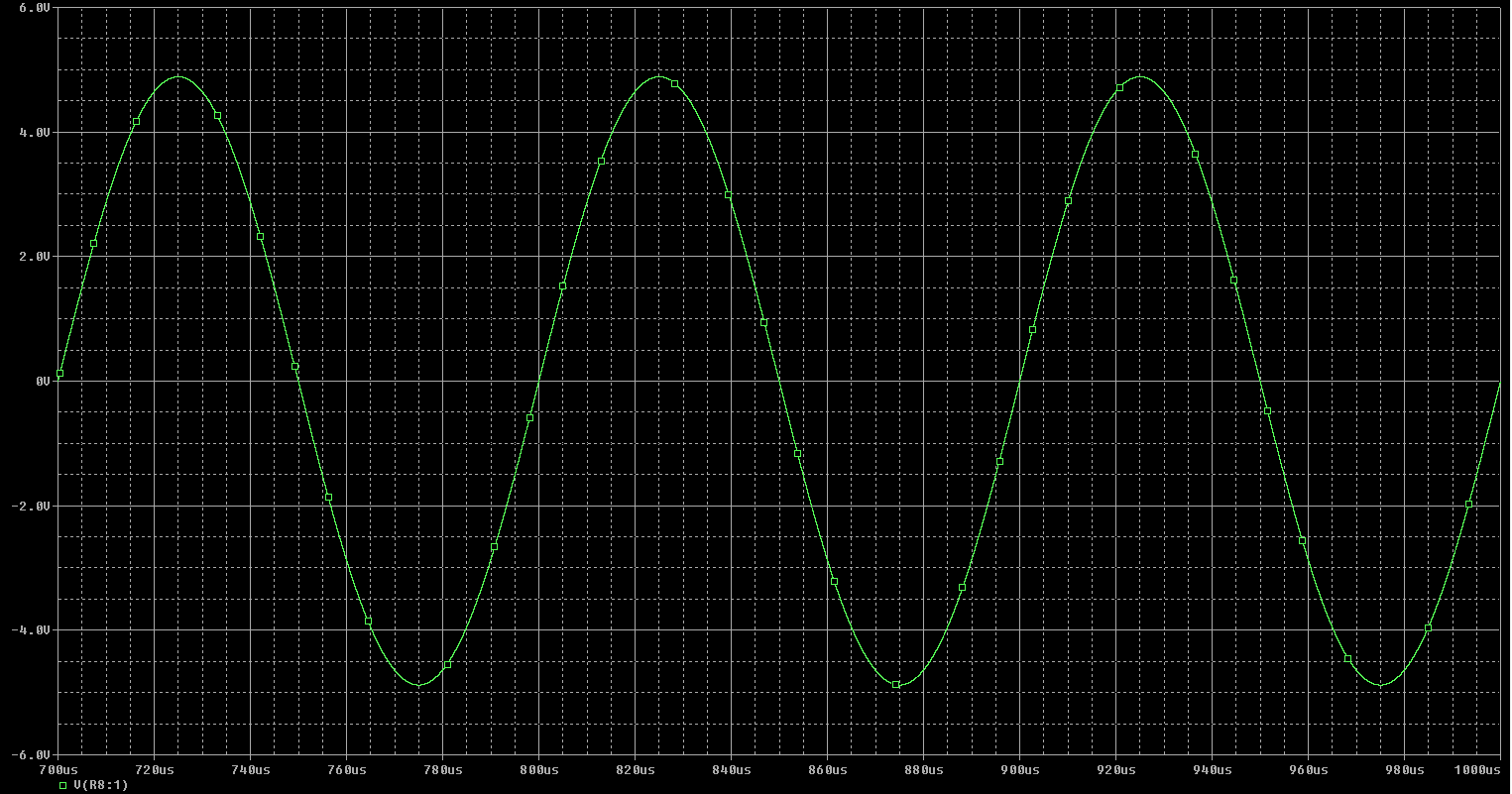

A TO-92 317 won't cut it for power dissipation. The E-line package device I had in mind will dissipate a half watt without breaking a sweat, more if you glue them to a heat sink. I'll know more about the necessary bias current when I can get to a copy of PSpice and run the numbers. 20mA bias current is needed just to avoid clipping with a 500 ohm load. More will be needed to to reduce distortion - I'll be finding out how much. Maybe a lower Vcc supply will be needed to cut the power dissipation down.

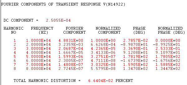

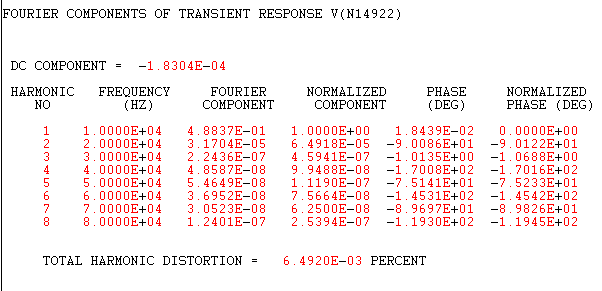

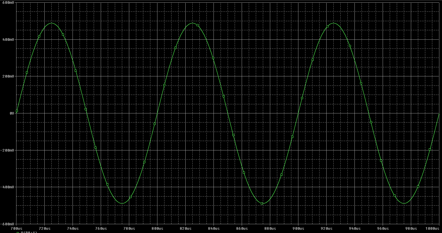

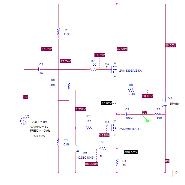

Here is the version using the ZVN3306A mosfet from Zetex/Diodes, Inc. Distortion is not too shabby, and dissipation for the mosfets is ~0.55W. These would probably run at a little over 70C without a heat sink, but you could glue the part to a standard TO-220 screw-on heat sink for some dissipation relief. I would recommend using a filled epoxy like JB Weld for better thermal transfer to the heat sink. Degrease the heat sink using 91% IPA before gluing the part down for better adhesion.
