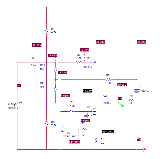

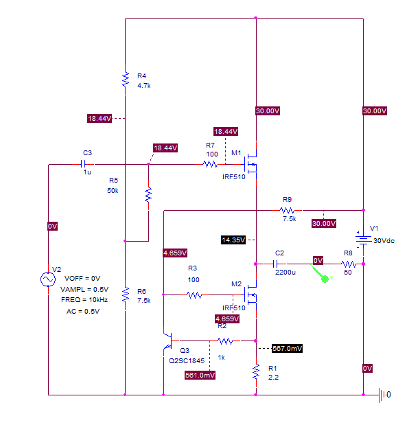

In a silly play mode, I have tried to modify your circuit into a Current Feedback TCA with BJTs, but without success in this direction.
However, after a few 'optimizations' it turned out as a Buffer with variable attenuation and it has a very nice THD 0.0027% in full range of attenuation (for loads above 10K).
More, at +12dBV it has THD of <0.01%. Wow!
Also, it accepts loads down to 5K with just 0.02% THD sacrifice.
I don't know who cares about this, I'll just post it.
Maybe the SNR of a simple voltage divider has a better SNR below 1KHz, but apparently the SNR of this active attenuator is better by 5dB above 1KHz.
Personally I was looking a long time for such toy. Still, maybe I did some mistakes. If anyone sees them, please drop a line.
(...and I am still looking for a basic Current Feedback TCA topology with simple BJTs... no Opamps)

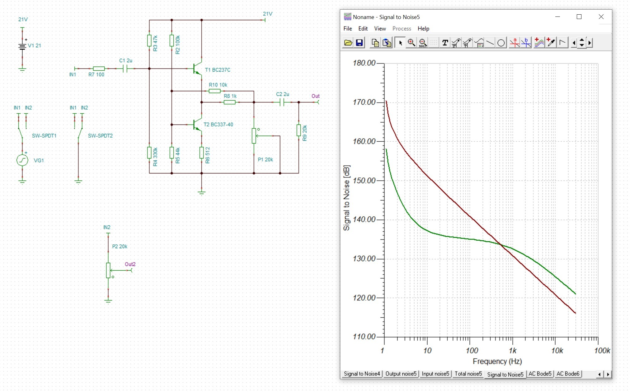

I see that lowering the load the performance collapse And also increasing gain can reduce but less the THD+noise
I cant sim your schematic because i do not have the used bjts models But i am sure that with try and see changes very decent performance can be obtained from the circuit
If you will ever build it let me know your impressions

Though a touch more complex, this circuit is more likely to deliver what the original poster actually needs. The mosfets are rather hotly biased, so each mosfet will need an appropriate heat sink. The circuit is a classic current source loaded source follower using IRF510 mosfets for both the input and current source positions. I used the 510s because of their relatively small input capacitance, making them easier to drive. If a pot is placed in front of the input mosfet, the added impedance will likely slow down the response. Attached are the circuit, the output waveform and the sim distortion profile.

Getting back to 2xNPN modified by me (Post #242), I made its first build tonight using BC550-B:
Later, I asked if 2xBJTs can be an alternative to LM317. This is where we are right now.
I am not yet to 3x BJTs (J-FETs or MOS-FET included), and I will most probably will not be.
I believe your statements and appreciate your proposal, but I won't build it soon.
- buffer function confirmed as expected
- variable attenuation not confirmed. Dead stable, no matter what P1 setting is. I must hunt for my mistakes though.
- SNR (rms) measured is better than 116dB (not A-scaled)
- harmonics: measured H2 <-100dB if P1 is low, and ca -74dB if P1 is high. Expectations were H2 to be around -100dB, but independent of P1 setting.

Funny, even LTSpice tells this should be a variable attenuator.variable attenuation not confirmed. Dead stable, no matter what P1 setting is. I must hunt for my mistakes though.
Maybe I bumped the BJTs by mistake, somehow...
the BJTs were bumped. replacing them fixed the problem

For this schematic i just put two bjts one on top of the other and add some resistors for biasing them
It is like the B1 buffer but with bjts Then i changed resistors and saw how the THD spectrum was changing

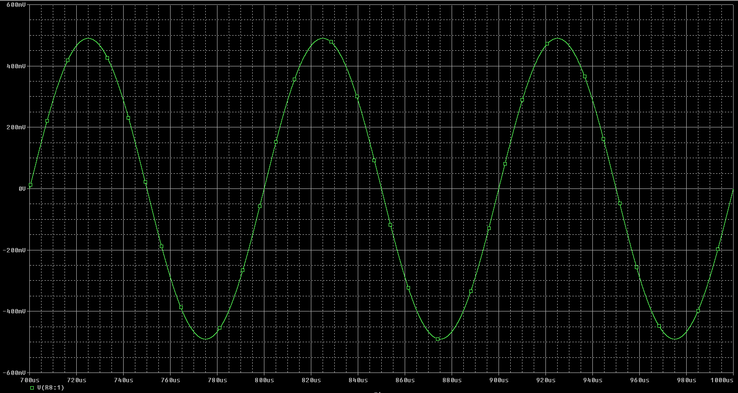

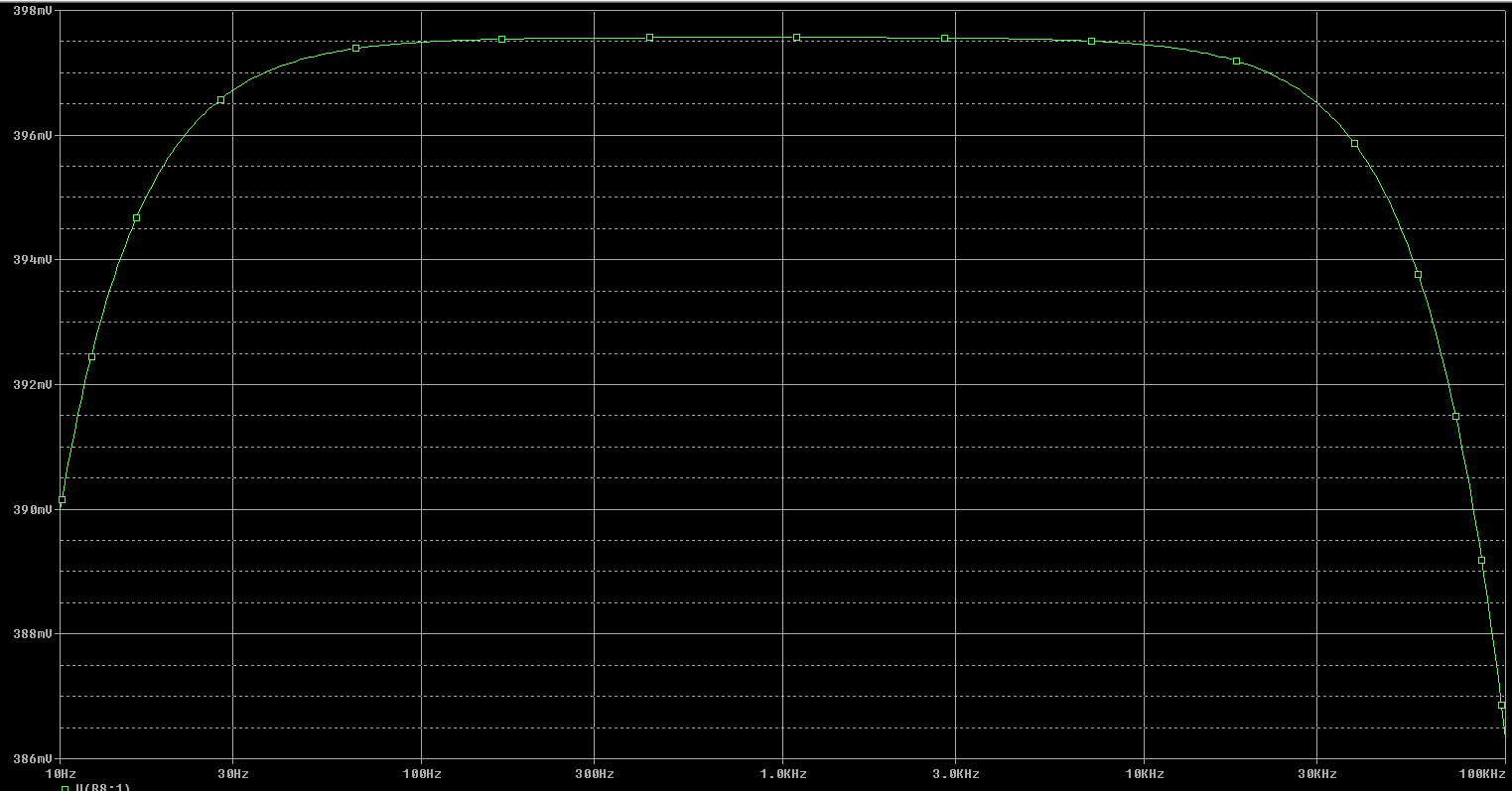

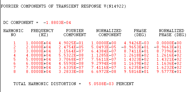

I have just tried to optimize the circuit on the basis of the simulation and the result of the fft
I have tried to reach a low THD and stop
I have checked the dissipation of the bjts and is not that high I hope there will be no problem with the prototype
