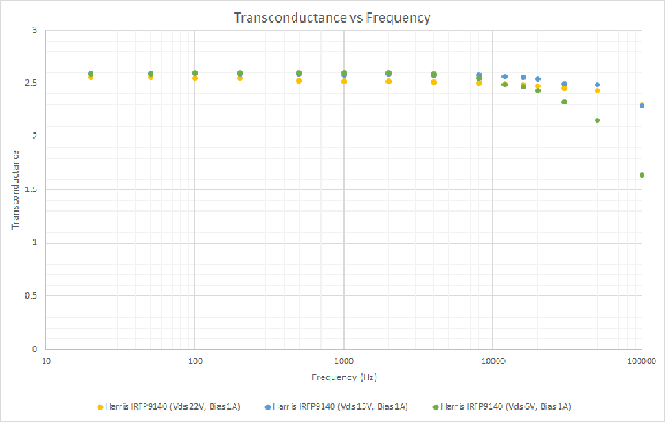

Increasing Vds generally improves bandwidth, as seen in the results.
Of course if it were used common source and you apply feedback, at that point transconductance will most certainly improve bandwidth, so both need to be considered depending on the application.
Edit: I will do transconductance vs bias later.
Harris looks bloody interesting.
Transconductance virtually remains unchanged even with lower values of Vds.

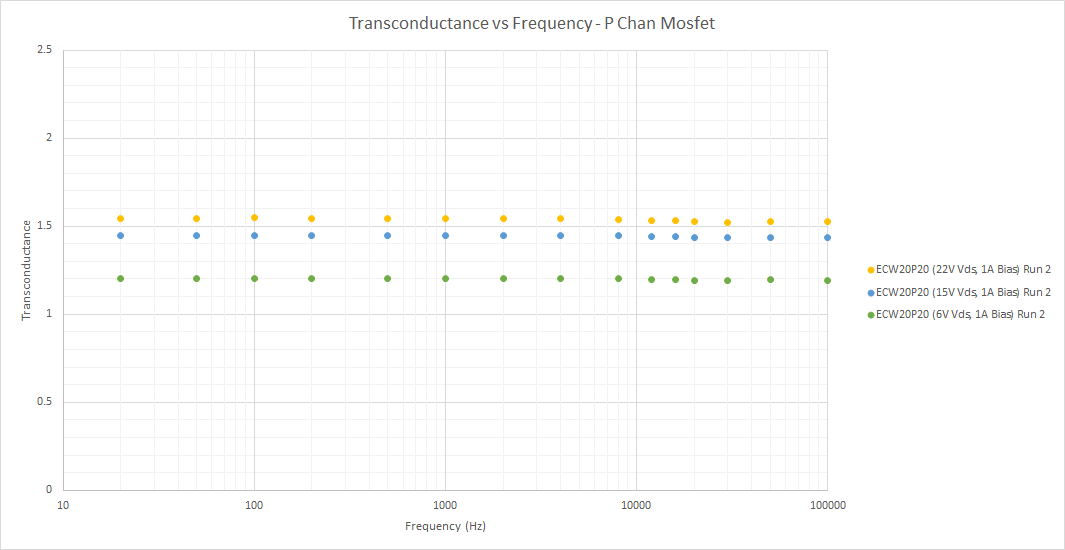

ECW20P20 Transconductance vs Frequency
Running this a second time since fixing test leads.
