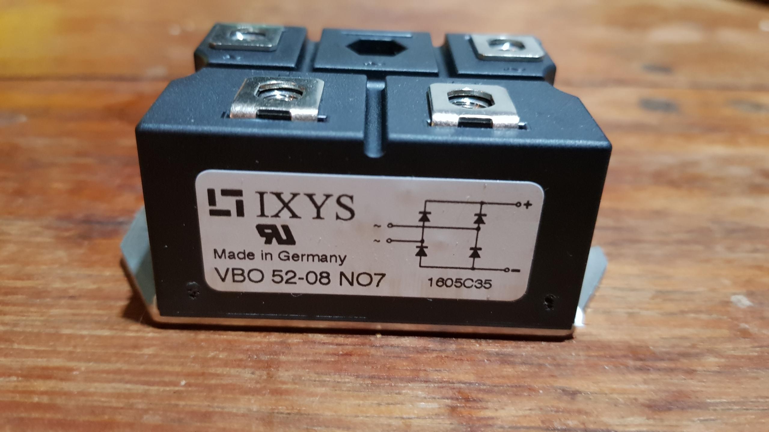

Pico you are a bloody bastard. Now tell me what bridges are you using?
Thank you kind sir.
I am using IXYS VBO 52-08 NO7

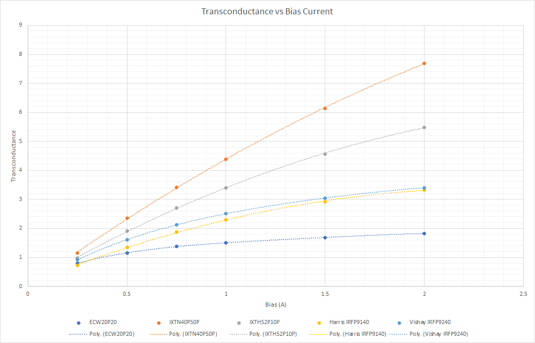

Transconductance vs Bias - P Channel Mosfets
20 Vds
Later I will check how much variation there is in a population of mosfets.
Probably won't run complete curves, just a single data point at 1A, then maybe do a curve for the min, max, and median parts measured.
20 Vds
