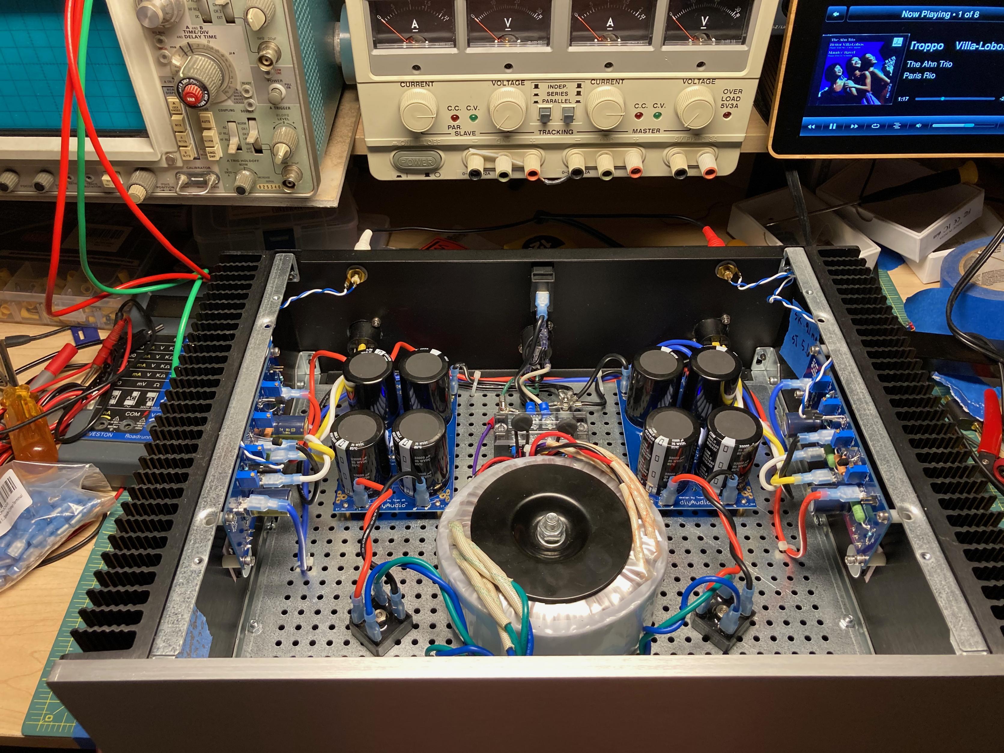

I modified the other channel. It also had a 9.1 ma 2SK170. I replaced the matching 2SJ74 with one having an Idss of 5.6 (closest I had to a 3 ma difference). After adjustments, I got identical distortion results to the first channel. I am very close to Papa specs at this point. I think the only way to get any closer is to look at selecting laterals. For now, I am going to finish buttoning up the amp and let it play for a while.![]()

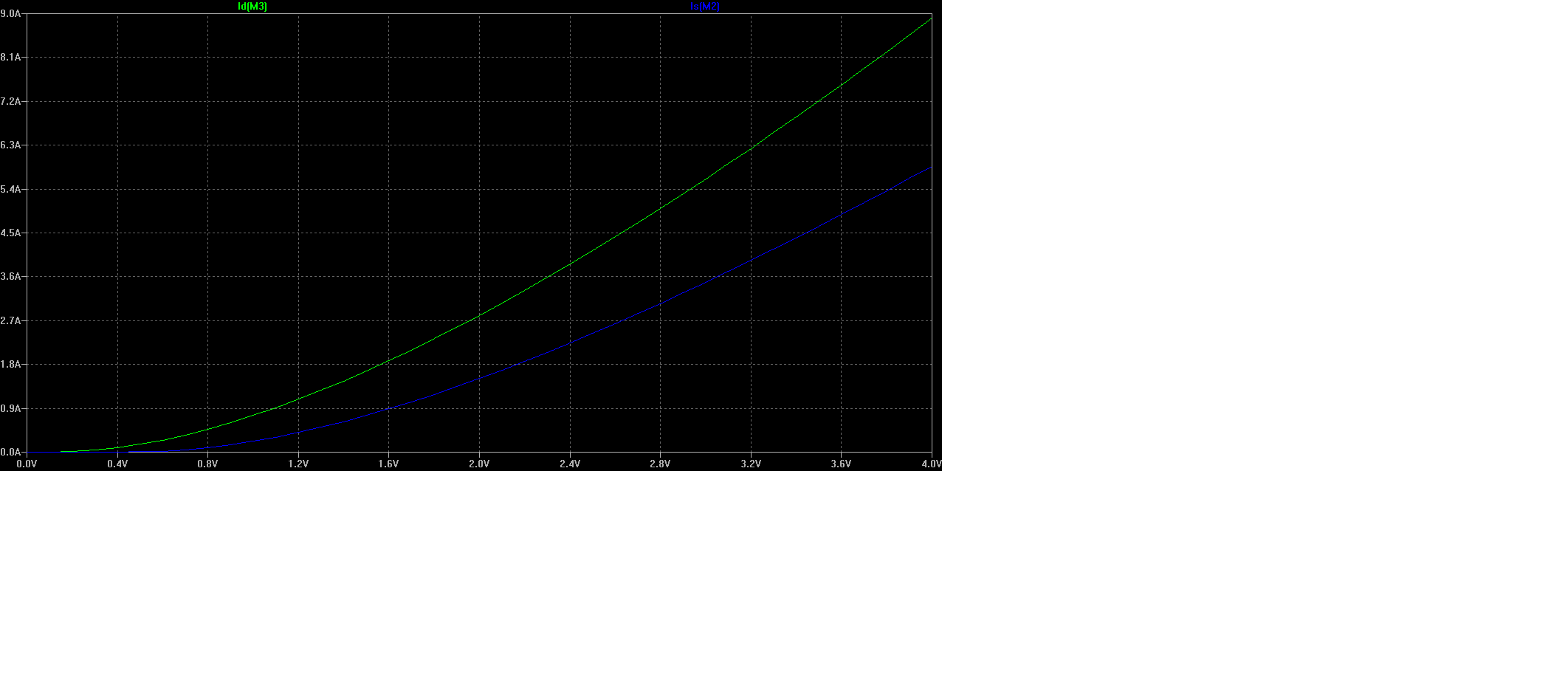

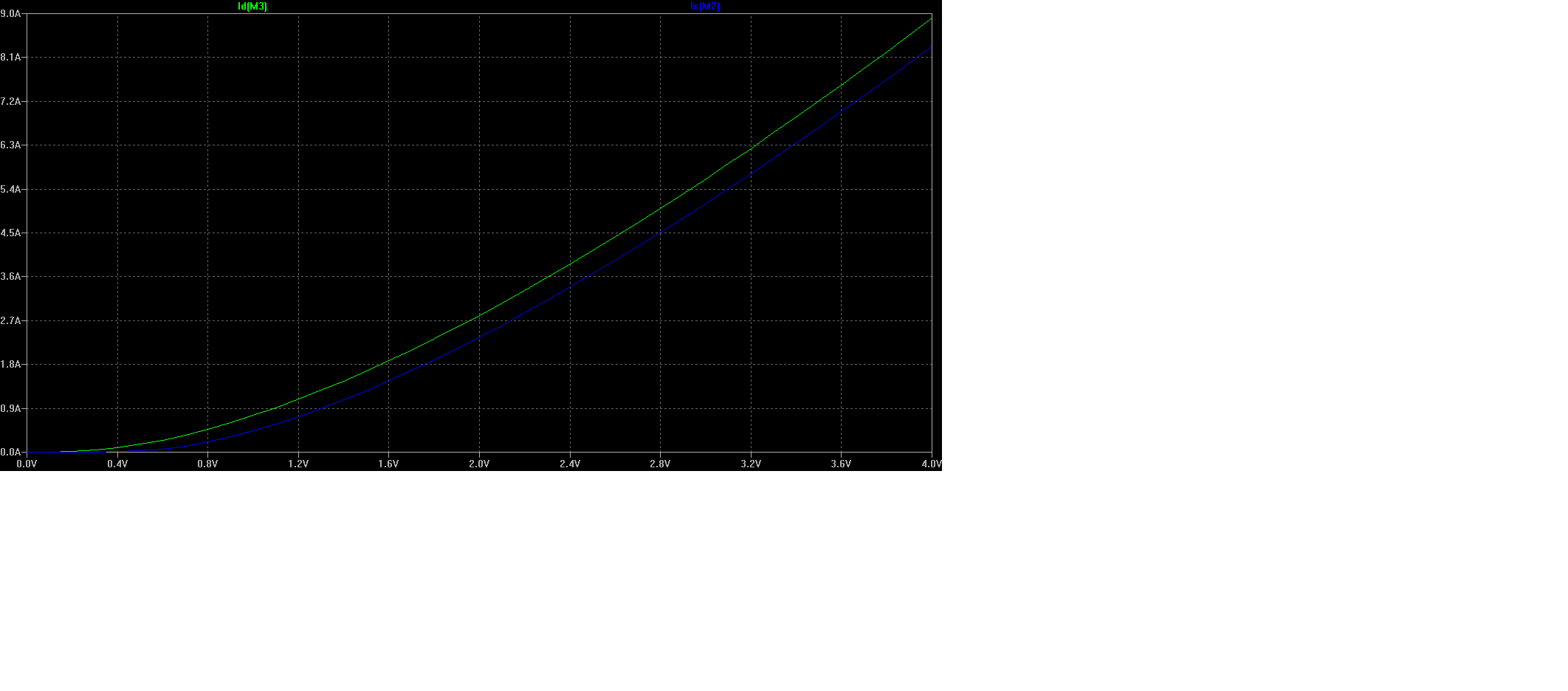

It wasn't 18 percent it was 23 percent higher amplitude on the 20P20. If these mosfets matched the lines would run parallel but they don't. So I bumped the voltage up on the 20P20 and they matched better. Then I raised the amplitude up 23 percent on the f7 circuit and the distortion went down to .005.

It is done and sounds fantastic! Had to swap 18 Volt trafo for a 20 Volt Antek to get the rails up to 24 Volts DC (too much capacitance on the filter boards 🙂 - 4x 33,000 uF each - have about 4 Amps of ripple current each side) but nice clean DC on the rails @ 1.2 Amp bias each channel. Also losing about 2.4 VAC on the inrush thermistors and about .5 Volt DC on the R in the CRC.

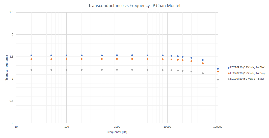

Transconductance vs Frequency - P Chan Mosfet
Bias is 1A
Vds, 22V, 15V, 6V
No shelving on ECX20P20
Excellent bandwidth.
Lowish Transcoductance
This part is not what I was referring to in my post above, that is a completely different part.
Bias is 1A
Vds, 22V, 15V, 6V
The higher transconductance with higher Vds probably explains why the amp shows lower distortion with higher voltage rails. This seems to have a larger impact than bias. That's the main reason I went with a 20 Volt transformer. Wondering if offsetting the rail voltages would be an interesting experiment?
