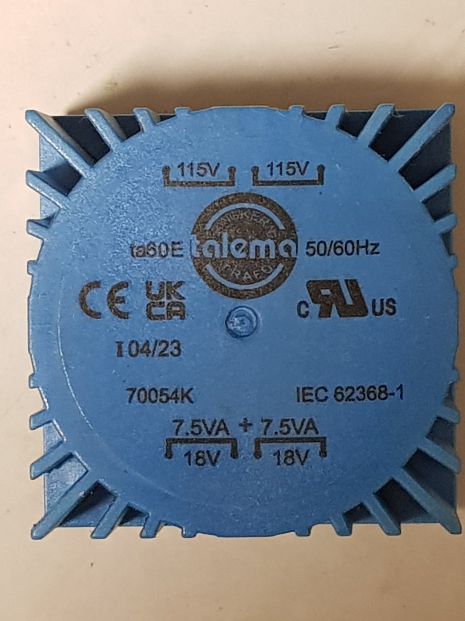

Please let me know the value of R3, R4 for Talema 70054K?

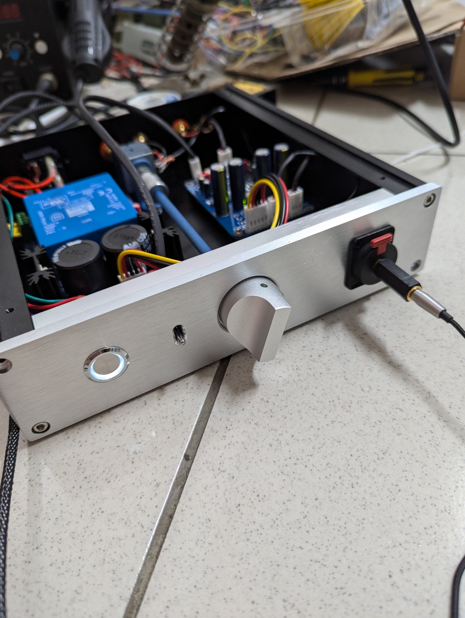

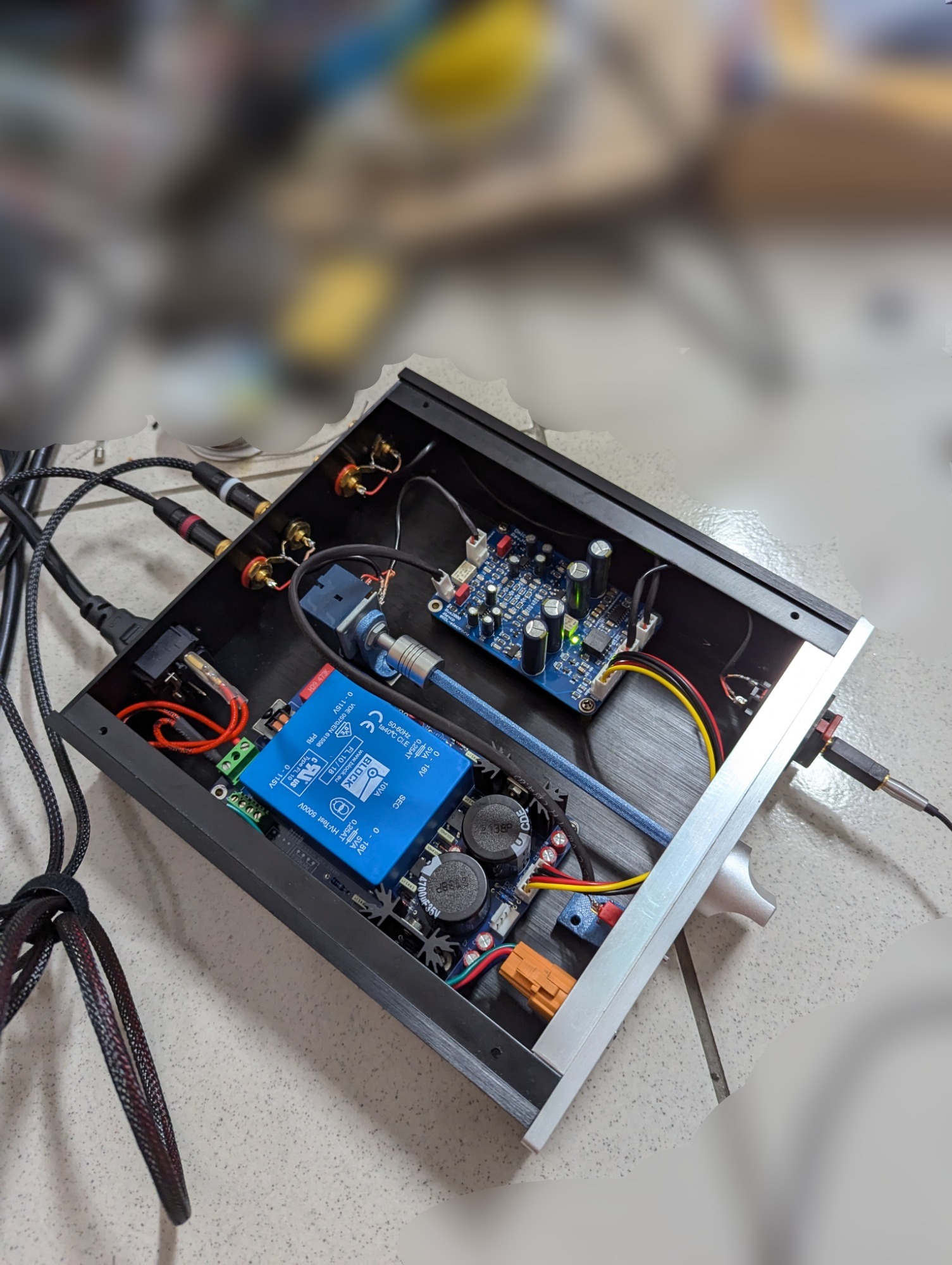

Here's some pictures of the build, the alumium case is custom made(R&F panel) from China and it is relatively checp ~25 USD(volume knob & IEC jack & CNC processing fee included)
Some parts are 3D printed, especially the toggle switch, there's no bracket for that.
The Omicron is a fantastic headphone amp and preamp, the background is more black and bass is more deeper and puncher. Also the clearity is absoluly amazing, the vocal is no doube much clear from the track "Mistakes from Lake Street Dive" than before.
And the crossfeed did something, especially from older track or some track that the musical instrument sounds are more biased toward the left and right channels. Toggle on the crossfeed makes the soundstage a bit wider and the sound is no more at the front but a bit lay back, more natural.
Thanks to bring this great project for us, Alex!
