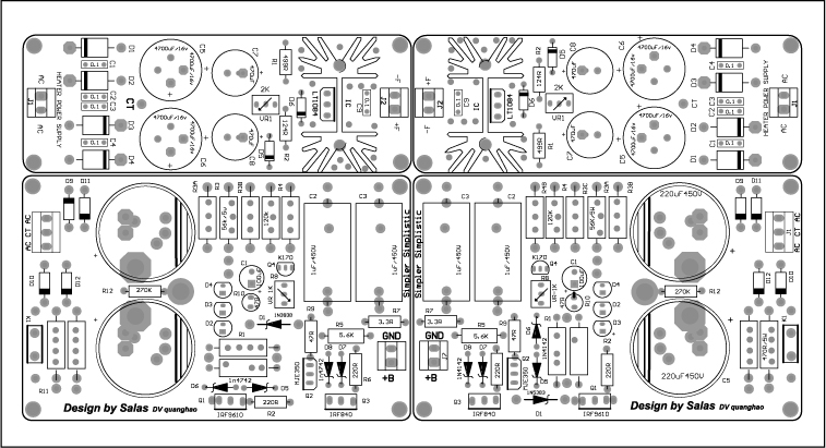

and layout all in one, the top

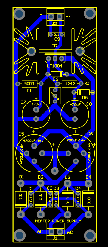

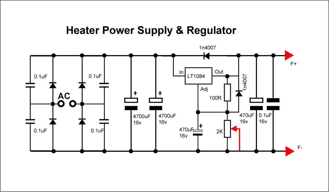

Quang Hao,
On filament PCB, there is resistor R1 = 500 Ohm in parallel with the trimpot.
The total impedance (R1 // trimpot) can never exceed 500 Ohm, is this resistor R1 additional/intensional?
I can not find R1 on the schematic.

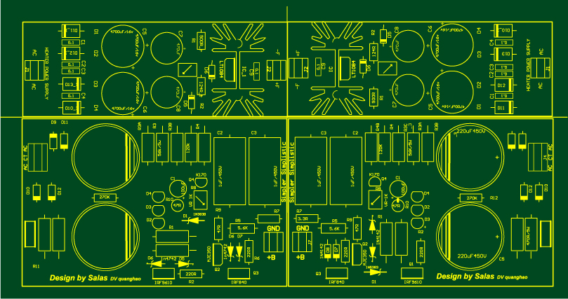

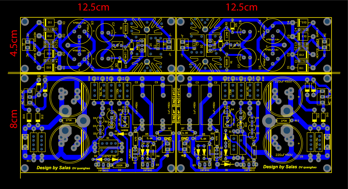

Compliments for all the nice work.
A question out of curiosity: why is the layout of the second HV-shunt in opposite compared to the other?
Depending on the mounting in the case this might be convenient, or not.
The two layouts of the heater-reg are the same.
