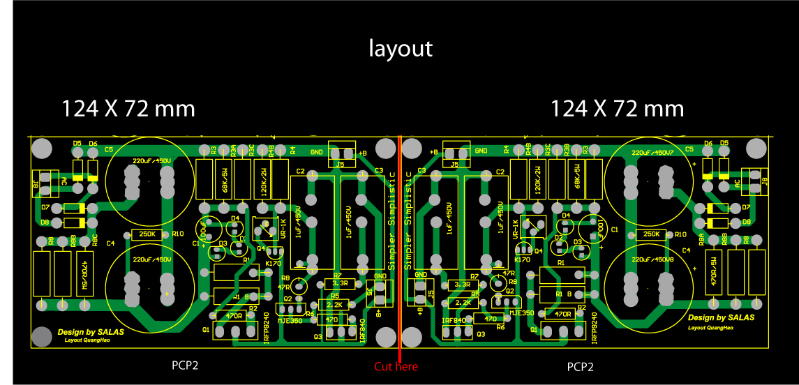

many people asked me about the price of PCB, now I do not have the official price,
In the group's share I think the price is not too expensive. I expected as follows:
One PCB Size 250 x 100 mm including:
1. 2 PCB The Simpler Simplistic ( on for left + one for Right chanel)
2. may be have 2 x filament use Lt1084 or Lm 317
3. Shipping by envelope and free paypal
The price About 25-30$ for all
I will calculate a reasonable price to bring the official number of participants

quanghao, how about making room for some to220 diodes (stealth diodes etc).
Another suggestion, is the trimmer a standard footprint? in the dacend group most people had to bend the legs of a smaller trimmer to fit.
yes! i remeber that, about the diodes, and Trimmer
thank adamus

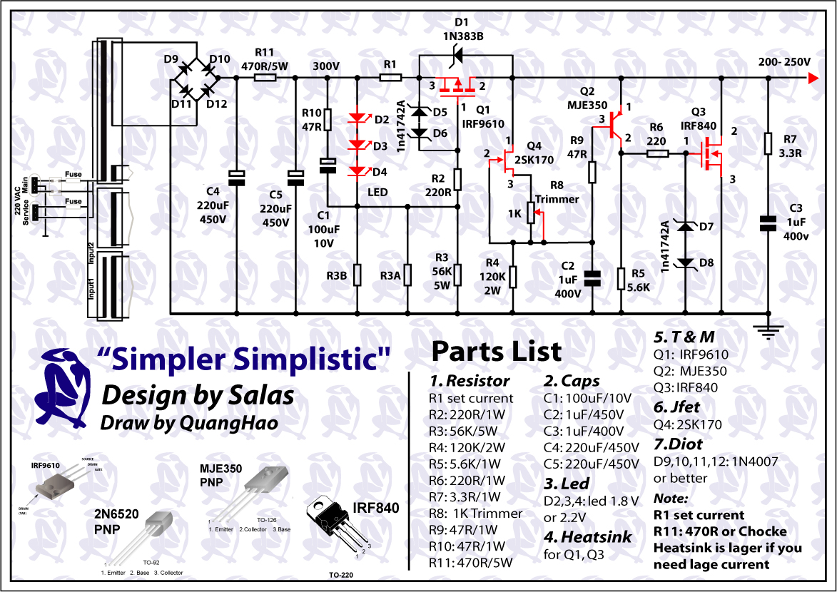

I draw circuit follow Salas. What is wrong can you show me please??
thank you!
