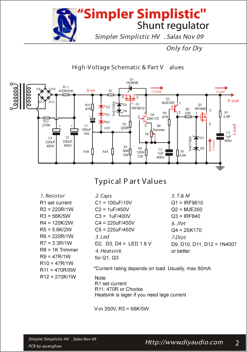

Simpler Simplistic design by Salas Group buy PCB
A. Information about Salas low shunt:
http://www.diyaudio.com/forums/powe...stic-mosfet-hv-shunt-regs-97.html#post2084348
Thank you Salas
_______________
B. COST OF One PCB * 4 supply* (2 Simpler Simplistic + 2 Heater Power Supply)
2 x Simpler Simplistic
2 x Heater Power Supply
The price:
Board set (of 4):
Shipping from Vietnam: US$ 6 (surface mail)
Payment fee (PayPal) at 3.5%: US$
TOTAL: US$ 30
my email address: quanghao168@yahoo.com.vn
my papal: quanghao168@yahoo.com.vn
Thank you.

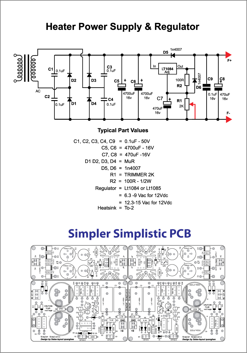

this is the I/V stage I'm talking about....
Can I parallel 1 shunt & 1 heater psu board to each tube like in the circuit?
gabanyayaya
I'm pretty sure to parallel one shunt regulator for both channels (L and R) is really bad idea, because of too strong crostalk between channels via same PSU source.
Even with white cathode follower which has strong PSRR, it is not good idea.
Your schematic however is symetrical totem pole amp, which has medium PSRR value.
regards
regards
quanghao
In this Tube (6n2 or 12AX), use some mA. you can use one suppy for it.
But i dont like SRPP for DAC, i fin in my house, if i still have PCb SRPP, i will gift you, don't pay money.
quanghao
Can I make Paypal transfer for 3 PCB in amount 3x30 USD, or I need to wait some options for postage cost?
Concerning gabanyayaya SRPP schematic - it shows like I/V ala Lampizator with 6N2P - one solution for I/V, amp and even buffer. If here is question of space in box, it is not worst solution, IMHO.
What is wrong with SRPP as I/V - can you share your experience?
gabanyayaya
Indeed you can use one shunt regulator as power suplly, but better substitute by it only diodes D1-D4 - leaving RC filters separate for L and R channels. This would be reasonable because even SRPP's upper tube works as CCS, this is true only if SRPP designed well - matched on specific Rload.
You can read about it here - The Tube CAD Journal,SRPP Decoded .
If you need to calculate SRPP, just please write me - s.navikas@zebra.lt, I will do it with TubeCAD for my pleasure.
gabanyayaya

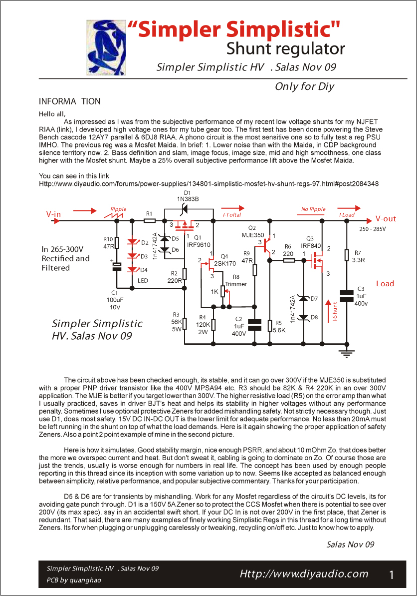

A. Information about Salas shunt:
Thank you Salas
_______________
B. Information PCB
+ One PCB:
2 x Heater Power Supply+ Quality:
two layers , gold-plated, 1.6 mm thickness
C. The price includes:
PCB + Shipping (surface mail) + fee PayPal :
1. PCB = 30$
2. PCB = 55$
3. PCB = 85$
4. PCB = 110$
