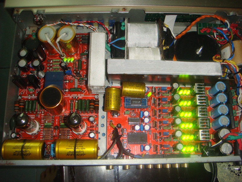

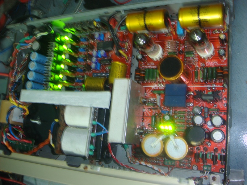

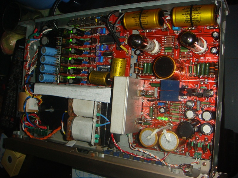

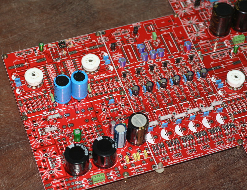

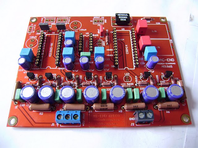

some image update Dac-end 2, with new PCB, new IV, use 6h30, or 6h6, 6dj8.

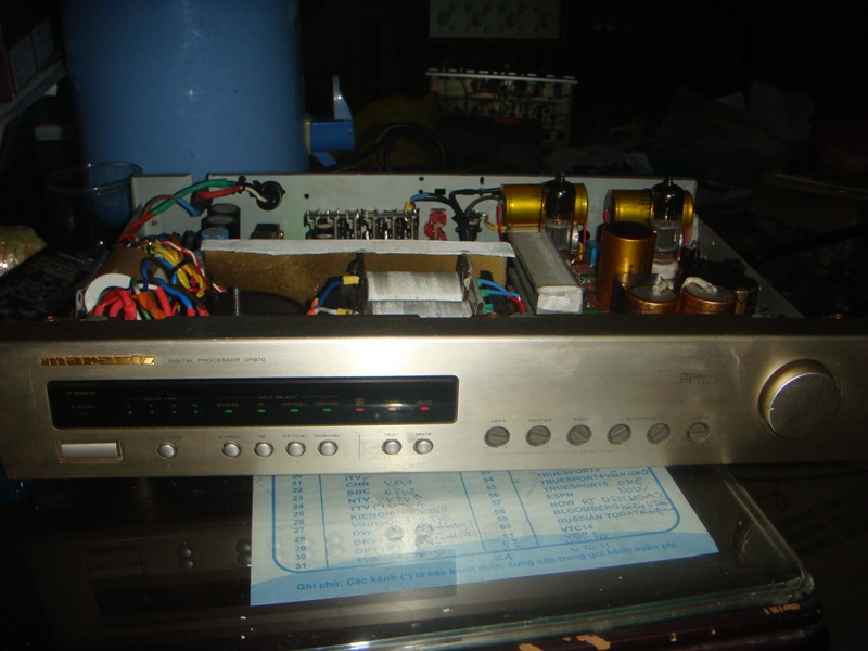

My friend say:
*The doctor is busy walking to project what the topic is too quiet, waiting forever do not see any medical report on the progress and results at all. After a calibration period, re-arrangement END DAC, please post some picture showing this with the doctor. Last night I went to play audio DAC reseach model (do not remember, but it bears), TEAC CDP 50, according to their personal nature, the DAC for audio END feeling smooth, easy, quiet, high to transfer, low down deep definitive solution, and solid, no holes rumble function, travel bags tiegn BASS hear his real *

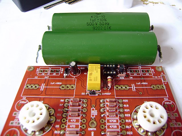

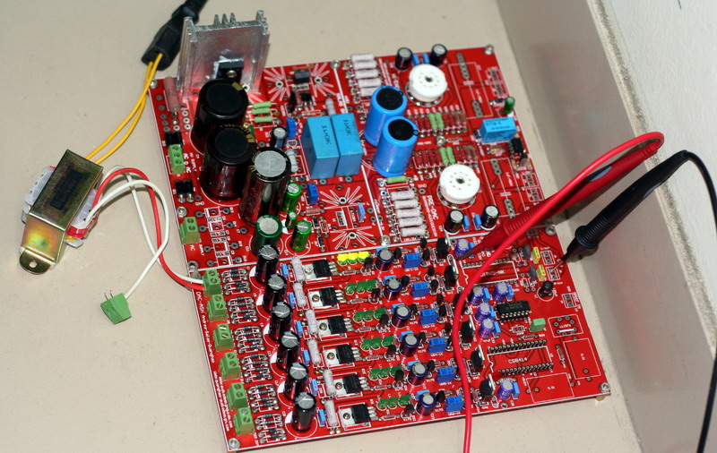

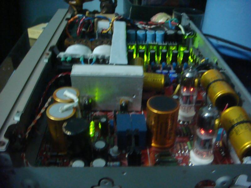

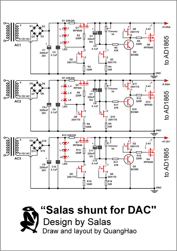

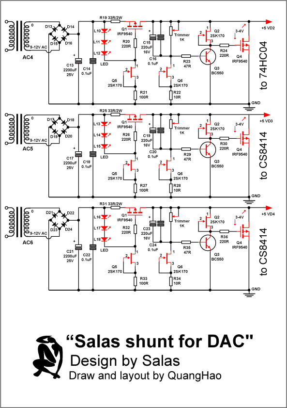

Just sharing my progress. I do not have much time to spend on the project but I am nearly there.
Yesterday I managed to run Salas Shunt. R13 = 8.9R (2x 18R in pararell). With DAC board is attached (no ICs though) I am able adjust ditigal branch up to 5.3V. If I try to go for higher voltage it locks at 5.37 (Vgs drops to zero). For both analog branches I am able to ajust up to +/- 5.6V
Also I am thinking about using Russian PIO caps for I/V. Those are really BIG BOYS (even compared tho Hyrels) 😀 😀 😀
Tomorrow I will post more pictures.
