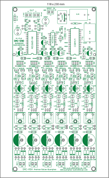

this is layout and size PCb DAC-end 2 updat

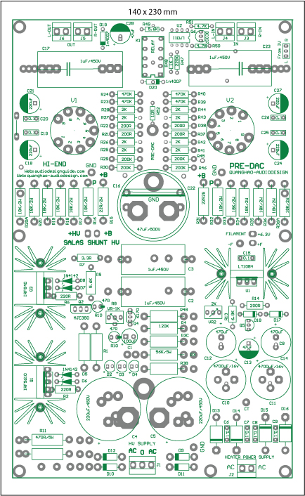

PCB updat for DAC-end2
DAC board :After success with the PCB for placement DAC-end2, Tl431 used to separate the sources, and used for the inputs Salas low shunt. I removed all replaced with Tl 431 by shunt Salas.
I/V stage: I use Salas hight shunt for IV, and I use tube 9 pin: 6h30 or 6h6 or 6dj8…

A. Information
1. The DAC-end up dat
Material: FR4 – 1.6mm
Layers: 2
Board size: 118 x 230 mm
Surface finish: Immersion Gold
Soldermask: Both sides – RED
Silkscreen: Legend on top
2. PCBI/V stage ( Salas HV shunt + IV use tube 6h30, 6h6, 6dj8 parallel )
Layers: 2
Board size: 140 x 230 mm
