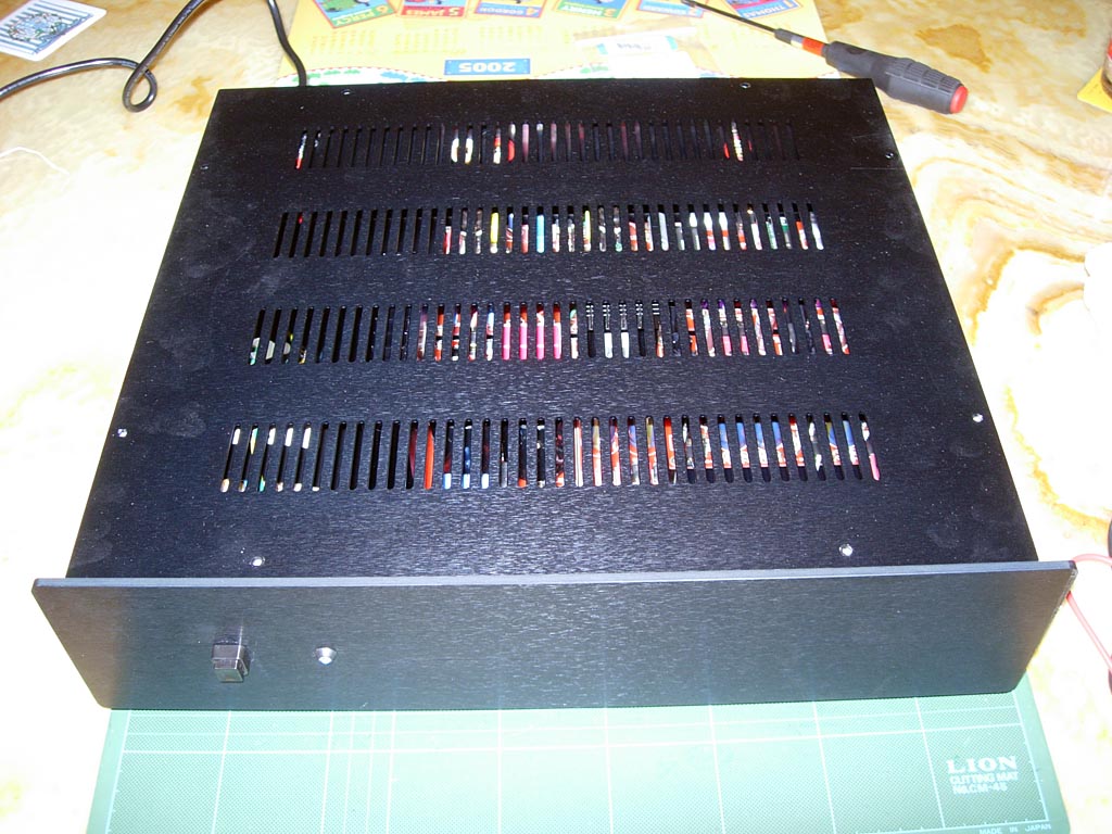

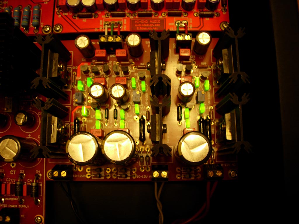

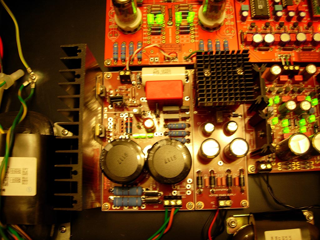

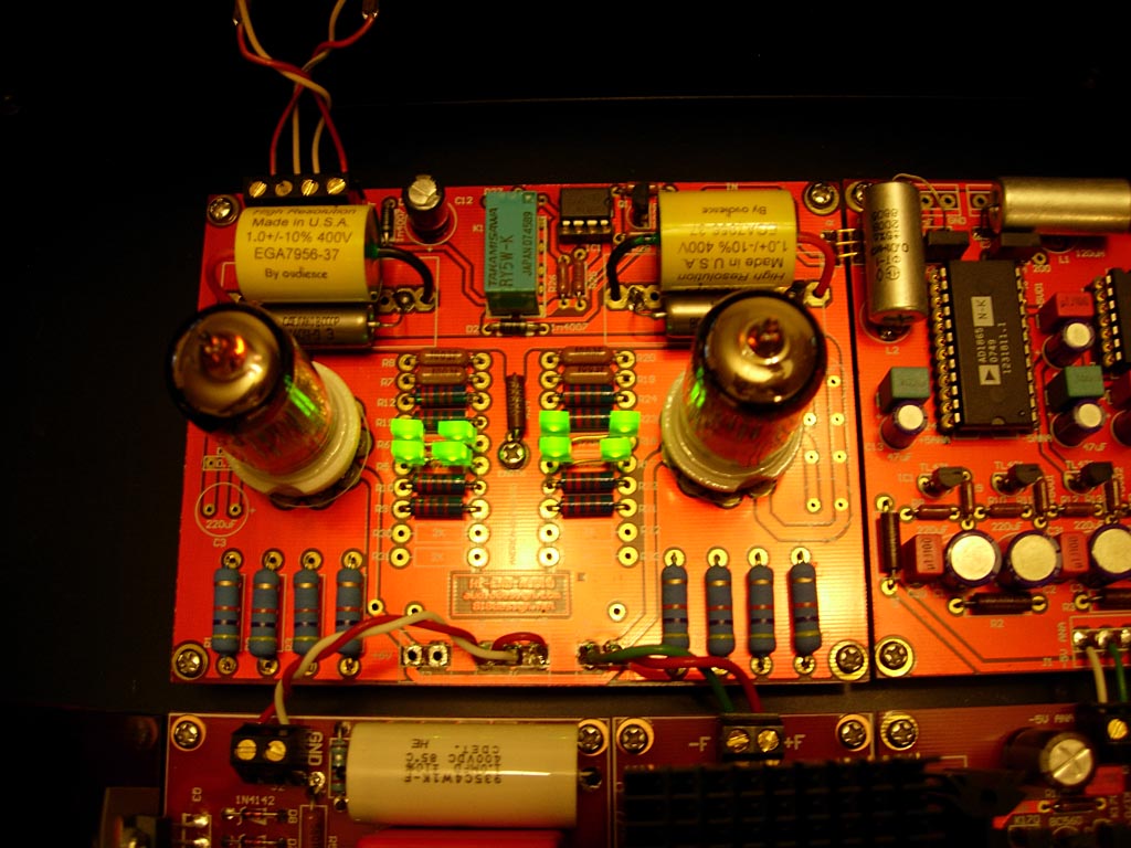

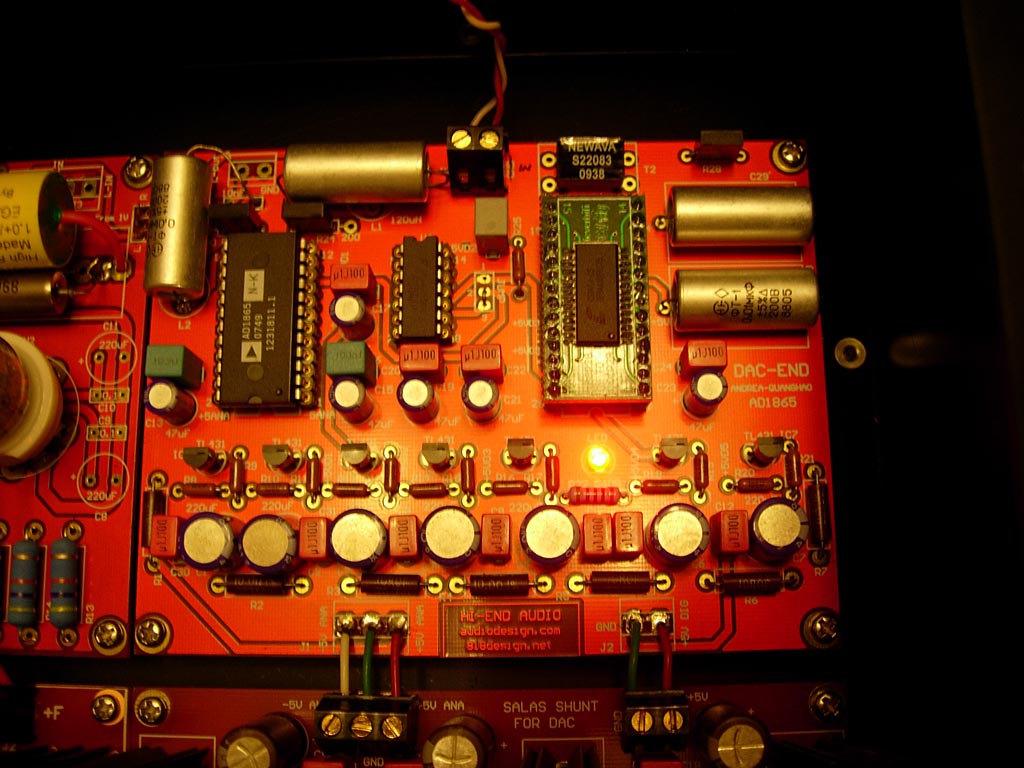

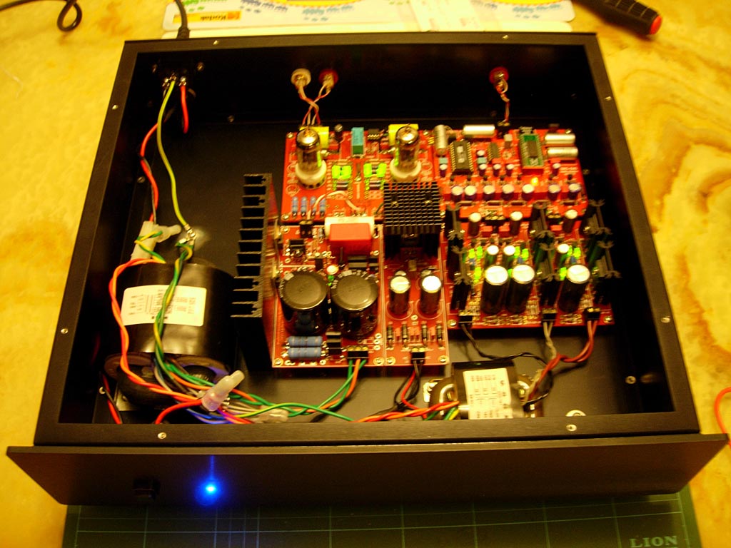

My Dac-ends has sung for a couple of days now with very nice sound and spectacular mids. Attached are some photos after it was housed in a chassis.
I use 8.15 volt AC and lm338T for the filament regulator. It's too hot inside the chassis even with a 2" heatsink with a BGA heatsink sitting on its top! 😱
I'll be cutting traces of the filament PCB and install a 0.68R 10W between the 4700UF caps to lower down the dissipation. Of course, I'll use lt1084CP in lieu of the 338. Unfortunately I only have the TO-3P version so some modification to the leads of the IC is required.

Hello David,
Thanks.
I have the chassis from a local diy shop costing me about USD70.- It just fits all pcbs of the DAC-end and the 2 trafos.
I do not have the pcb of the original power supply and thus I can't compare its sound with that produced with the shunt supply. Sorry.
