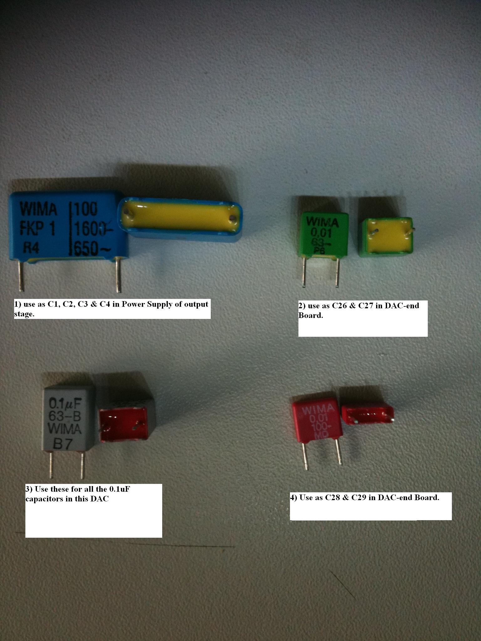

Hi! I need some advice in the 0.1uF & 0.01uF capacitors need to be use in the photo below. Do your think it good enough? How to know which one is good in audio signal? Please advice me. Thanks
The only one I would use is the large one on C1,C2,C3,C4 on high voltage PSU. You need four of them. The rest in particular the red one I would not consider.
The Vishay Roederstain MKP1837 is the beloved one. Use it on Dac filter, Cathode bypass and around +5 , -5 the Analog DC input of the DAC.
Vishay BC MKS 0.1uF where the MKP won't fit with criteria.
I check my local Farnell & RS website, they selling Vishay Roederstain MKP1837 0.1uF & 0.01uF very expensive. I will find other source. Can i use Sprague Black Beauty 0.01uF/600V as input cap. at C28 & C29 on DAC-end board? Thanks
