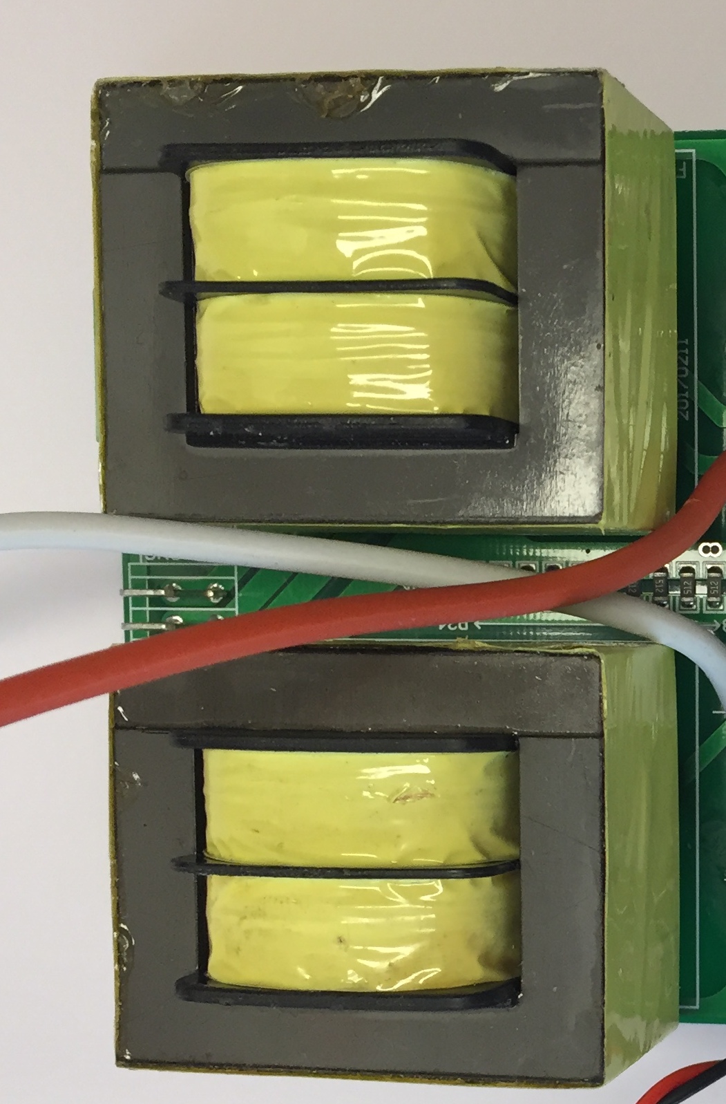

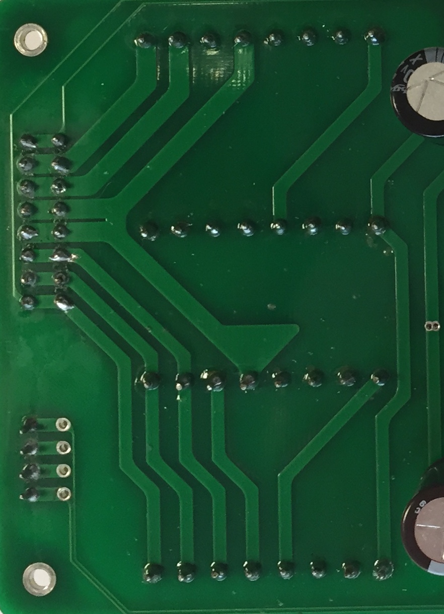

There is a manufacturing trick I recently saw on some China-made small output transformers that seems to work wery well. Appj uses it at least on smallest amplifiers. They start with a standard off the shelf PCB mount former with 16 lugs (8 per side) and central divider. This is the one you usually see on consumer electronics power supplies, RFI filters etc.
They interleave 4 windings on each section of the bobbin: primary-secondary-primary-secondary. The end of each winding is individually tied to one lug. They then connect in series the windings on the PCB. The 8 ohm output amplifier tap will use all 4 secondary sections, the 6 ohm tap will use only 3, and the 4 ohm will use two. When you use all 4 secondary sections, the result is good; on my amplifier is better than Hammond 125ASE. The manufacturing is likely automated because there is almost no difference to a conventional multiple outputs switching transformer and the result is cheap to manifacture; it is also fairly easy to rearrange the connections and change impedences. It would be an ideal transformer for small amplifiers.
That cannot be a good choice for quality transformer. It will have a lot more leakage in comparison to a symmetric geometry like 1/2secondary-primary-secondary-primary-1/2secondary for example.

Both solutions are ok. I prefer to start and finish with primaries as I have always found this solution having less shunt capacitance. It could be related to how I make the transformer however Lundahl does start and finish with a secondary. You can have both primary or secondary as an outer winding. It is the distribution of the turns + windings and the symmetry that matters.
In the two cases above:
1) primary-secondary-primary-secondary
2) 1/2 prim.-sec.-prim.-sec.-1/2prim. (or 1/2sec-prim-sec-prim-1/2sec. like the Lundahls)
the average mmf (magnetomotive force) is the same however in case 2) is more evenly distributed than case 1).
So case 1) will have significant more leakage inductance.
The more windings the more evenly the mmf is. That's why leakage inductance decreases...
