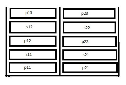

Hi, I need some advice. I have a pair of custom made output transformers for a push-pull amplifier with the following arrangement:
The bobbin is horizontally sectioned in two halves. Each half has the P-S-P-S-P vertical windings. I am planning to connect six primaries in series (center tapped where B+ goes, maybe also an UL tap), and two secondaries in parallel, and then those parallelled secondaries in series (center tapped for GND). So P-P-P-CT-P-P-P and S||S-CT-S||S
If I give a numbering for each winding , it comes:
Section A: core side - P1-S1-P2-S2-P3 - outer side
Section B: core side - P4-S3-P5-S4-P6 - outer side
My question is: how shall I connect the individual windings for the lowest leakage inductance and best symmetry?
Anode1 - P3-P2-P1 - B+ - P4-P5-P6 - Anode2
or:
Anode1 - P3-P5-P1 - B+ - P4-P2-P6 - Anode2
or the same arrangement but P3-P1 swapped and P4-P6 swapped, if it does make any difference at all.

Isn't this one of those cases where a picture is better than a thousand words? If you can draw it, annotated with the resistance of each of the seperate windings, would that help?

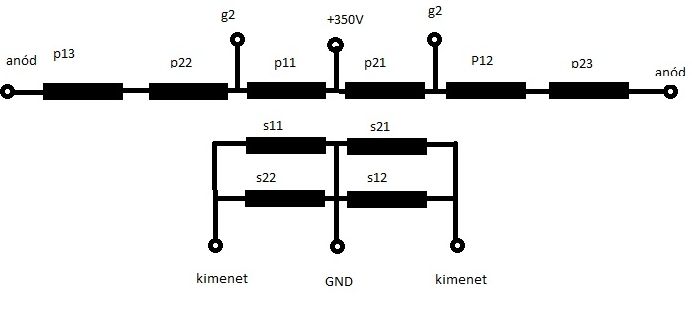

You are right. Attached is a sketch of a possible connection of the individual windings. Note the numbering is different from my initial post.
What I am not sure: would it be better to simply connect p11-p12-p13 in series, and similarly p21-p22-p23 in series? Also s11 and s12 in parallel, similarly s21 and s22 in parallel? On the attached diagram I made cross-connection between the sections, does it make sense? Or just keep it simple.

Has anyone played with litz for the secondaries? Haven't done the math, but it seems like this would be a good place for it.
I would cross-couple the primaries. If we think of the order of the signal like this -
1st vertical section
Plate1 ; P1,P2,P3 ; B+ ;
2nd vertical section
Plate 2 ; P4,P5,P6 ; B+
I would then connect:
Plate 1 - P1 + P5 + P3 ; B+ ; P6 + P2 + P4 - Plate 2
This optimizes class B operation, where only one tube conducts and half of the primary is used. Not only it reduces primary1 to primary2 leakage, but primary to secondary leakage.
P.S. You should cross couple the secondaries as well.
P.S2 Is your second halve symmetrically wound? (that would require windings in the other direction).
P.S3 Let me know if you need technical analysis on other wiring options.
Thanks for the advice. I still don't understand why does the cross-connected primaries and/or secondaries version reduce the leakage inductance.
My transformer is not symmetrically wound. You mean symmetrical by starting each section at the outer edge and going inward? No, it is just wound left to right (first layer) in both sections without turning over the bobbin.
The wire length of the secondary s11 between the primaries p11 and p12 is shorter than the wire length of secondary s12 between primaries p12 and p13. So the DC resistance of s11 and s12 is different. Can I still connect them parallel? (Or s11 parallel to s22, s21 parallel to s12, that is an inner secondary parallel with an outer secondary).
1. So to make this clear with a simple example, if you were to connect both halves, you would do top-bottom-top-bottom, or vice-versa?
2. As for leakage, consider that in class B only half of the primary generates flux, while the other tube switches off. To achieve best coupling, you need ALL secondary layers in proximity to this half primary. As another simple example, if your "half primary" is located in one vertical section, it will have low leakage towards its layers in the same vertical section, but high leakage towards the layers of the neighboring vertical section. Remember your secondaries constantly work together and do not switch in halves.
Hello, thanks again.
1. I don't understand this. I will connect both halves. There will be 2 secondary windings paralleled, and this in series with another 2 secondary windings. Let's call the sections A and B. I will connect A bottom and B top parallel, and A top and B bottom also parallel. Then these two in series (see my previous picture).
2. This makes sense, I will connect the primaries as you advised.

1. Makes sense. My advice is to cross couple secondaries as well. From my recommendation, something like this:
SECTION A: P-S1-P-S2-P
SECTION B: P-S3-P-S4-P
S1 // S4 ---- S2 // S3
OR
S1 ---- S4 // S2 ---- S3
// stands for being in parallel with ; --- stands for series connection.
IF WE ASSUME all secondary layers have equal turns.
