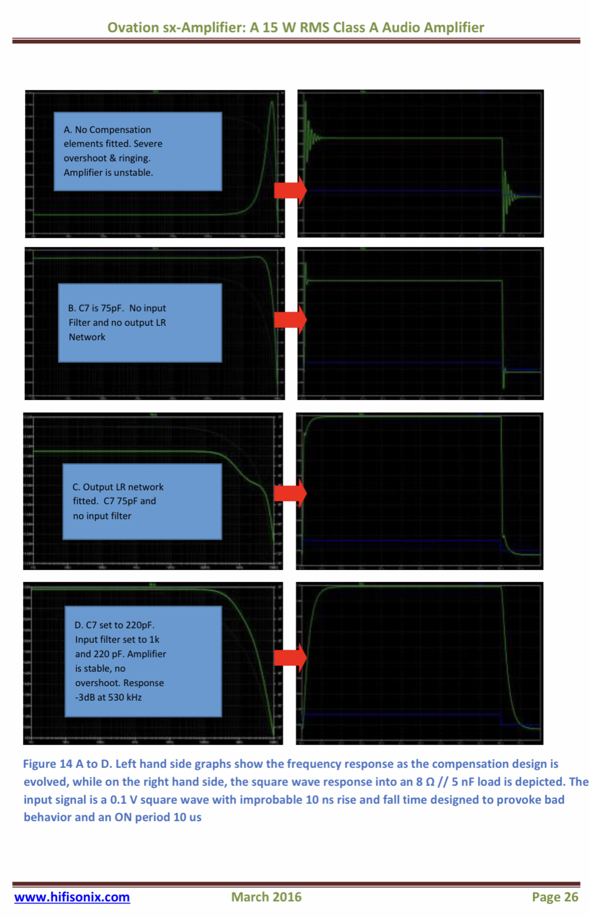

Agree that the square wave test is a powerful tool for assessing stability with various loads. I always do this as part of the comp design.
In the sx-Amp (classic CFA design) write up there are some LTSpice screen shots as the comp design is evolved

Settling time is not that important, i.e. not a parameter to optimize. This des not mean square waves are not important. As Hans and Bonsai point out, they are important to measure stability.
