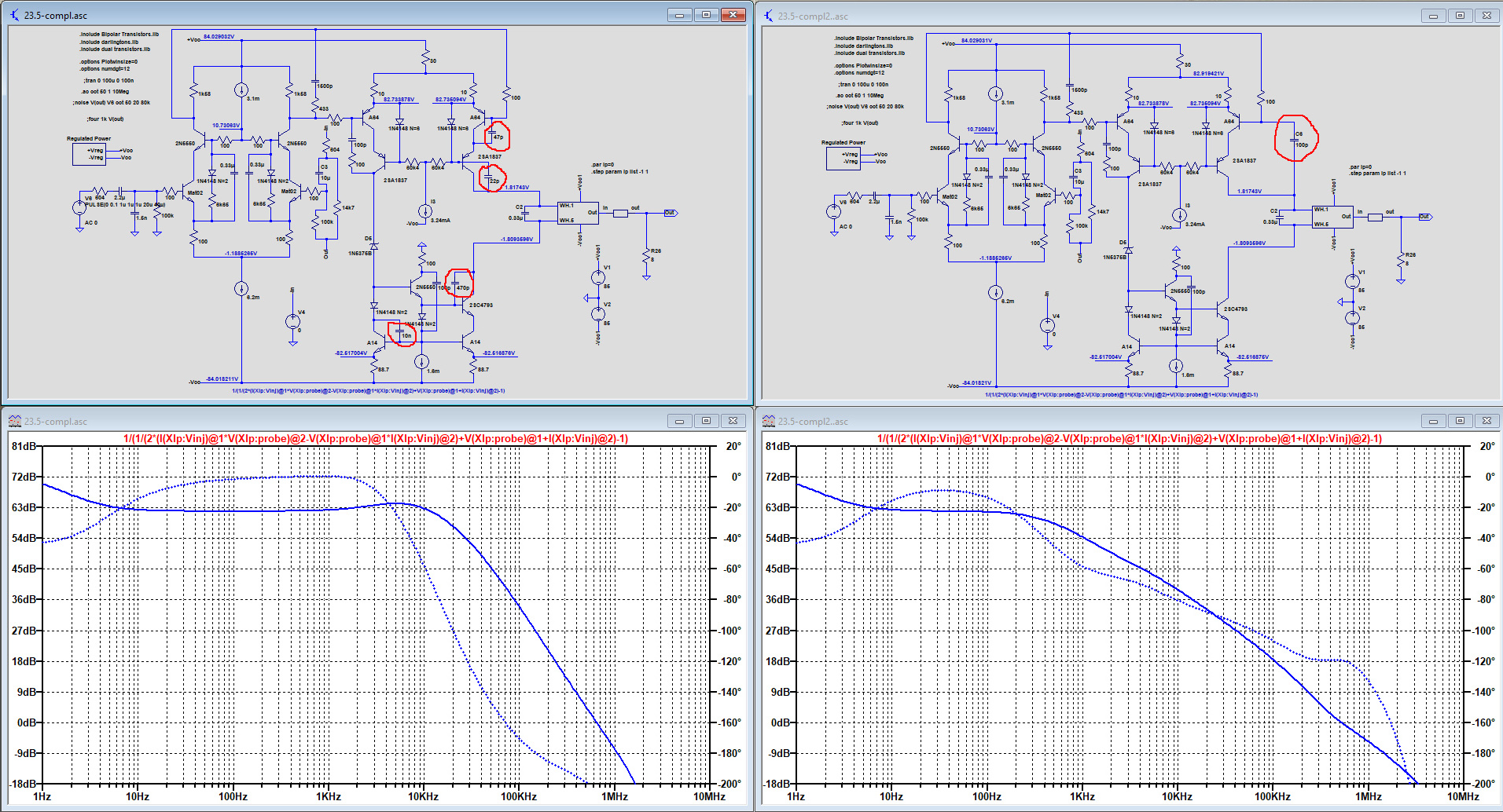

Damir,

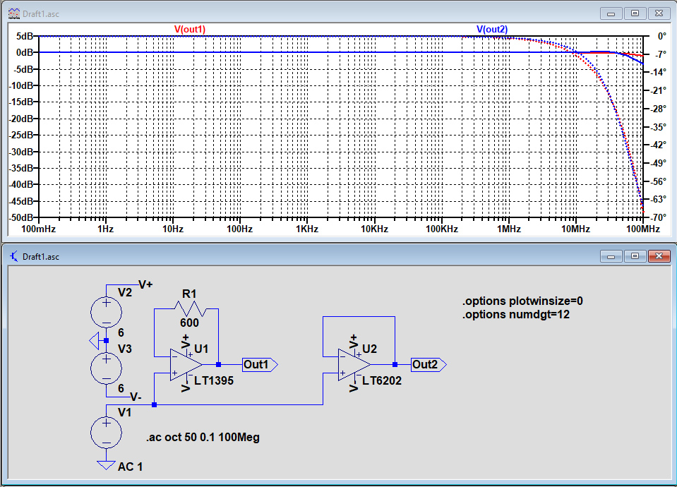

I mentioned that with main amps LTSpice can give results that are hard to understand.
For that I mentioned a Mark Levinson 23.5 Main amp.
While repairing this amp, I could not get a stable model in LTspice, although having the official Madrigal document, see pdf below.

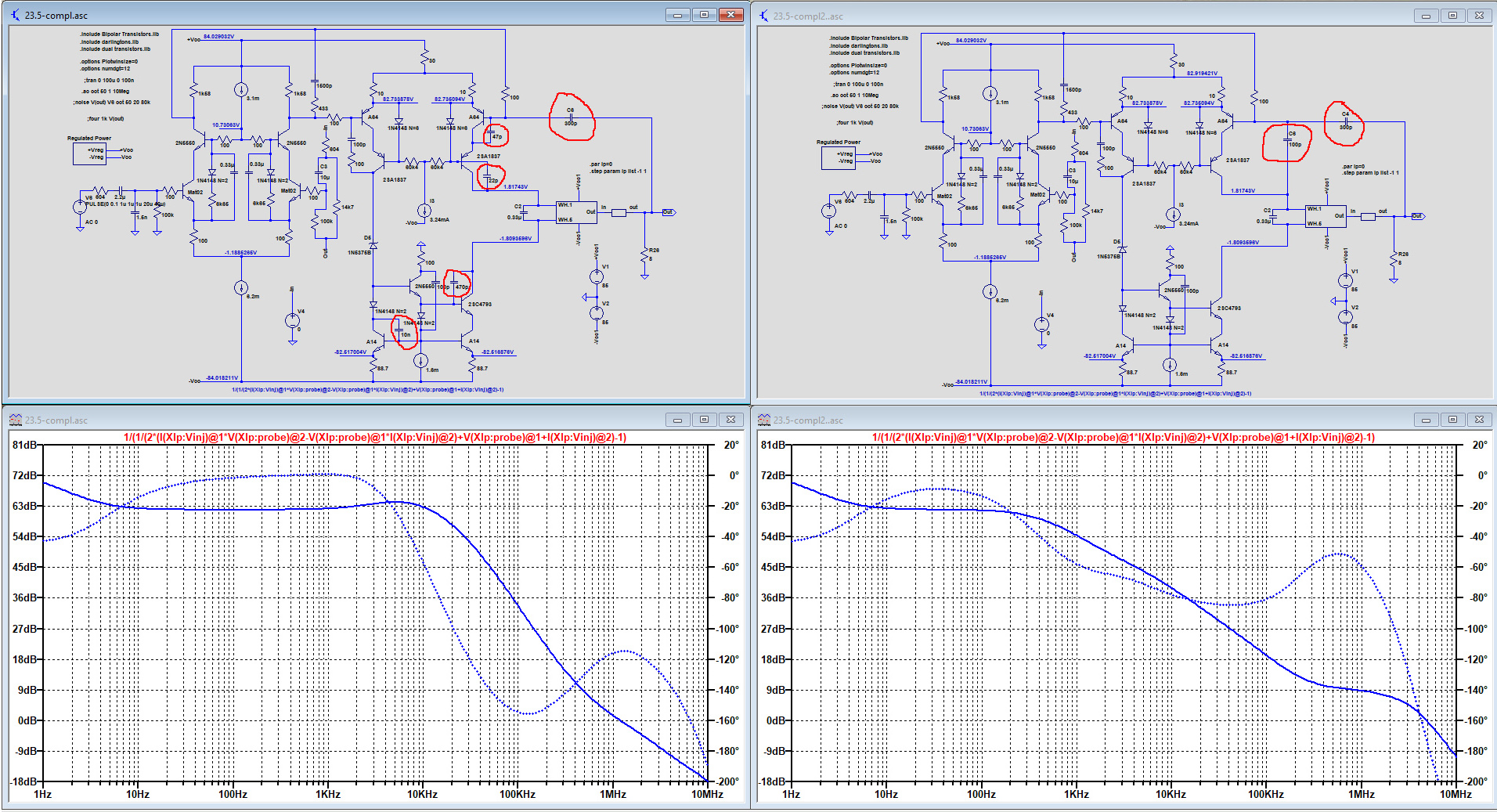

In the first image below, you see at the left the circuit diagram from the official documentation with four compensation caps encircled in red.
Below the circuit diagram you see the loop gain belonging to it, clearly indicating an unstable situation.
So I checked the PCB and all component values and they fully seemed to confirm the official circuit diagram.
Because I had to repair the amp, I first took out those 4 caps and replaced them by a 100pF Cdom around the VAS, see right part of the image.
The loop gain in LTspice confirms a stable situation now.
After having repaired the amplifier still with the 100pF Cdom, I compared it to the other channel that was still intact and in original state.
And of course this channel was absolutely stable as expected but only with those 4 caps as in the original documentation.
Behaviour between the two channels was quite comparable in THD and for square wave response, a complete mystery.
Then I tried to get a stable amp in LTspice starting with the original diagram.
This was possible by adding a 300pF cap from output to VAS input, the loop gain now showing >40 degrees phase margin.
When somewhere this cap would have been physically there but not in the documentation, It would still be there in my simple version with the 100pF Cdom.
But adding this 300pF cap to my simple Cdom version, results in an unstable amplifier but also the 0dB loop gain is now at ca 5Mhz instead of the measured 350Khz.
So this cap is definitely not there.

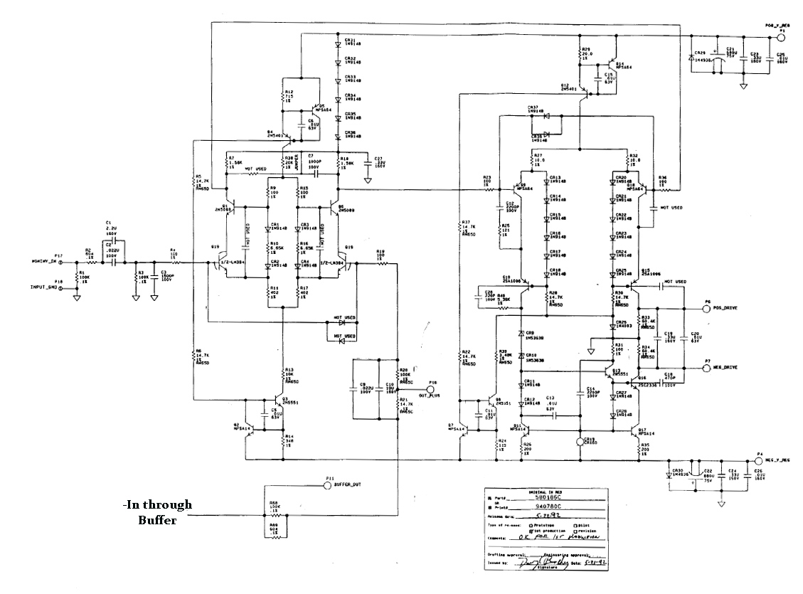

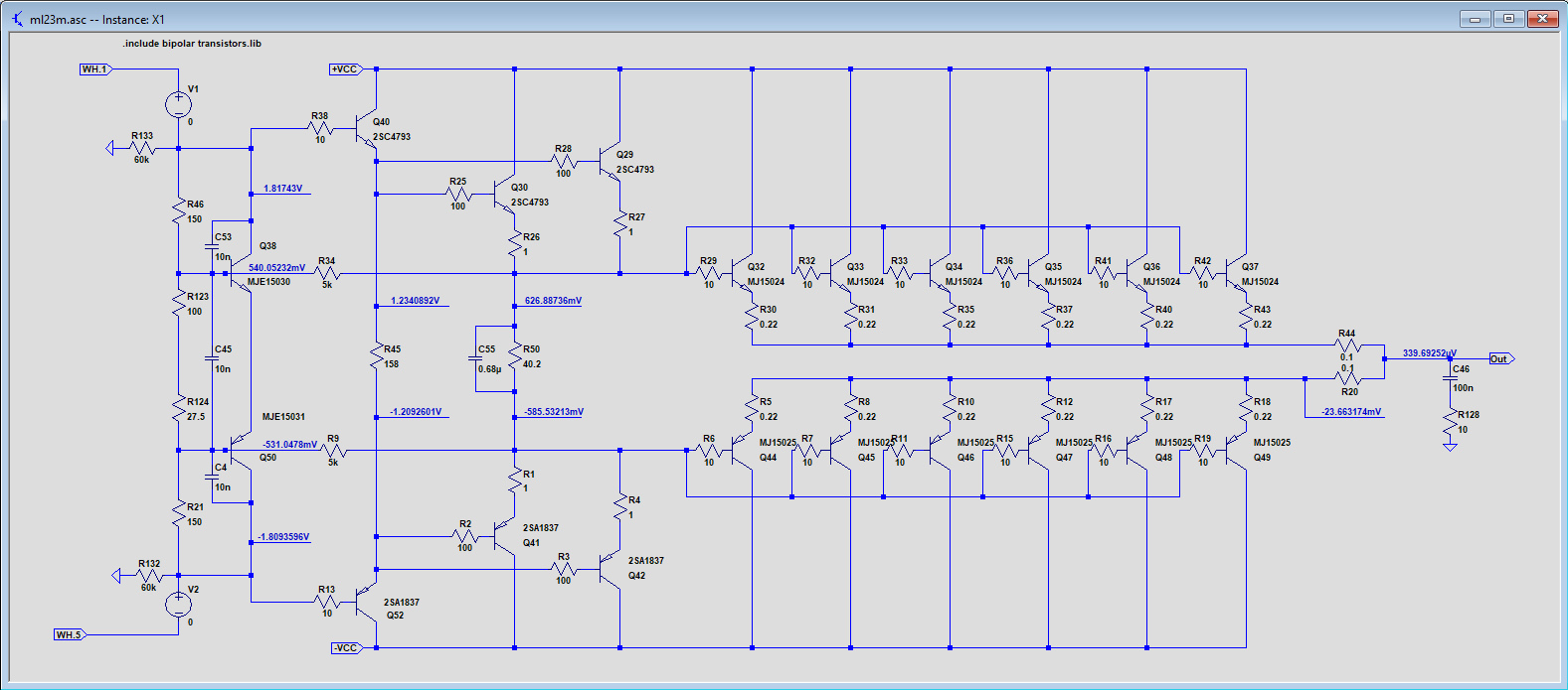

For completeness I have added the three stage emitter follower output, which is simple and straightforward.

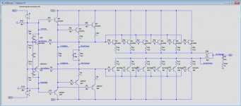

Last but not least, I can mention that the smaller ML27.5 brother is almost a copy , but with only four TO3 pairs instead of six and with a lower supply voltage, see fourth image.
The compensation is even simpler without the 22pF and the 47pF of the ML23.5.
There are several possibilities:
1) LTSpice is confused by this compensation and gives a wrong outcome
2) There is some undocumented component mounted, but despite all effort I can't find it.

Damir, thank you for answerring.
The OPS was of course connected, but as a subcircuit.
It was the little rectangle before the loop gain probe, that’s why I showed it separetely in the third image.
So this simulation represents the whole amp including 8R load.
Point is as explained, that with a single pole compensation everyting works as expected.
Even TPC can be succesfully applied without a problem.
But not at all the strange compensation that ML applied.
I still can’t find any error in what I did.

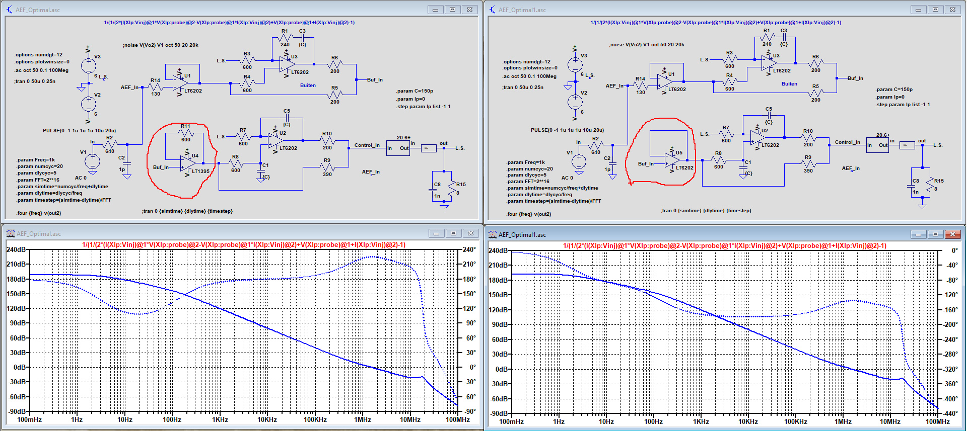

Look at the first image below.
Two 100% identical circuit diagrams with one difference:
Left one is using a fast LT1395 CFA buffer and the right one fast LT6202 VFA buffer.
Looking at the loop gain, one would think that the left one is highly unstable and the right one not.
Phase versus frequency is completely different between both.

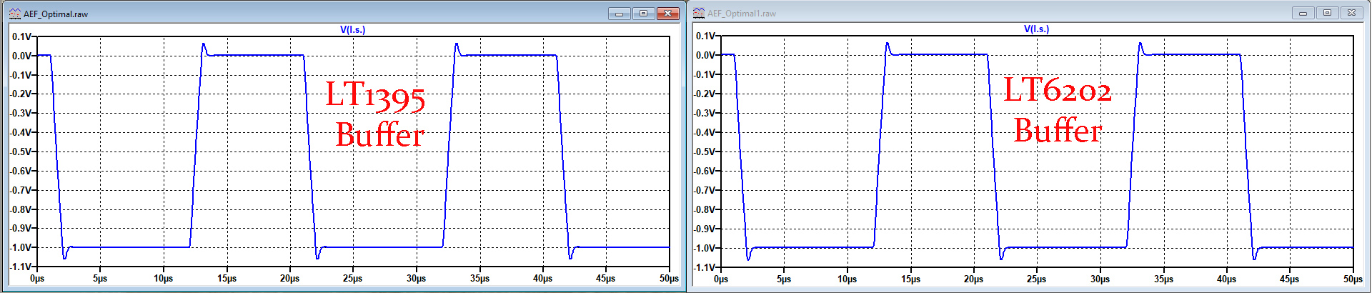

Now putting a square wave to the input, gives exactly the same response at the output, because as expected both are 100% functionally equal but LTspice reacts completely different in the first image.
The third image confirms that LTspice gives almost identical responses for the LT1395 and the LT6202 op-amps including their phase behaviour.
Just another mystery, true ??
Hans

A simulator problem cannot be excluded. What is really weird is that you got this problem during an AC analysis, which is essentially a linear problem. Linear systems have a guaranteed unique global solution, and while numerical rounding and Newton Raphson SOR convergence issues cannot be excluded, it is very unlikely they occur.
For DC and Transient analysis, this issue is a classic. The non linear problem to solve may have local convergence minima, and the solver may stubbornly stick to these, instead of looking for the global solution. At Cadence we even had some test cases for this behaviour, the software solution was to add some numerical noise around each local convergence point and see if the solution is stable, kind of noise modulation in the numerical domain.
No idea how ltspice works and if such issues are possible, I would try to change component values by small amounts and see if the solution jumps around. I would also take a look into the op amps models, some behavioural models are inviting such issues, since they use synthetic ideal elements, some time with little care for details like very high impedances in series or very low impedances in parallel.

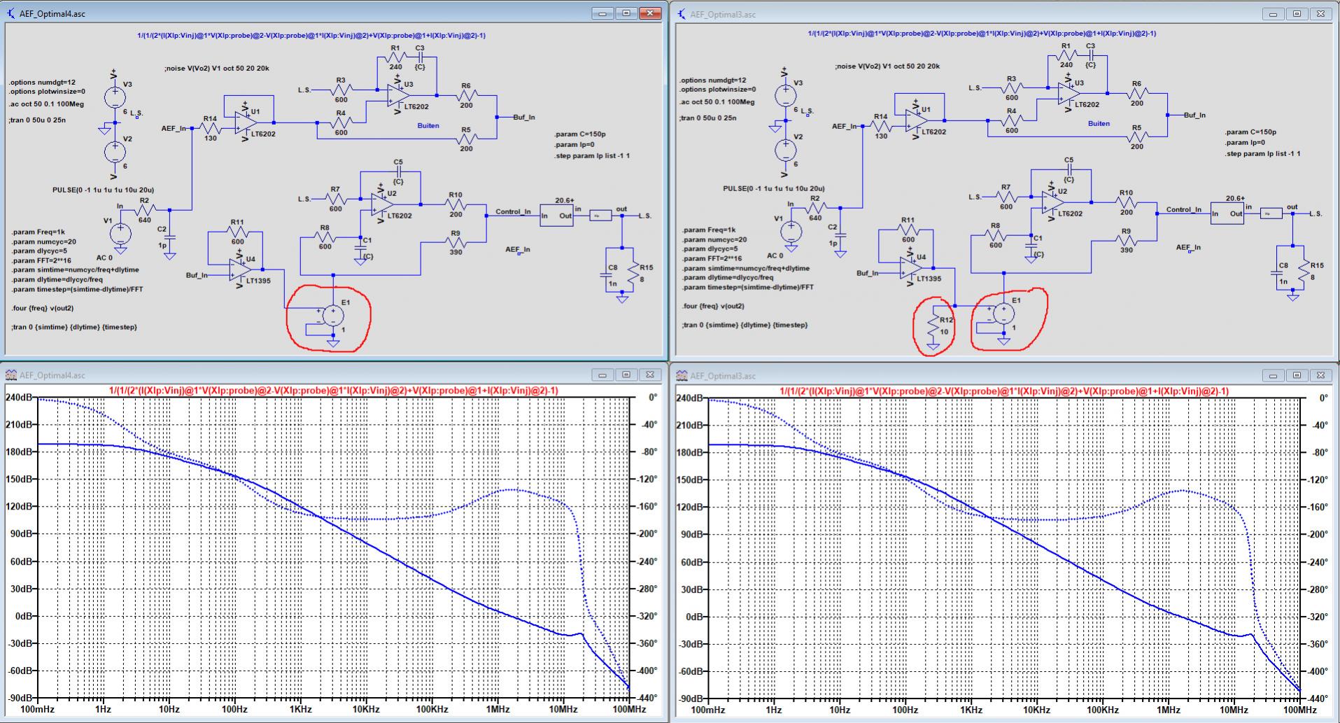

I tried a number of things around the LT1395 buffer.
Placing a VDVS in front of In+ to eliminate the source impedance made no difference to the earlier shown weird phase results.
But using a VDVS behind the LT1395's output resulted all at the sudden in a correct open loop phase behaviour.
Adding additional load from 10R up to 10Gig to the output of the LT1395 made no difference at all.
See both versions without and with load in the image below including the VDVS, both now with correct phase behaviour.
Source impedance of the buffer's input seems to play no role and loading it's output neither.
Here is some magic at work that I can't explain.
Either there is something very weird with the LT1395 model, or LTspice get's confused by whatever reason.
