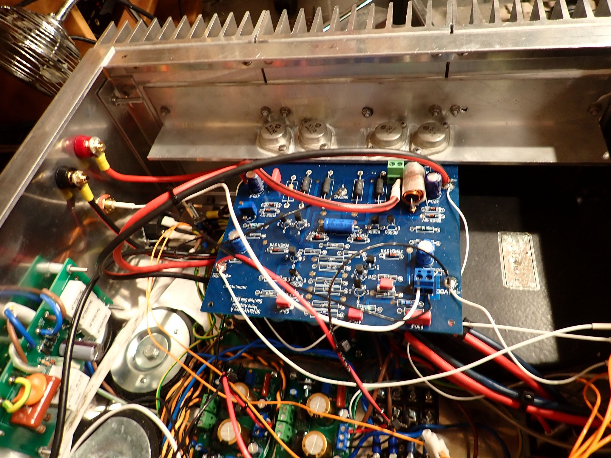

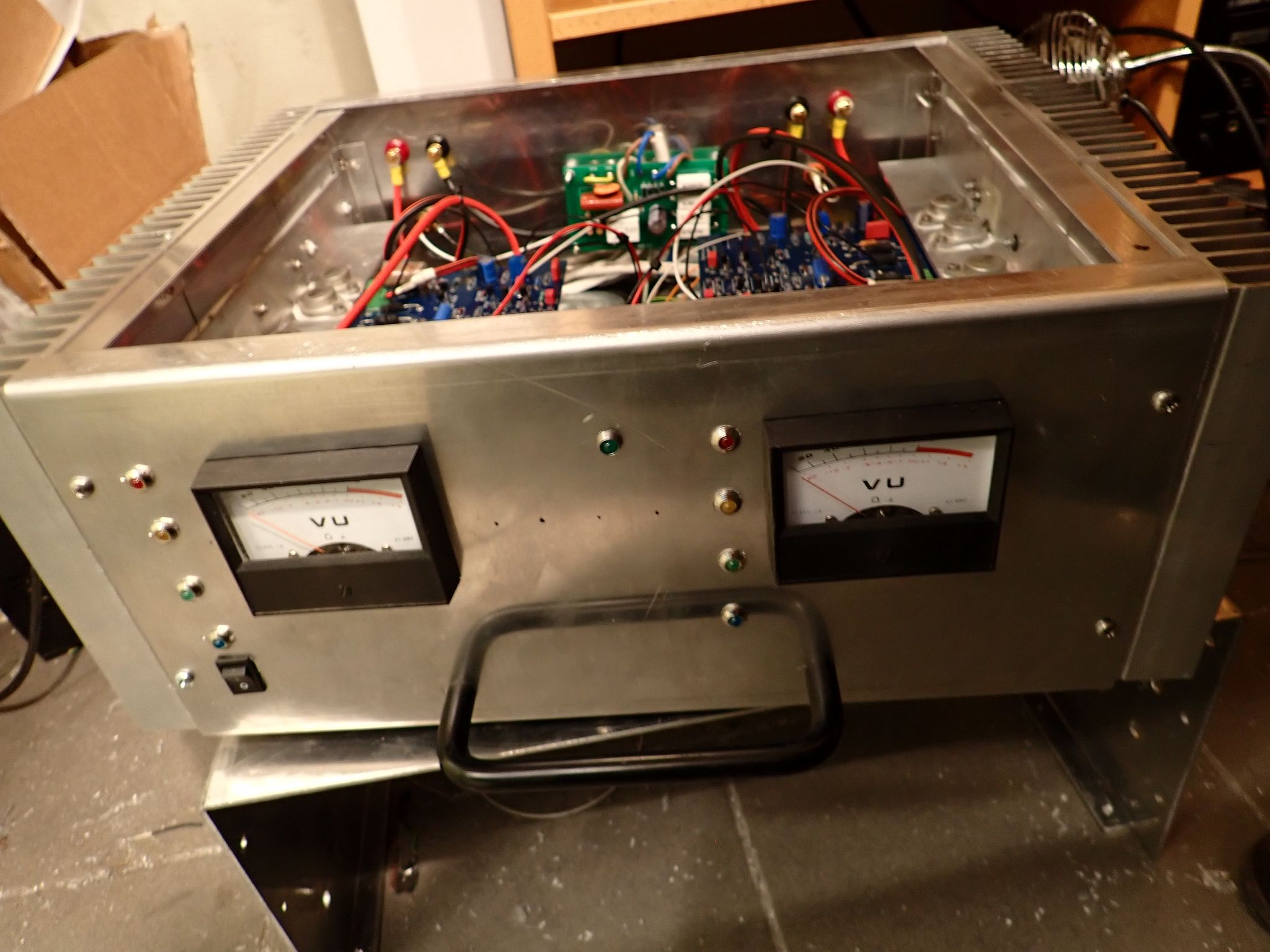

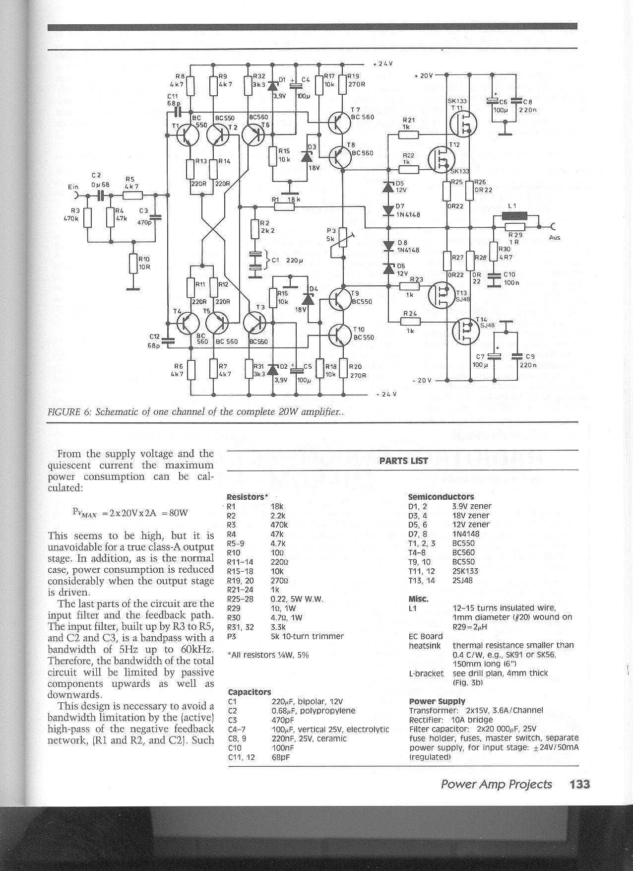

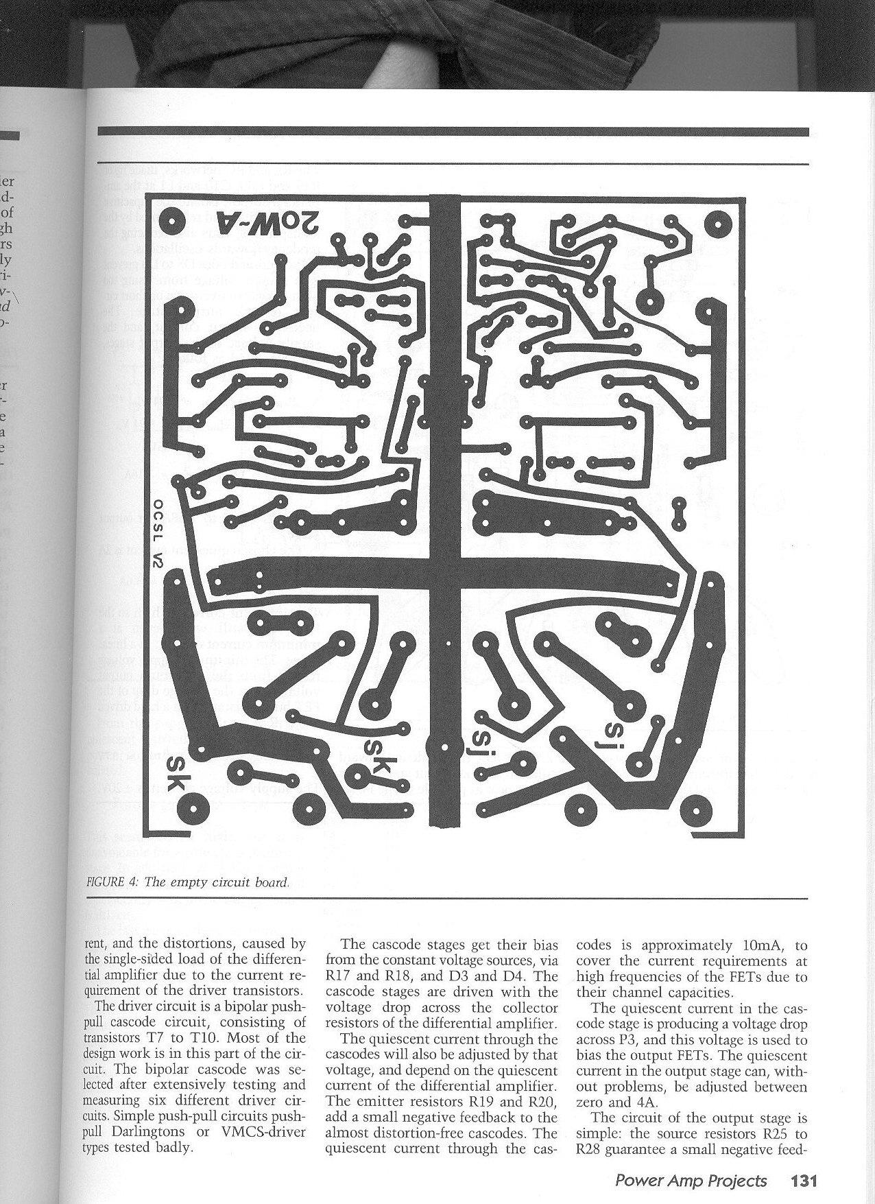

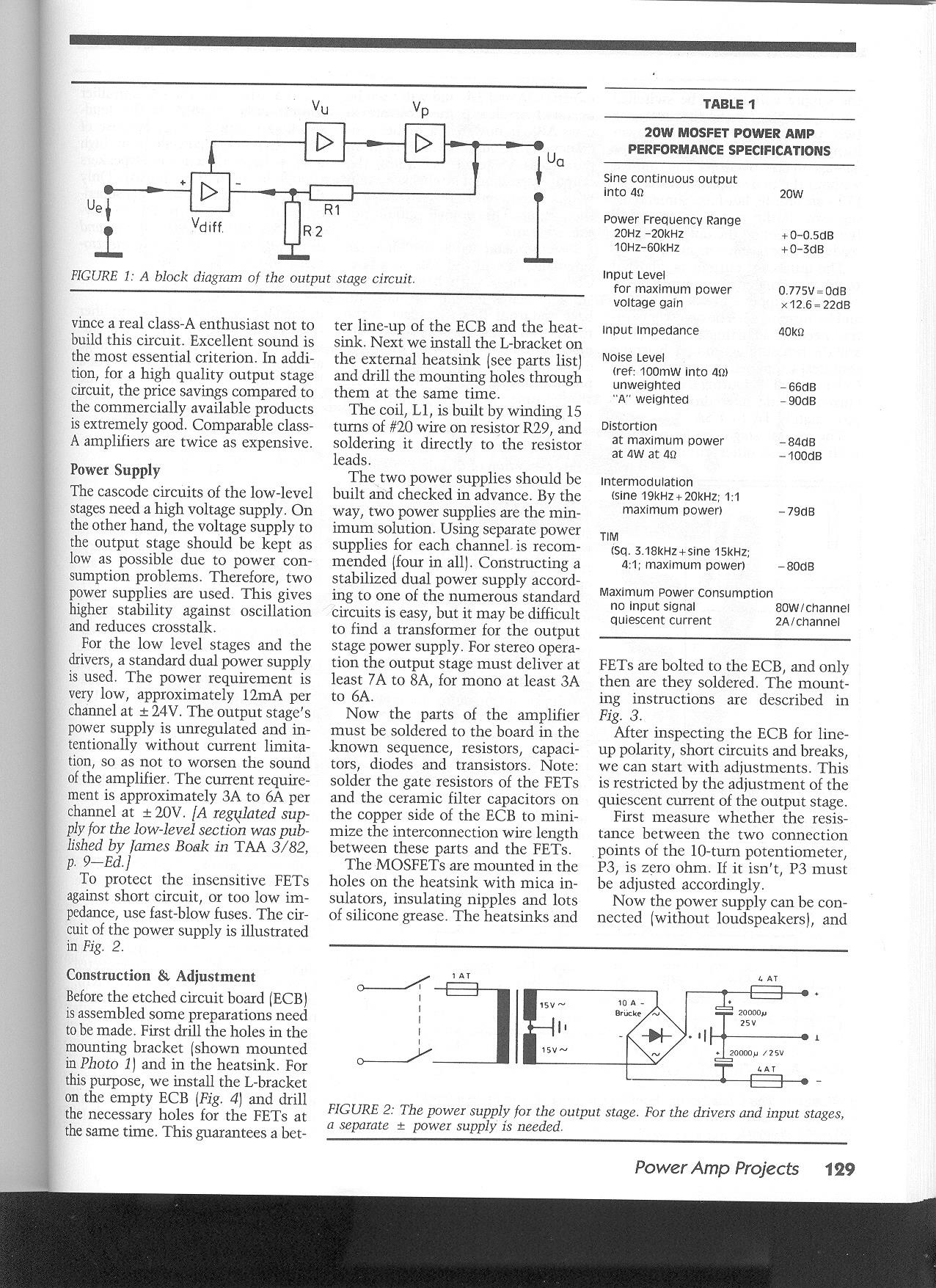

Hi everyone. Having built 3 Lang 20W class A amplifiers, after finishing the 4th, during the final measurements, the dc offset is 7mV at the right channel and at the left is -25mV. In all the previous amplifiers the offset voltage was between +5 to +13mV. The only difference among them is that instead of +-20V regulated voltage supply, +-28V unregulated power supply which I think it is not a big deal. My worst problem has been in matching the BC560C. i have bought 100 of them and their Hfe was below 600 except of 2. So While all the BC550C were from 600 to 612, I have placed the only 2 BC560C with Hfe 600 at the differential amplifier and the rest where it has been needed to. The quiescent current was set for 2A as per the instructions of the article. I use separate toroid transformers with 2 separate secondaries 2 X 20VAC/8A and 4 X 6 X10.000uF so every negative and positive voltage use 60.000uF each. All the components have been purchased by Mouser except the BC560C. The output waveform are clean and undistorted at 1Khz/4V input from the wave generator. Do you think that those difference will affect the fidelity of the amplifier and if yes how can I fix it? Check the attached files for every helpful detail. Thanks a lot in advance.

There is also a basic DC unbalance in the input stage. The input side base currents flow through more than 50k (47k + 4.7k), while on the feedback side it's 18k. That makes matching the transistors pretty much useless for DC offset.
Change the input side 47k to 12k and it'll probably all improve. And 12k is still a very nice input impedance.
