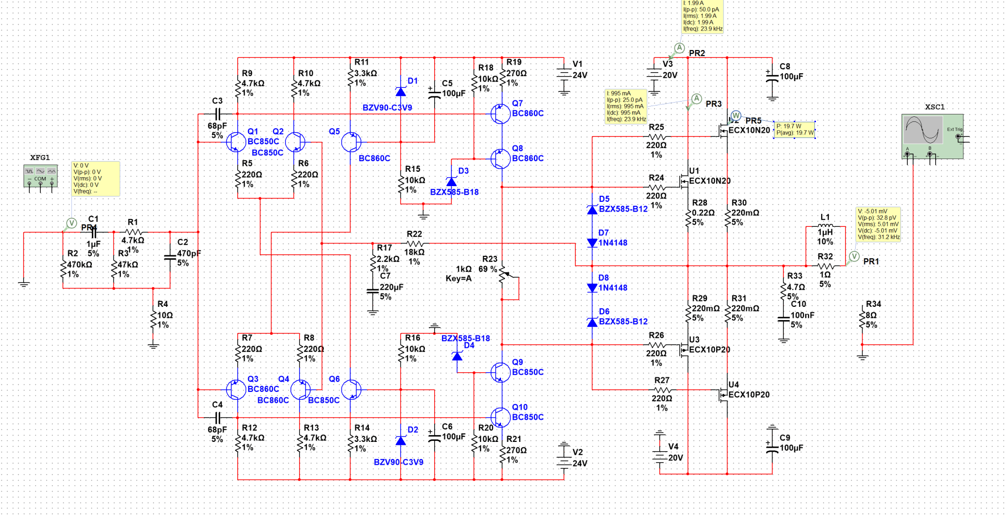

Hi @metanastis
I would like to build lang and Axl class A amplifier.. I have 10 pcs ECX10N20S and ECX10P20S Exicon Lateral mosfets.
Could you give me some advice?
Mosfet must be matched?
Lang bias is 2A? AXL is 1A?
Which amplifier have good sound?

sercan85
Having built both I can declare that Lang is slightly better and more powerful than AXL.They have a very good sound both. There are surely some other amps that play better.
If you want to use the exicon mosfets, you must make a couple of modifications on the output circuit.
HerrFlick is the guy to ask as he has used them in his amps.

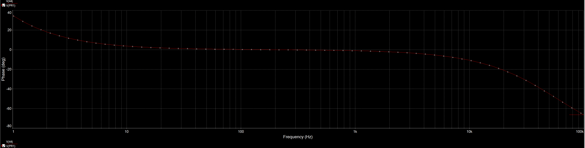

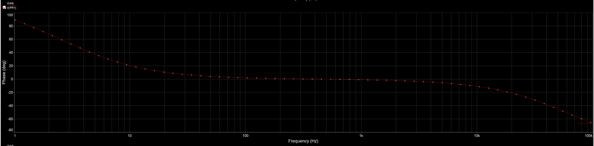

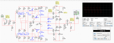

Lang ampifier works on simulator perfect.
ac sweep test are showed, there are better phase line with 10uf input cap. I need to compare them on listening test.
