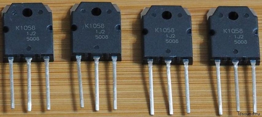

I like this amplifier, I will modify the existing (I will draw a) layout (actually I working on it right now) to these amp, using 2SK1058 & 2SJ162 from Hitachi. Now days hard to find the metal case MosFets, even if you get some very likely fake, replica of aftermarket. Exicon still sell LATERAL mosfets, I prefer the sound of those over the old Hitachi.

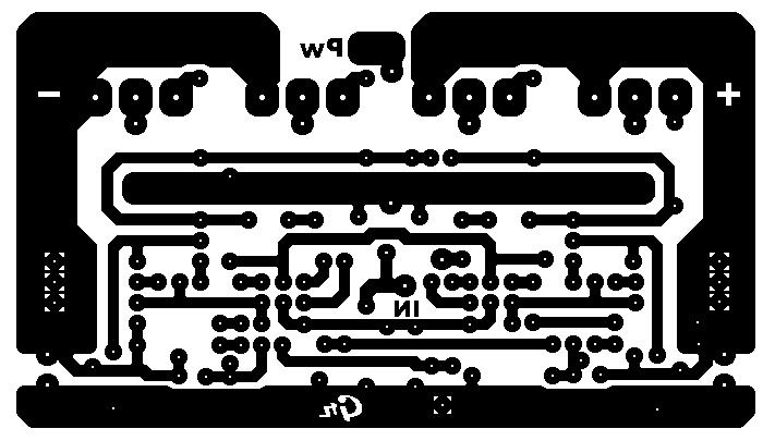

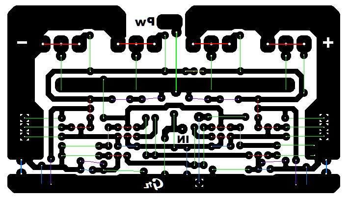

I just finished drawing the Layout for this amp. I use computer paint via hand to draw the layout. I had the Sprint but I never learnt how to use it.
Now days I really do not want to learn it because no one can stop me to build amplifier.
I saved this amplifier schematics many years ago but I was not sure about it. Now I see you build it I think I may give a try,
I have most of the parts at home for a test, who knows.
My printer out of ink so I did not print out the layout! It should work but if someone willing to double check it before somebody decide to use it.
The layout for DIY home brew PCB s.
I used color coding for the parts
Green = RESISTORS
Blue = Capacitors (both type)
Red = Semiconductors
Grey = Jumpers
Purple = Diodes
Yellow = Trimmer
Any question please ask.

Hi
The layout I just posted is the one from Mr Lang the same one you built! I draw the layout for a 2SK1058 & 2SJ162 MosFets.
This one is similar (I mentioned before) from Jean Marc, but it is not a Class A it is a Class B operational.

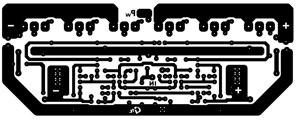

I finished one more Lang Class A amplifier layout for 3 Pairs TO3P type Hitachi / Renesans or Exicon power MosFets.
Mirror imaged already ready to iron transfer.
This was my last draw (I hope)!

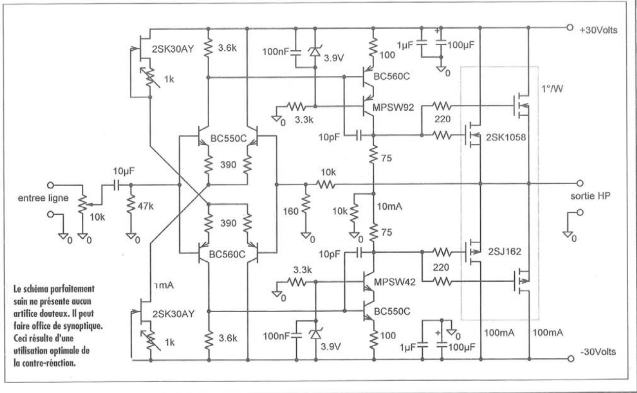

This still will have relatively high offset due to DC impedance imbalance in the two input sides, as I mentioned for the circuit that the OP posted.Hi

You guys like DC offset? ;-)
Jan
No, certainly not, I do not like offset but it is easy to deal with that if I build it, just need to ad an extra trimmer pot and replace one side the TWO Pc 4K7 resistors with a lower value.
What we can read from metanastis posts a few mV DC offset that is not high, not at all.
Most of Class A amp I built they have some DC offset. A few mV does not make any difference if is stable.
Again it is possible to deal with it if is higher that 100mV or so.
Many Class A amp has some drift at warm up also, to measure that I have to build it or ask metanastis to measure it in cold and after 1/2 hour warm up.

My first amplifier was the elektor AXL 2X16W in 1989. Since then that amplifier has played superbly in many parties as I am a ex-DJ. Its offset voltage was around 16mV. The construction article of Elektor have said that measuring less than 50mV is OK. Most guys in this forum have the same opinion. So what really is the big deal with a small offset voltage??? Off course there are some project which deal with it using a circuit with a trimmer to eliminate it.That's all.
My measurements on that amplifier were done after 15 minutes warming up. Both quiescent current and offset measurements were steady for about an hour because there was no reason to check it any longer.No, certainly not, I do not like offset but it is easy to deal with that if I build it, just need to ad an extra trimmer pot and replace one side the TWO Pc 4K7 resistors with a lower value.

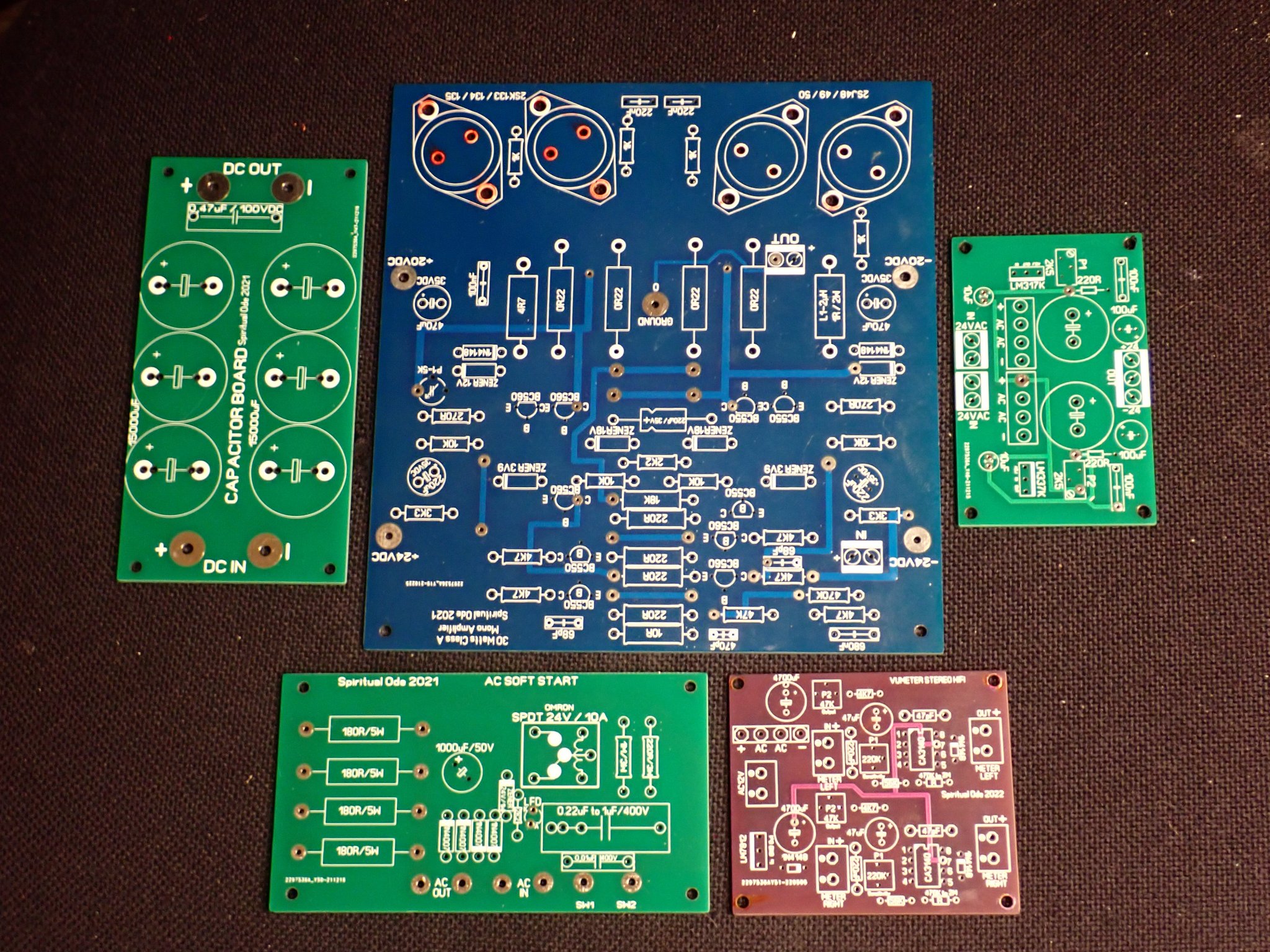

Here is the pcbs for one channel ( Amplifier board /capacitor board for the final stage/ +-24VDC adjustable power supply for the input stage / Soft start board / VU meter board),I have made via sprint layout 6.0 and have been manufactured in China. One capacitor board is missing for the negative voltage because I have used all of the rest. Please take a look.
You got a nice set of PC boards for this project. 🙂
The only reason I will use my layout because I already has the plastic case power mosfets from Hitachi.
My layout is 100% finished, very soon I will have to etch PCB-s for other projects, a the same time I will do this one to.
Plan to test it with 24-25V DC rail voltage. I have some 20 VAC 650 VA toroidals at home.
3 pair power mosfet 1.5A biased to Class A it is plenty for me. 😎
