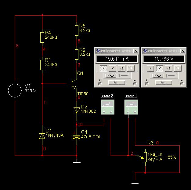

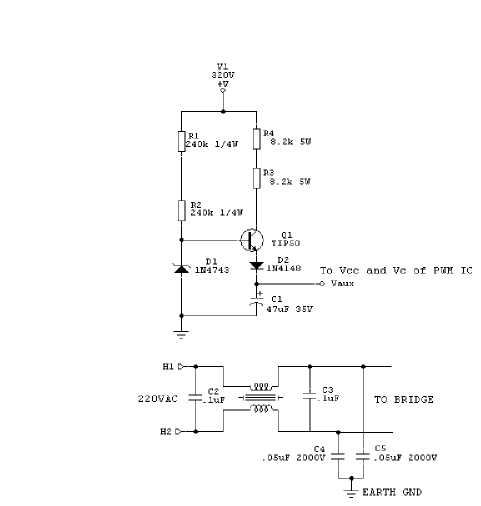

The idea of the startup circuit is to supply up to 15ma so the PWM chip will start. This done by the 47uF bulk cap and the circuit I posted is designed for the MC33025 but should work for the 3535.
If you refer to the schematic I posted this is how the values are derived:
R1 = R1 & R2 in the print R1= Vin (min) 252 to 300volts - Vzener/ Izener(min)
R2 = R4 & R3 = Vin(min) - Vzener/ Istart
The transitor is choosen with a VCE >> Vin(max)
I have simulated this circuit and it's output is about 11.0 volts allowing for emitter-base diode drop + the 1n914 drop 13.0 - 1.4
with a startup current of 10 ma. the reason there are two resistors for R1 & R2 is safety (voltage breakdown). This information is from Marty Brown's book and not mine.
I have not confirmed that this is sufficent for Sg3525 startup.
If you can you should aquire a copy of Marty Brown's book, it has a lot of examples of every part of SMPS design and covers all topologies including PFC and most important how to compensate a SMPS properly.

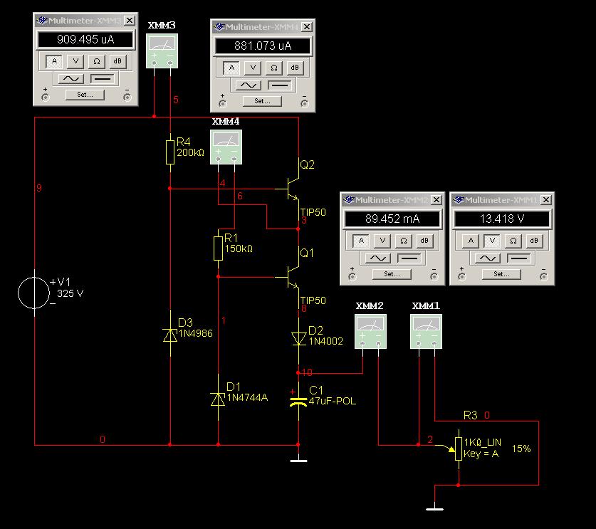

Supply current for SG3525 is 14(20mA-max)@35v and less than 1mA for IR2110
At home I have simulated start-up circuit that had two TIP50 in series.First was set to drop bulk voltage down to 165, then the other one drop voltage down to the one needed (12-15v).

Luka- I agree. BTW, I went back and recalculated my #'s for the 2 - 8.2kW 5W resistors. You are right in that, at low line, it is good for just about 20mA. Duh!
Having gone back and re-read the datasheets from ONSemi for both the SG3525 and the MC33025, the big difference in the start-up is that the '33025's start-up current is something like 500mA and its operating current is 25-35mA. By contrast, the '3525's start-up current is its full operating current, 14-20mA. Therefore, this start-up circuit is mandatory for the SG3525, but you could get away with just the high-value resistor to charge the 47mF capacitor, but the "highly-starved" linear regulator gives better control of the start-up process.

Luka- I never thought of cascoding the TIP50s for increased current capacity. Looks interesting. Tested it yet, or just simulated?
