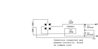

The value might be ok depending on your load requirements,
as an example:
switching freq (Fs) = 50kHz
Voltage rail to rail = 80 VDC (+/- 40VDC)
Load current (iL) = 8 amps
Then inductor value would be about (.5 * 80VDC *(1/50kHz) / 8)
my calculator comes up with 100 uH. If you divide that by 2 then you have 50 uH in each rail (+/_) and it is important that they be wound on a single core using bi-filar winding. I wind my own and therefore I tune them by adding or removing turns.
The procedure I use is with an inductance meter I wind turns until I am close to the calculated inductor value and I leave about 4 to 6 inches of wire and connect my inductor to circuit and load test supply using a 400 watt amp I have if things seem ok fine, if not I add or remove turns until amp performs ok. Then with o'scope I check all waveforms under load conditions and then with my DIY load switch I step the load to verify the feedback loop.
As for your question about gauss and telsa it depends on what side of the pond you live on Japan, EU, USA. Just depends on the measurement system you use but they are the same.Read the first few chapter's of Marty Brown's book, he explains it and also shows example's of the different forms for the calculation's.
I have added a picture of the outstage.

I am currently doing/building buck converter 42v --> 13-14v, to see how the inductor will respond,waveforms,spikes,...
Then I'll finnish offline one,but I still don't know if my output inductors will be on one core, I guess they could be.
PCB wasn't designed that way, but there won't be any problems.

You can use separate inductors, but its is best to use a common one. Inductor value is dependent on input and output voltages so the value for your buck converter will be different than the one you might use in your supply, refer to page 46 of Brown's book.
The formula is below:
L(min) = [Vin(max) - Vout] * T(off) / 1.4 * Iout(min)
Vin(max) = VDC at input to inductor (usually 2 * Vout)
Vout is output voltage
Iout(min) = min load current
T(off) = about 30% 1/fsw
t(off)
I am not sure what the 1.4 constant includes, but you are correct
that t(off) can be calculated as:
t(off) = 1- (Eout/Ein) / 2 * fsw
I was pointing to a reference in Marty Brown's book for his method for calculating output inductor value's and this is not necessarily the only method.

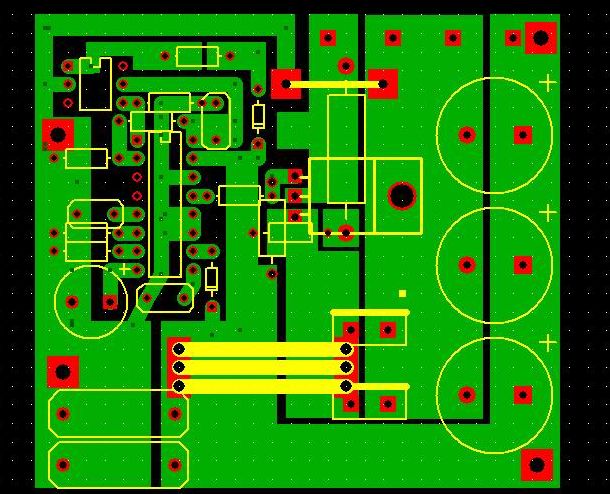

Thanks for the posts about the grounds, The schematic I posted was my design and the ground symbols are not identfied by intention because EU & Far east grounds are different and is left up to the individual to determine the proper grounding for the country that you reside in, if I had indicated the grounding that I use then we would have to describe PCB layout and other items. This is a design that is more or less a copy of an existing working SMPS with a few changes and the PCB layout was my own and has been assembled and is being tested at the present time. I have it powering a 250 watt amp and the listening test is great with full sharp tight bass and no other notable problems. I have however changed a few things and when all doc's are finished , the project is completed I will post the results for anyone who is interested.
Sorry for the confusion, the ground symbols are from my drawing

If you see my PCB you will notice in the layout that the input power has its ground, the bulk supply has its ground and the output along with the pwm control is grounded using a large ground plane (copper pour).
