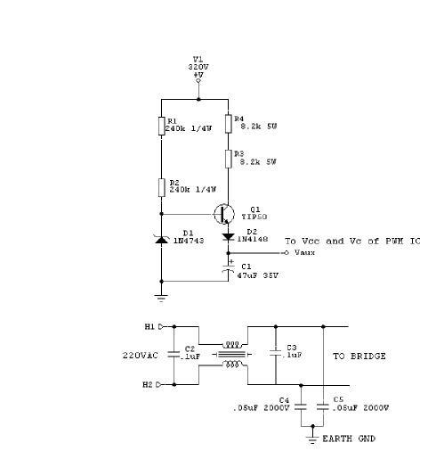

Thanks for drawing and posting the start-up ckt I described. Little error- swap the two 8.2kW's with the two 220kW's, otherwise the 13V Zener will smoke, and the TIP41 will never get enough current to power the IC. Also, the TIP41 is rated at only 100Vce, and you will surely let the magic smoke out
if you power it up. The TIP50 is rated at 400Vce at 1A, 40W P(diss). Other than that, It looks great! 😀

I was trying to help, posted a drawing without checking .
here is the correct one
chas😱
N-channel
chas😱

Chas,
I didn't mean for it to sound so.... snide? Would that be the right word? I really meant Thank You for posting the schemo. I don't know how to do it. Yet.

Anyway, I concur with the values for the components in the common-mode AC Line filter.
Steve

correct drawing
N-channel
I take no offense, I should have checked the drawing after all
someone might use the circuit and it should work.
luka
read the post by N-channel before you wire up circuit, the resistor values are wrong. resistors to base drive should be 2 240K 1/4 watt resistors, the collector of tip50 should be wired to the bulk supply(320Volts) thru 2 8.2k 5 watt resistors other than that the circuit should work.
chas

Chas- No problem. The last circuit you posted is exactly the start-up circuit I used, even the 1N4743. As for heatsinking the TIP50, I would recommend it, since there can be as much as 367VDC across it, and as much as 30mA flowing thru it, it would be dissipating as much as 11W, even if for only a second or two. If the PWM IC should accidentally lock up on start-up, the TIP will be supplying 25mA for a long period, and this would certainly fry
the TIP if left w/o a heatsink. Not a normal mode of operation, but good engineering safety practice.

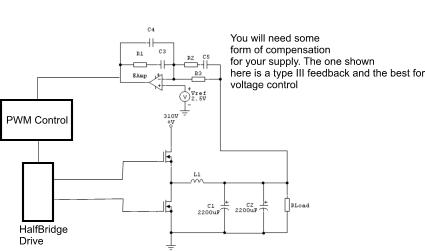

Chas- the last schematic you show is for a buck regulator using upper and lower MOSFETs, and not a true half-bridge, though the two look very much alike. I say this because it looks like you are taking feedback directly from one end of the main power transformer's primary winding. Of course, if this is a block diagram, not completely representative of the whole circuit, then I would stand corrected. 😉 Oh fudge! I just went back and actually read your last post the schemo was attached to, and you clearly state "voltage control buck regulators", so I do indeed stand corrected. Never mind!
I do like the fact that you're upgrading the '3525 to the '33025. While the 3525 is a good chip, and can even be used in current-mode (with an op-amp driving the shut-down pin), it is not as robust as the 33025, and lacks the benefit of the additional research that went into designing the '33025. How will you make this change? Did you make a smaller, separate board for the controller section? This is what I plan to do for my next SMPS. Actually, it will be a dual PWM, so I will synch a slave MC33025 to a master '33025 so I can have separate left & right supplies with separate regulation, with no beat frequencies, and the ability to add Active PFC'ing later on. I have a couple of rails of old Motorola MTW20N50e's laying around, so I guard these jealously and use them sparingly! I do wish ONSemi would get back into the high-voltage MOSFET business again. 🙁

I have opto feedback in my designe.

which you use.But I don't see how can supply 100mA, with 2x 8.2k ohm between Vbus and the '50's Collector. (330v - 12v/2x8.2k=19.2mA) Shouldn't be there only 1k ohm?2) Have you simulated the start-up circuit? I realise that it operates for only a second or two, but Brown uses a "highly starved" linear regulator consisting of a TIP50 (400V NPN), 1KW between Vbus and the '50's Collector, with a 440k W resistor srting feeding a 13V zener diode. Also, since the 3525's start-=up current is also its operating current, having over 100mA capacity will help to ensure that the '3525 gets enough power at start-up so it doesn't lock up.
