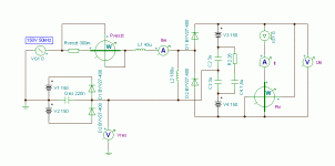

I attach schematic and PCB-Layout for your information.
-This prototype has been tested successfully with 200W continuous / 400W peak power feeding an IRS-board from Sure-Electronics and works nice since in 3 applications.
-It is short-time overload proof.
-Low-loss-softswitching is guaranteed over the full load range.
-gates are coupled capacitve achieving +/- 8V gate drive for best blocking
-this concept is restricted to half-bridge and cannot be extendet to full-bridge
-The main storage cap is definitely on the primary, large caps on the secondary are a no-go here.
-it could be a good idea to combine this with a PFC
-you need some special parts not easyly available: Resonant caps should be Wima MKP10 types, secondary elcos are polymere, and the transformer is a story of its own
-All in all this is what I could press on a double-sided PCB 80x100mm (free Eagle license)

hi Stewin
You mean except for overload? I see no ZVS capacitor.
Why? I never experienced any problem with +12V/0V drive, and soft switching is especially not demanding. Traditional gate drive voltage has many benefits. If you need stronger discharge current, you'd better use a pnp transistor.
Actually I did it. Not exactly full bridge, but 2 inverted phase half bridge, connected to 2 primary coils. Exact full bridge can be done also, but with secondary resonant caps.
Why? I do it all the time.
Any kind of polipropylene cap is OK, elcos can be standard if soft switching is really maintained. Yes, transformer needs some special knowledge, defined leakage and magnetising inductance and litz wire are required.
Nice work!
P.s.:
Why NCP1396B, if you don't use any feedback? Much simpler IR21531 can do this job perfectly! (Or if NCP1396B, then you could have designed stabilised PSU, with lower loss and protection.)

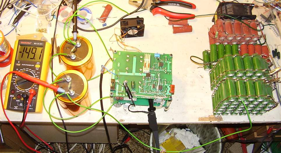

As this converter works at constant resonant frequency, the magnetizing current of primary winding is constant over full load range, while the resonant tank current crosses zero during switching. With an appropriate dead-time the bridge-output toggles within constant-time and achieves ZVS, load independend. I did verify this and can provide scope screanshots as a proof of my claim.
Due to ZVS there a no strong demands concerning gate drive. Anyway I prefer this ac-coupling, because of higher blocking safety - and more than 8 pos gate drive do not make a significant difference concerning on-resistance of pow4r MOSFETs.
Choosing the controller was quite arbitrary, these ON-semi device were just at hand for me. Many others will do.
Concerning the resonant caps - I tested them under full load conditions, and some of them got hot or even exploded due to high ac-voltage load.
Why low capacitances on the secondary side?
It is a matter of reliabilty - with bigger caps the peak currents on 100/120Hz main voltage peaks increase the same way we know from conventional transformer supplies. Primary current peaks can rise substantially, destroying primary MOSFETs. I suspect this to be one of the dominant failure mechanisms of half-bridge offline converters.
Applying bigger caps using my LLC-converter will not be lethal due to inherent primary current limit - but it will suck your power reserve.
Another pro for the primary energy storage is size: One 330uF/400V stores at 300V the same energy as on 33.000uF at 30V.
When I fired the IRAUD-amps bought from sure-electronics I removed all these 1000uF caps and replaced them by 68uF/400V - these provide sufficient ac-ripple capacity. It takes a bit to accept this idea - but think of it.😉
This is true up to the point where current limiting diodes start to conduct, and make a phase lag. The higher the drop, the higher the current during switching.

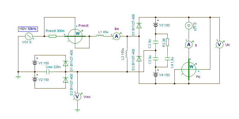

OK, let's assume there is a current demand. If there is no big cap, then what will make it? ... think about it! 1 way in, 1 way out... And the correct answer is: the LLC converter. Do you think this is better then draw from a big cap?
You can't expect a cap draw current all the time! There must be some time when it gives charge back! 🙂 When will this happen? ... When the amplifier needs it. Can it be better then this?

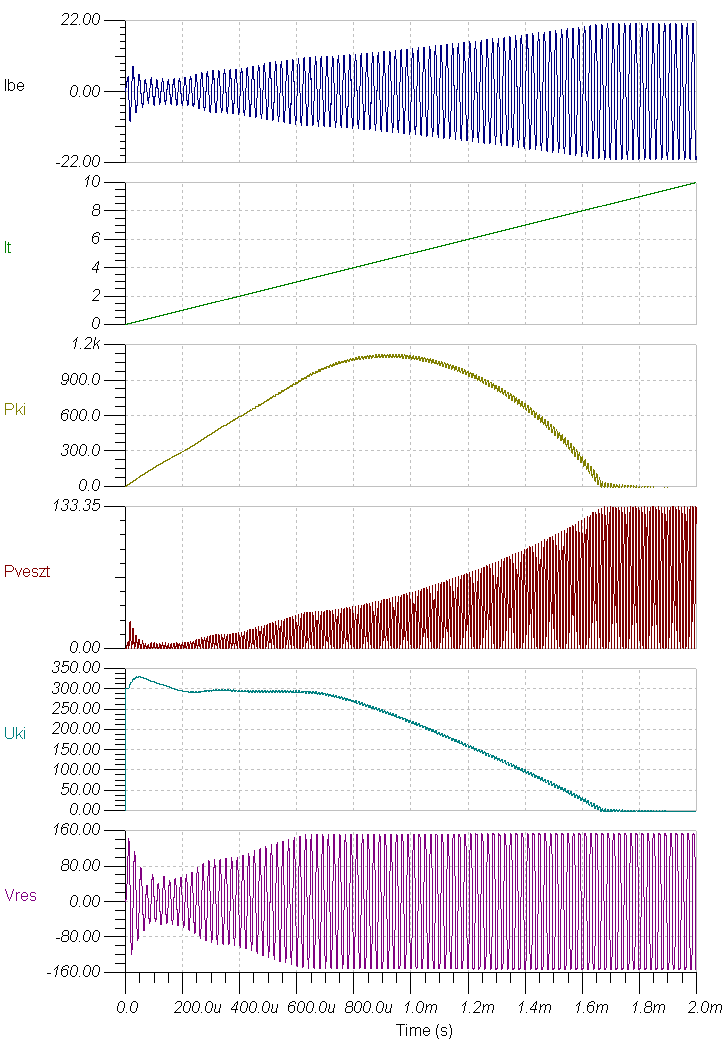

I did some measurements and simulations with different sized secondary caps and it is evident that peak currents can rise far beyond safe operating area of my MOSFETs.
Then you made something wrong. It doesn't work for you, but works for me and many people. Over 1 kW power output limit with a much cheaper FET, simulation and test includes short circuit.

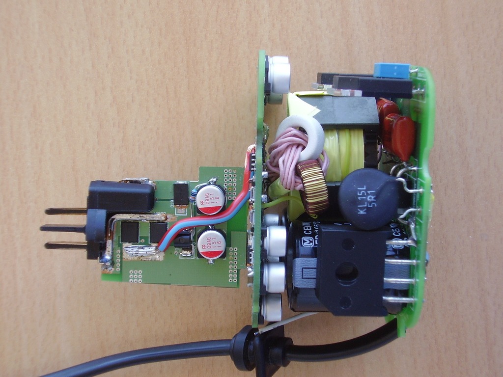

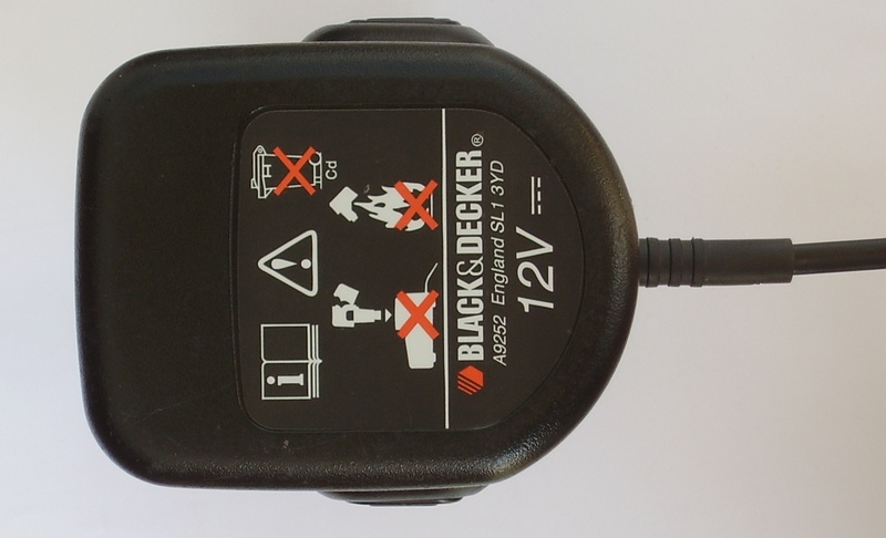

I used polimer caps also, where it was really neccessary. I had very limited space (less than 60*80*50 mm) for hugh power as you can see.
In your application what makes space so valuable? Audiophil cap is a totally different question, quite irrelevant.
Do you think hobby project makes unneccessary cost and undersizing reasonable?

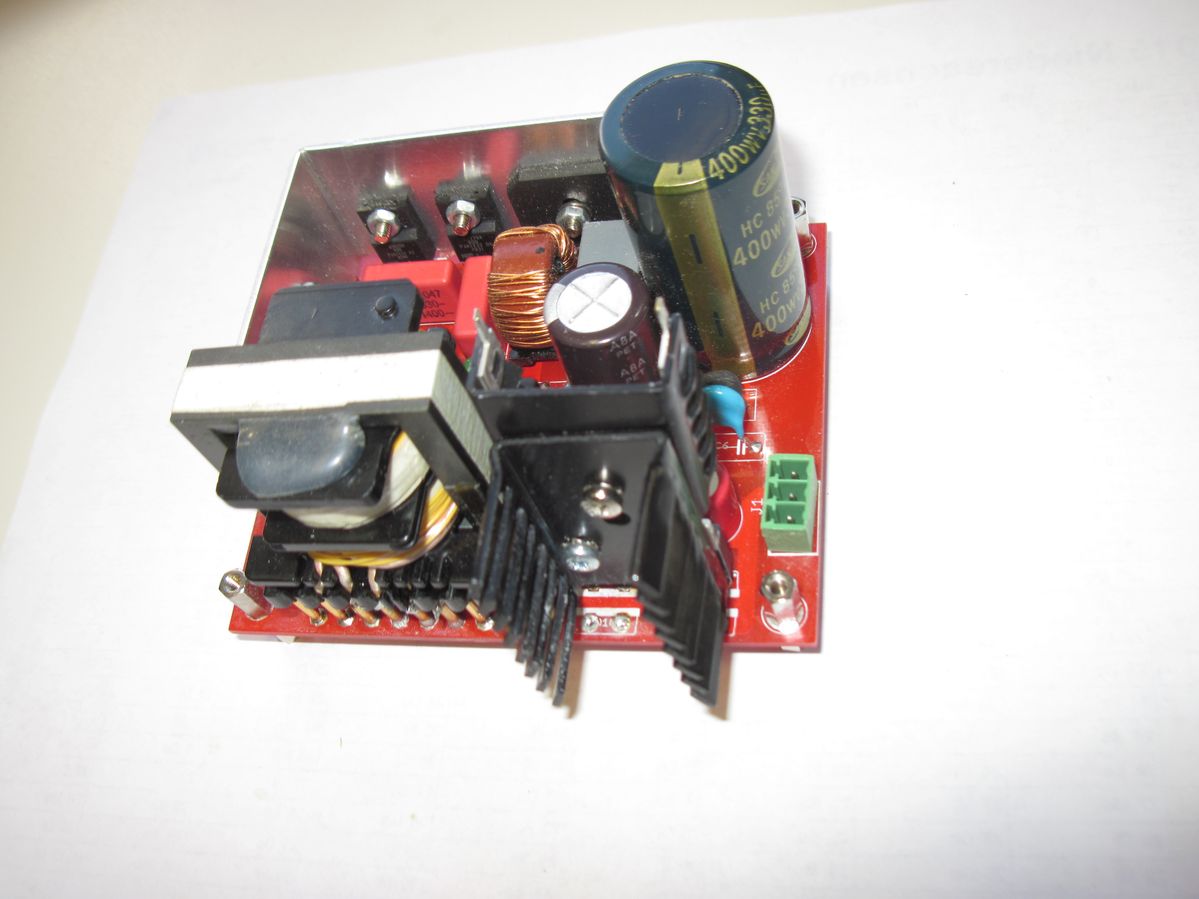

hi all my latest project .my previous projects work well .but i have made something smaller and i wanted to improve on gate drive design 😀
😕:scratch: just wondering why full bridge is unpopular in this forum ???😕
Stewin, that SMPS looks great. Well laid out circuit and PCB! If you allow me a suggestion I would definitely use a PFC above 100W, also an NTC.
