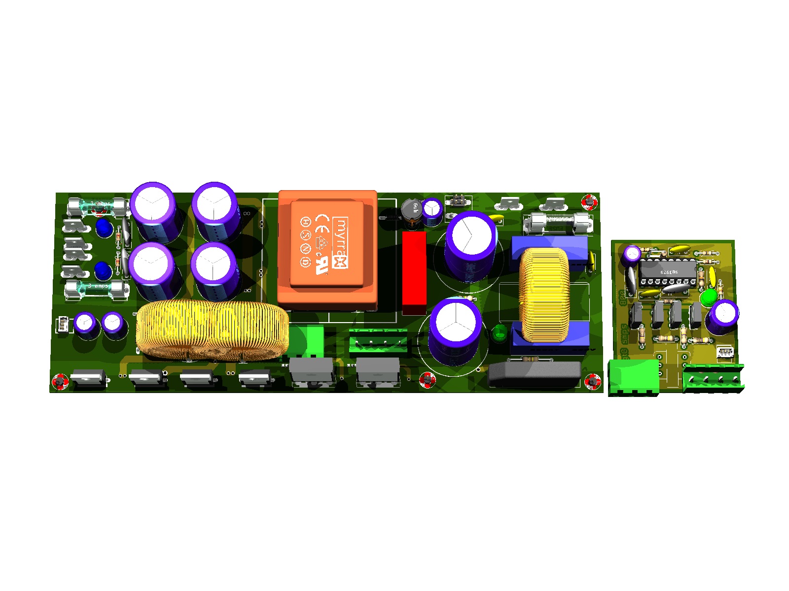

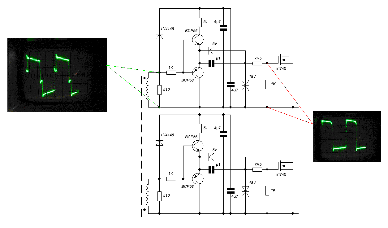

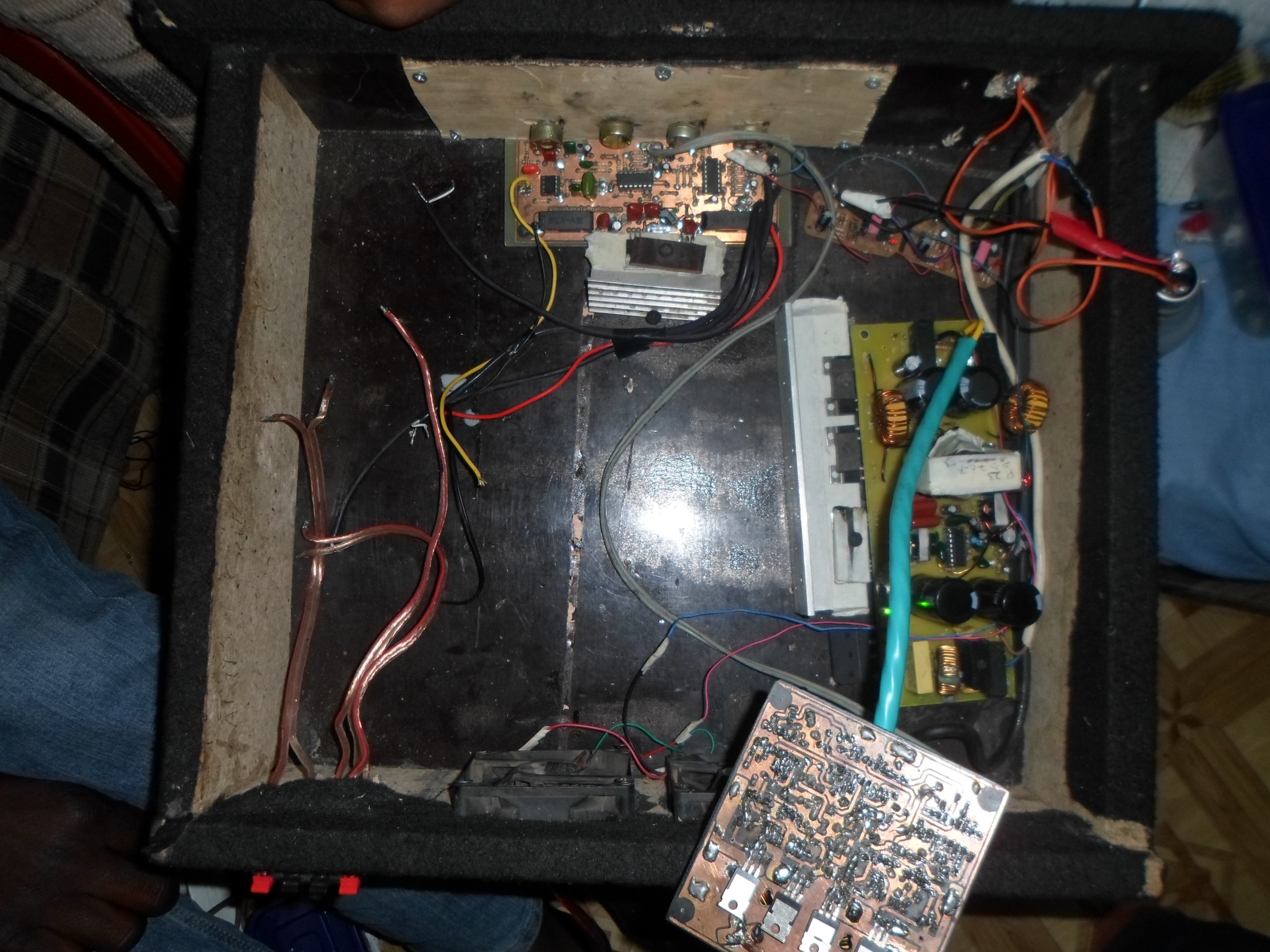

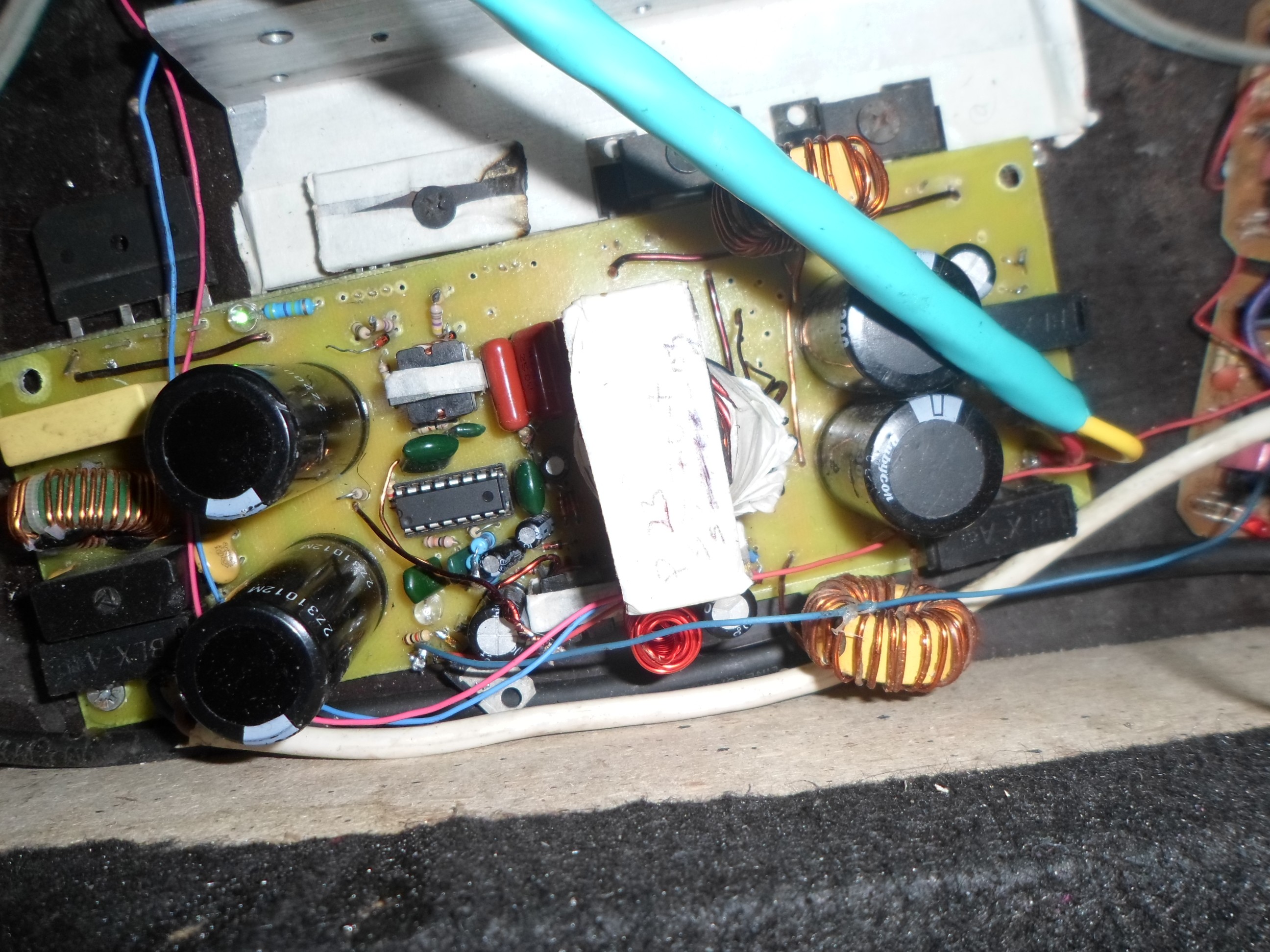

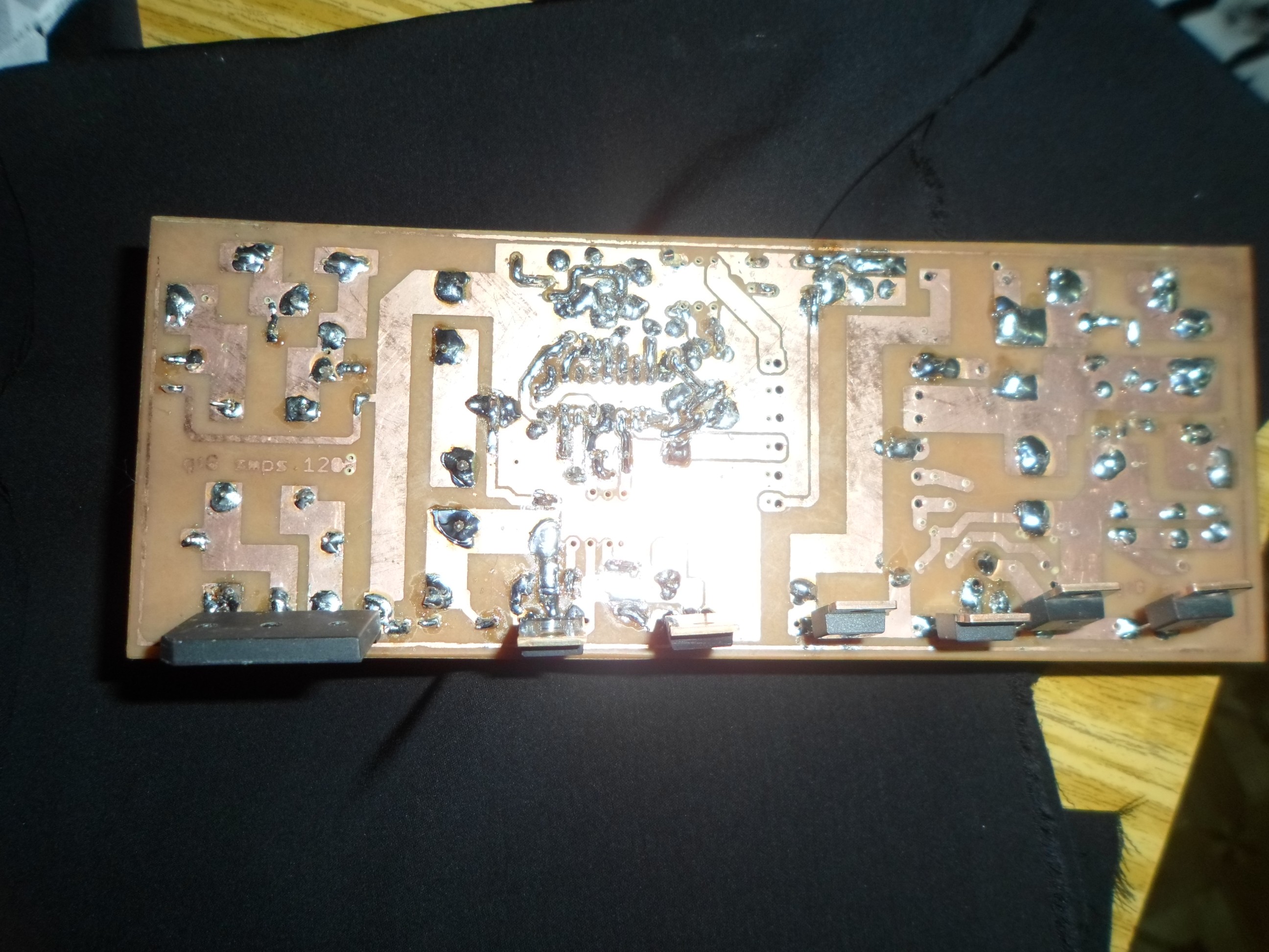

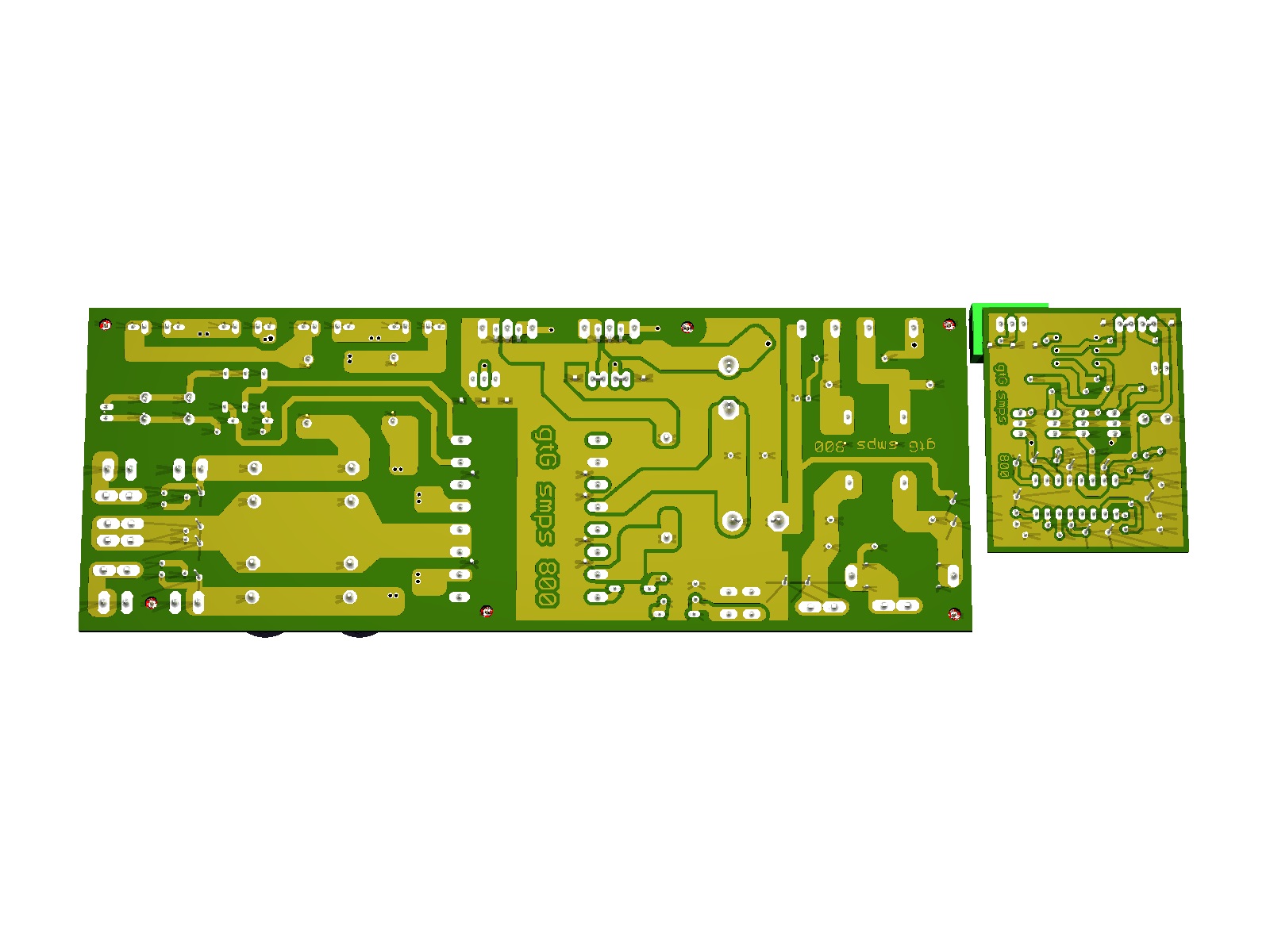

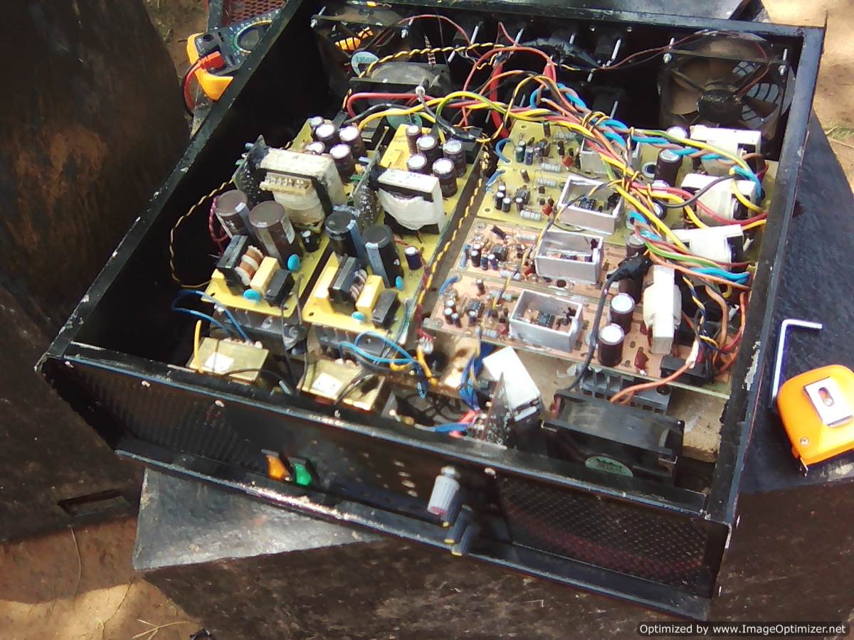

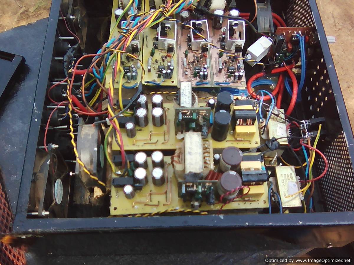

hi all . my pictures of my half bridge power supply . i used bd139 and 140 to drive the gdt because ic sg 3525 failed some times when driving gdt directly. one smps was +/- 75vlts dc for midrange and +/-85vlts for subwoofer .amp was ucd class d

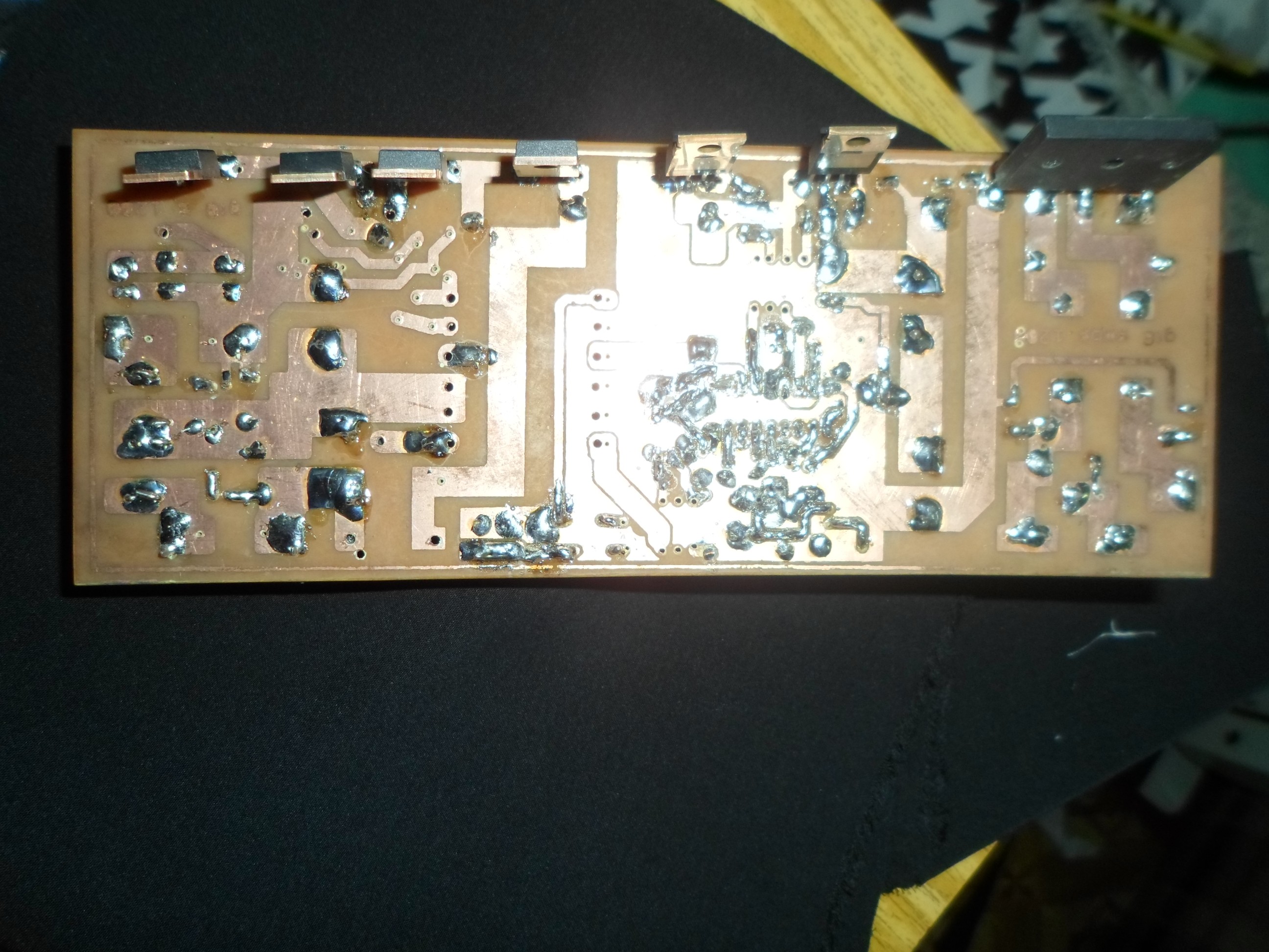

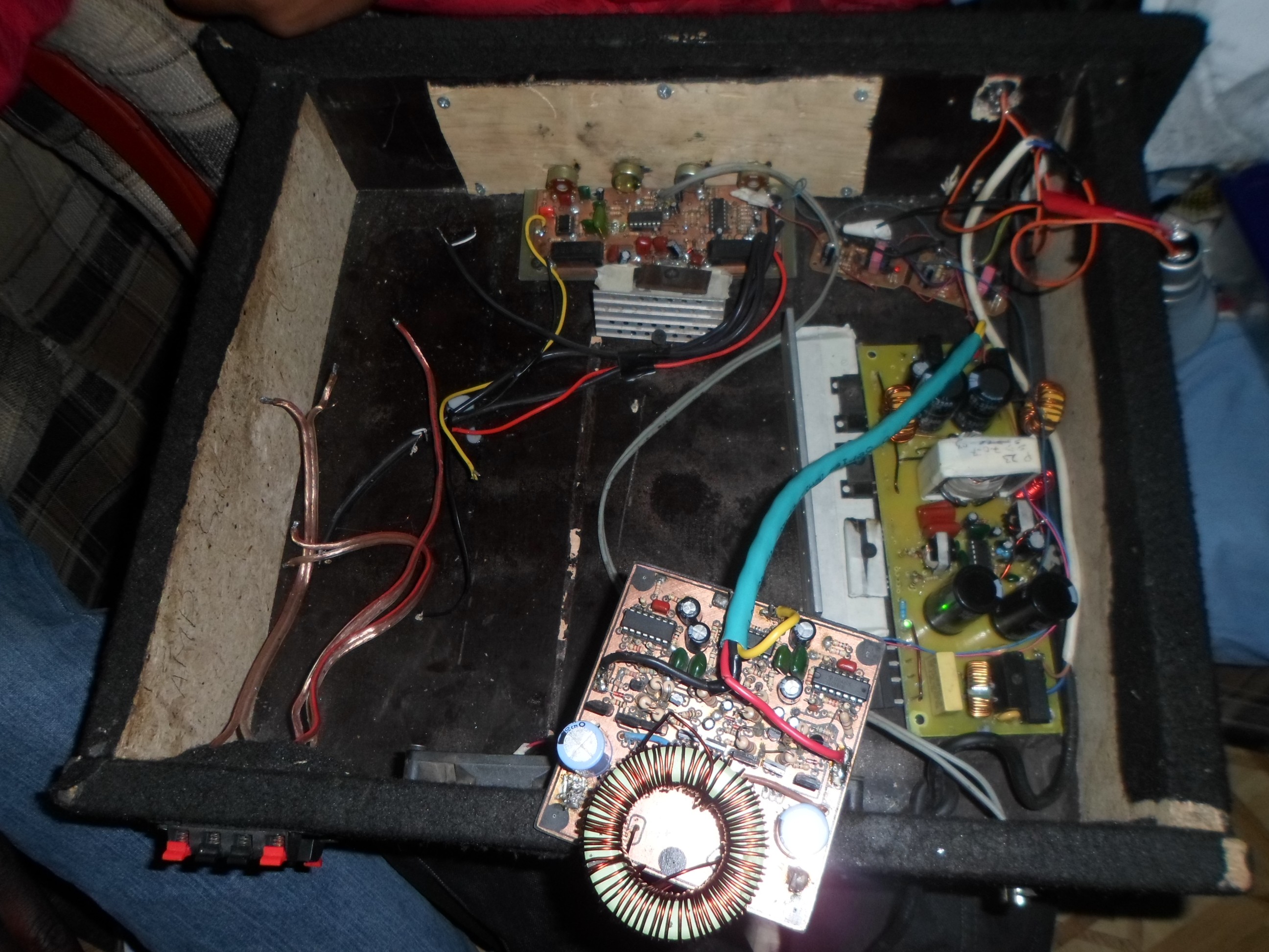

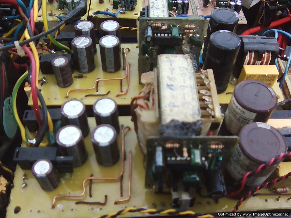

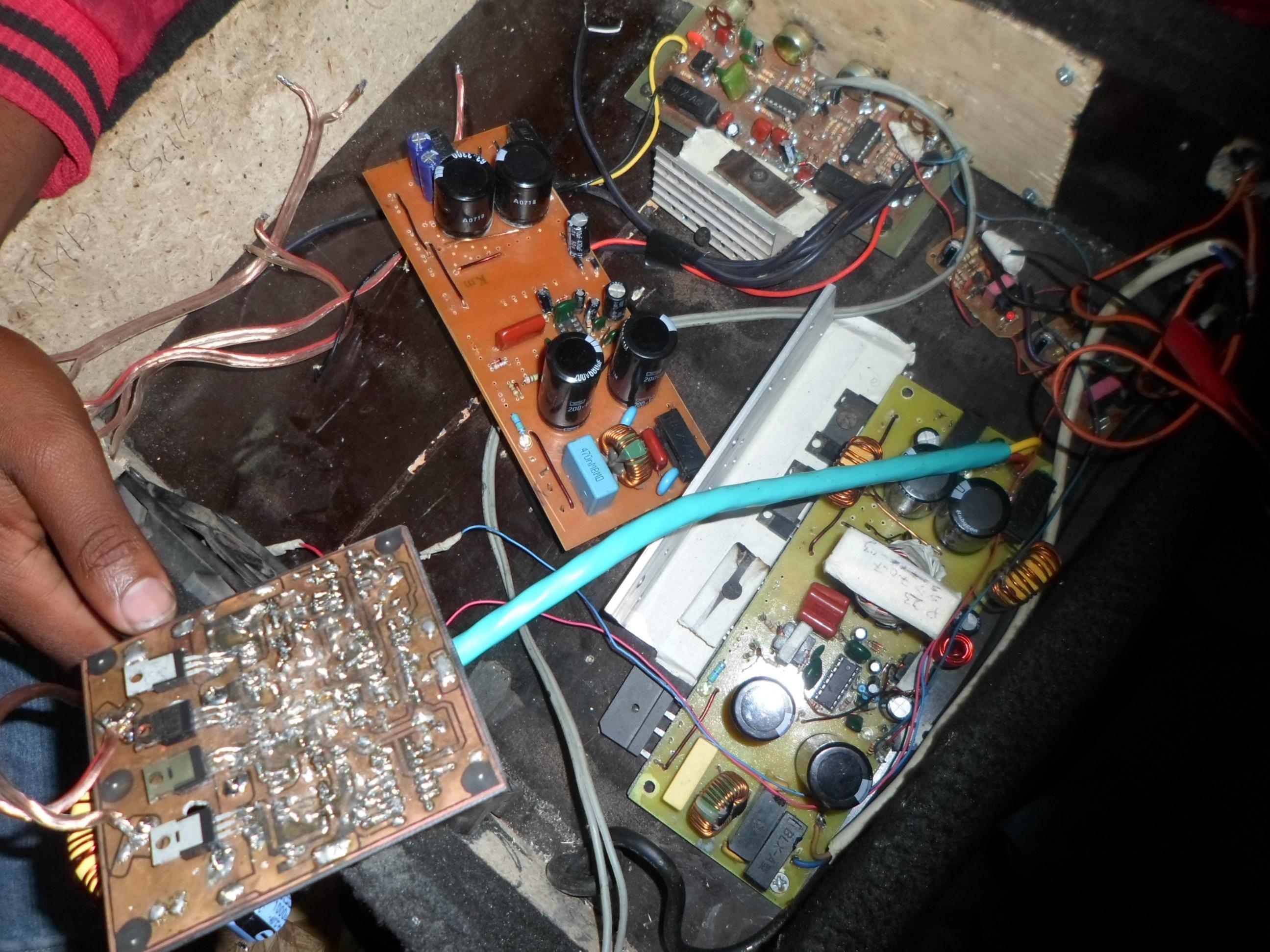

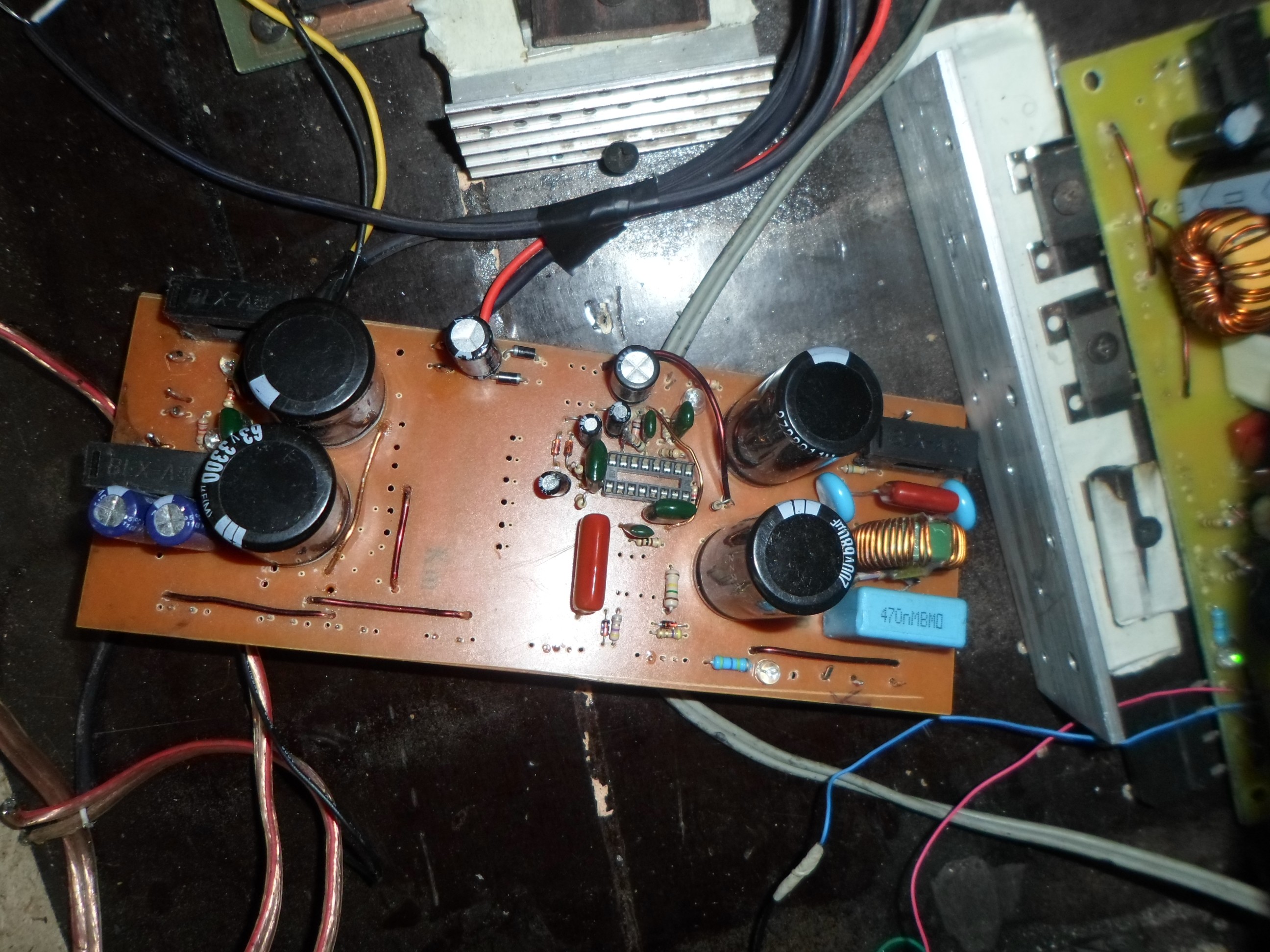

more photos on the project .
Based on the 3A fuses I see on the +/- outputs.... I am assuming your loads are no greater than 2 Amps per rail....
I consider this low power converter...60W to 100W range....
Much easier for you to make the Push-Pull converter ...less parts and no high side driver...all low side GND referenced drivers...you can probably use the same chip ....
If you are bent on using the Full-Bridge.. then use a gate Driver chip between your chip and the FETS.... IR makes some that have ISO for Hi and Low side driving in Bridge config...
I use gate drive because ir 2110 when smps fails ir fails .but with gate drive fets are the only things to replace
i meant gdt gate drive transformer .
😕btw i have been using my gdt design without any issue .but just wondering will this method of driving fets.improve the perfomance. i use irfp 460. at 70khz 😕
Looking at the complex secondary side oft GDT I would prefer the silicon half-bridge drivers. It is true that a failing power-MOSFET normally breaks down between drain and gate thus destructing its gate driver. But there is a simple solution to avoid this: You insert a coupling capacitor into the gate line that is capable to block supply voltage, something like 10nF/400V=. To restore DC-component you bypass this cap with 220kOhm/0,5W. You will never have to replace the driver-IC after that!😉
hi voltwide thanks for the contribution. my transfo gate drive works good with irf740 and irfp460 but on igbt,s the igbts gets hot on powering up even without a load .i wanted to try the above because the square wave at the gate is clean. maybe it will work better with fets or work with igbt.
btw have you tried your design with success it??
i use 8 amps fuse per rail ,because 4 amps is small and it fails when the amp is pushed hard. i,ve used transformer gate drive on fets without any issues. but i wanted to go full bridge to attain more power on smps.😀
