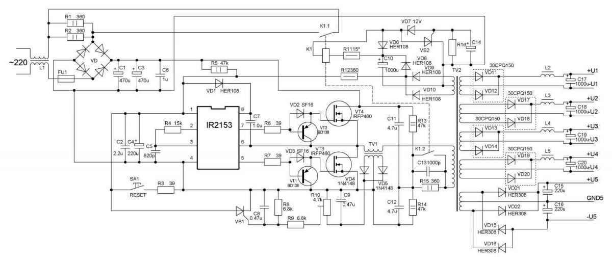

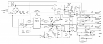

Found this on net, check drive for FET'S simpler,protection looks solid,you can use your resistors in lower FET source if you like but what a power waste,current transformer best solution.
thanks chas 1 for the quick reply is the schema you send good ? i can change mine to resemble your schema . also is the protection o.k and sensitive to over current ? .
also can any of the below igbt be useful with ee55 to give 3.5kwt ? i have them from old ups.
IRGP30B120KD-E , IRG4PH40UD2 , K30N60 , IRG4PF50WD , k40T120 , IRG4PC50U , IRG4PC40U , if i use them with a fsw of 100khz.? ? thanking you in advance steve.
As for IGBT's you need to check datasheets and the spec' that I took a peek at for the IR2153 seem to indicate the max osc freq for this chip 100kHz then a fsw would be 50kHz.

As for the current limit it can be adjusted over a wide range,the idea is when the SCR trips it shuts down the osc and I think you need to look at some of the waveforms to see the effect.I set my limits for about 10% over current for the load.If you use a standard current transformer from Coilcraft they spec the burden resistor per amp so the setup is easy.If you have some softstart then the only time it should trip is at your over current set point.By using LTspice you can simulate this design to get an idea of the problems.
This is not my design, I ran across it on the web.I don't use this IC nor do I plan on using it .

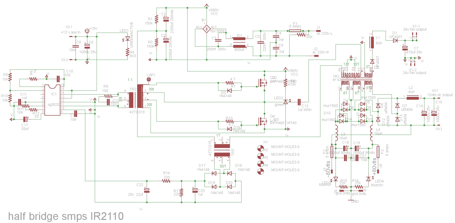

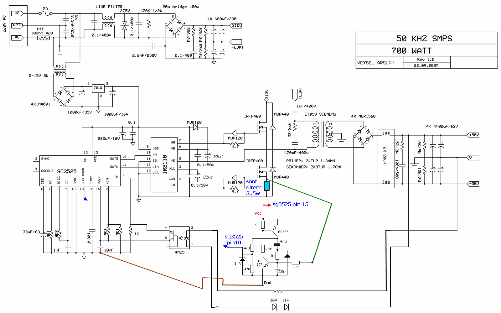

with protection which is the best stable smps among the two below schema?
How about the design you posted or Luca's and there are more of them as for protection for the supply , downstream load or what?What control IC are you using as this will determine the type of protection that can be applied.The SG3525 has a shutdown pin as well as the IR2110,the MC33025 can be configured to monitor the current on a pulse by pulse basis, so by changing the control IC and the driver IC you can design a robust protection scheme.Refer to chapter 8 of High Frequency Switching Power Supplies Theory & Design by George Chryssis.I will post an LTspice of a couple of current limit circuits as well as the simulation files so you can try them later,you must have LTspice its a free download and the basic learning curve is short.I have played with a micro to handle my protection but its overkill in most designs.As for adding resistance to the low side FET in a HB I don't like as it adds voltage drop on the low side, ok for forward converter as the Fets are on at the same time.As for a stable High power supply don't rule out the Two Switch forward, designs for over 5kW

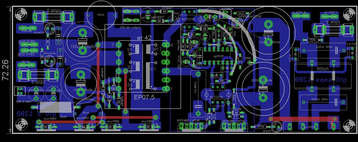

my latest lay out. but i will use external aux +12vlts
smps half bridge irfp460 smps single sided schematic.pdf34.1 KB · Views: 837
smps half bridge irfp460 smps single sided components .pdf37.8 KB · Views: 640
smps half bridge irfp460 smps single sided pcb bottom .pdf46.7 KB · Views: 658
i used the 12vlts using droppers but they got hot .so i prefered using small 12vlts power supply to start the oscilllation.

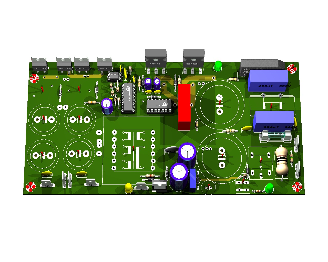

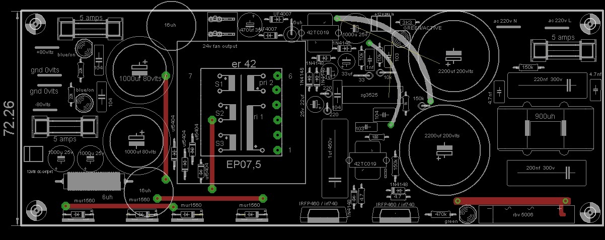

hi all by the way my above project worked perfectly with some few adjustments. i used irf740 and all was powerfull and o.k
now i wanted to do one with protection and transformer gate drive . as to do a full bridge in the near future.
smps half bridge single sided transfo drive board tracks.jpg267.4 KB · Views: 1,147
smps half bridge single sided transfo drive artwork.pdf310.9 KB · Views: 545
