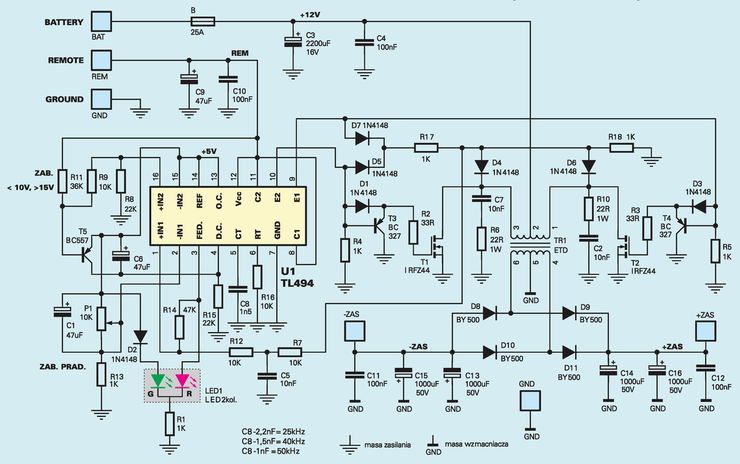

car smps
i creat this one
when i conect battry cable the red led turn on
the mosfets is hote and exit voltage is +-5vdc
i use 4 irfz44n mosfets
can you creat this one?
thanks

I will look into it,I think I see the problem

Where is the problem?
Transformer
I suspect your transformer is your problem; check this site for proper design
and construction.

where is my shematic wrong?why red led is turn on?when i dont conect the core that is turn on( red led)
The red led is connected to feedback(output of error amp) and will turn on red led when you apply power because of the way it is connected,look at P1,R13 connection and R14.I think if you adjust P1 you will get the red led to turn off(has nothing to do with why your supply does not work.Visit the website I provided and all will be explained ,Start with the correct core for the power requirements and wind it according to instructions,test the inductance with a VOM that has an inductance feature,fed a signal into the primary and check secondary signals.Refer to info at ESP website on checking transformers before mounting.Whatever control IC you use you should read the datasheet,check block diagram of internal circuit to understand its functions.Don't copy a design unless it has been proven to work and a proper PCB is supplied but if want to learn design in stages and check each one, start with control IC first(only requires a few components to function and you can do this on a bread board)apply feedback and check outputs to see the PWM signal and make sure it provides the correct outputs.Once you have the control part working the rest is cut and try to obtain the power you need(use dummy loads)only connect amp when all is well.

That smps work with sg3524
I try to find some think in my smps site but the site languich is turkish and main pdf file is rushen maybe.
I dont know this languich.
I try to find smps with tl494 because i have meny of them.
In main site of may smps they use irfz44 and etd 39.
I try to confige red led with pot1 but it was not work.
Can you advice to me one shematice of this topic?

Get the datasheet for tl494 and take a good look,the difference between the pins you need to use and the SG series in very little,google for an atx power supply schematic it might help as most of them use the TL494.
Here is another circuit that uses the tl494 and it powers a amplifier:
