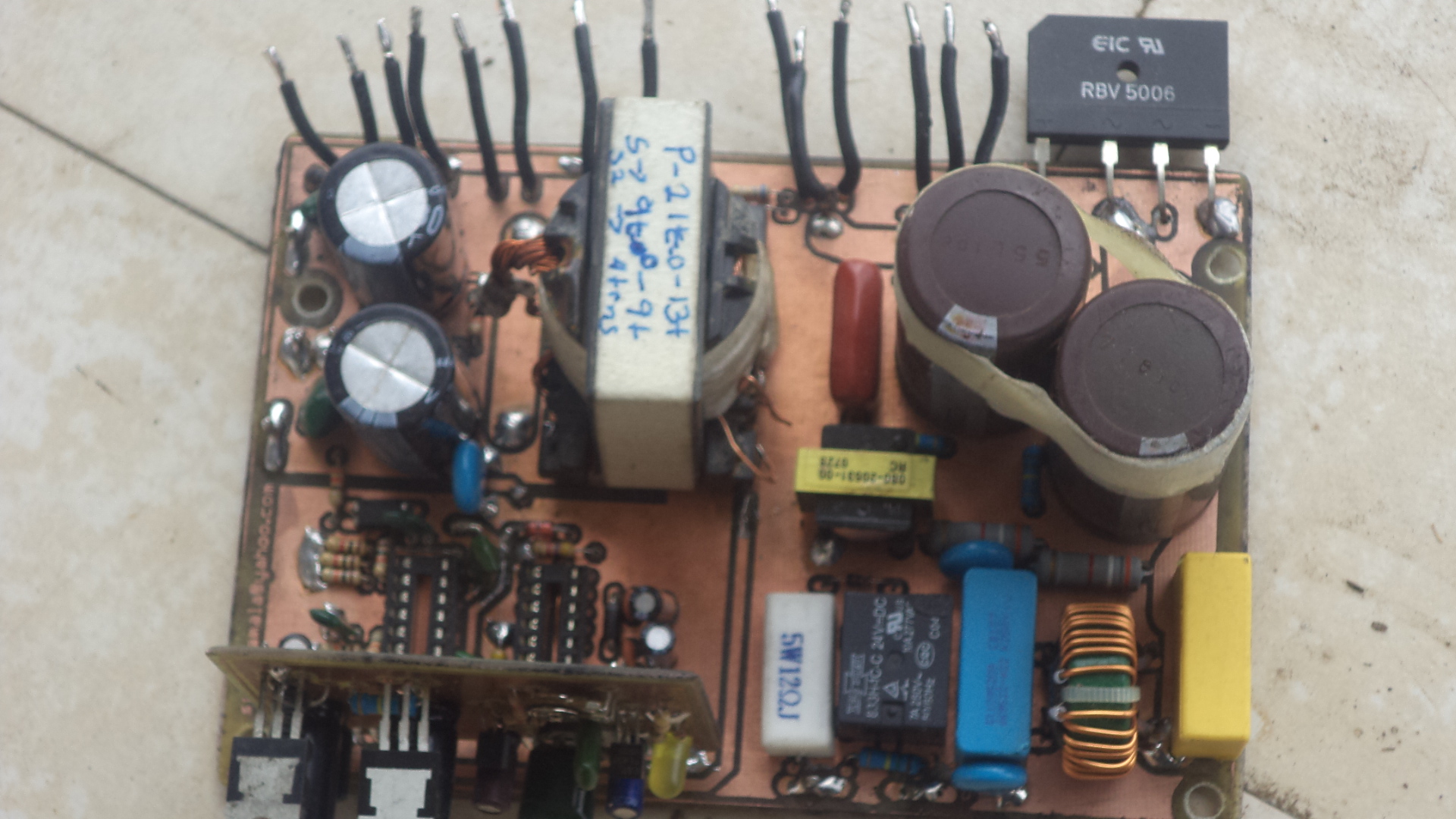

That is some outstanding work. I am happy to see you complete your project. Your work makes me want to finish what I started a long time ago.
Given what you have to work with and more, you have done a super job. Keep up the Great work.
Please show us later the whole project when it done.
Thanks for Sharing😉

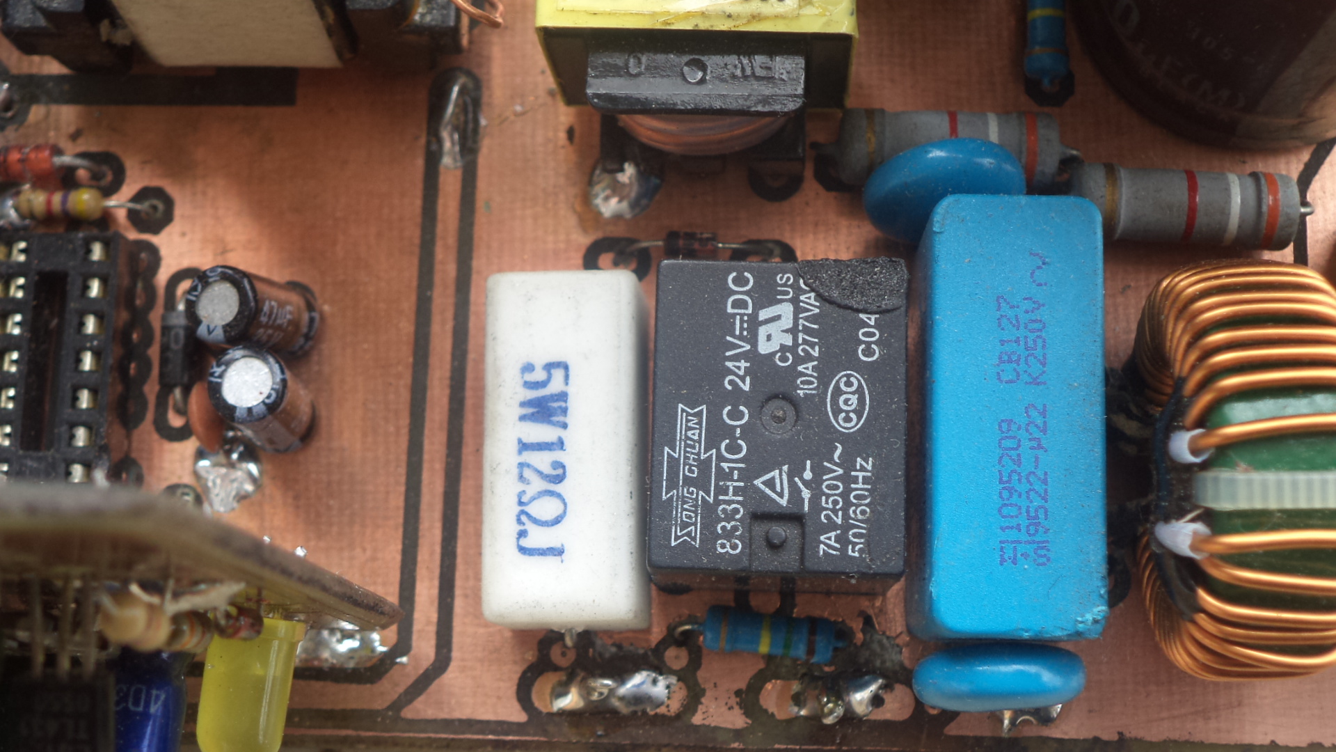

For long term use , I would check the components in the startup circuit,I think you can do without the voltage regulator.The 24volt supply would be about 14 volts according to the components used.The 2.2k resistors are rated at two watts when a pluse exceeding 10 watts will be present during startup and if the 150k is 1/4 watt two resistors should be used to obtain its value because the voltage breakdown will be exceeded in a single unit.
thanks krisfr
i used zeener diodes as voltage reg because the voltage adjust never worked i set the voltage to +/-36volts pls see more photos at the diy smps link
http://www.diysmps.com/forums/showthread.php?250-IR2153-smps-with-short-circuit-protection./page21
Forced Gifting
+/- 80volt outputs but output caps (4700uF@50VDC)?/
Forced Gifting
I don't belong to diysmps,as for your voltage adjust and other sections of your design use sources you can find on the web or simulate the circuits in question until you get them to behave and try to stay away from power grabbers like zener regulators that require more passive components(heat generators).A good free simulator is LTspice and its free the learning curve is short and has a excellent forum.I will post a simulation of your design shortly.Check your design before PCB layout, I would make the first one slightly larger to make it easier to find problems and allow room for modifications,I would layout a farm of pads along one side or a corner for design changes of circuits for prototype..small signal stuff.
