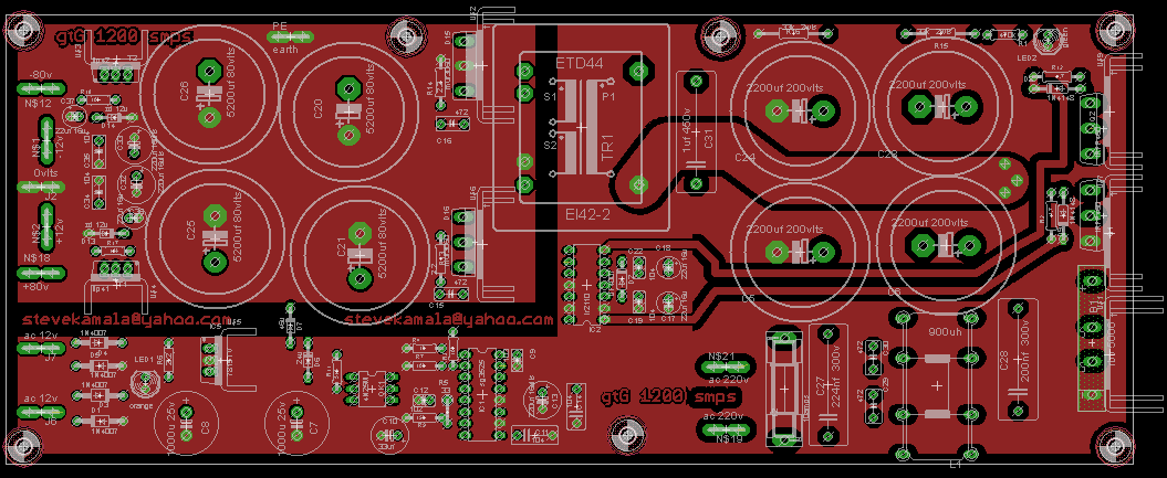

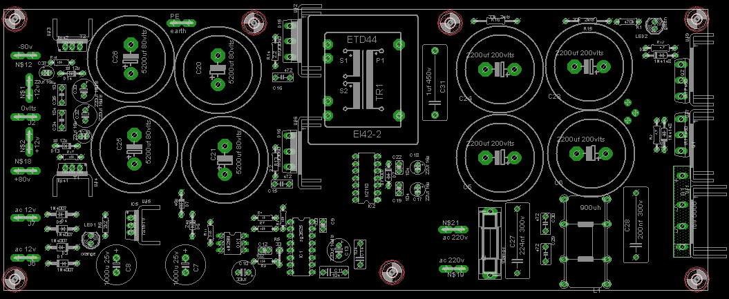

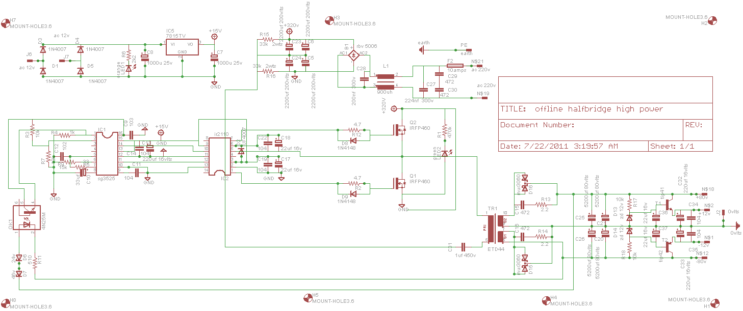

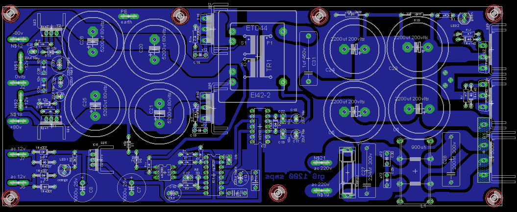

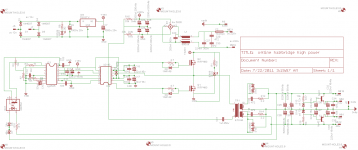

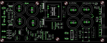

hi luka and all i've finally completed my smps and tested it for 2 months although i am using a small aux former it is cool and power full thanks guys for your support.
http://farm8.staticflickr.com/7141/6524827599_ce30830e42_m.jpg

one question, why did you place fets like you did, and use wire to connect them, while they are on heatsink, like you show on the picture?
And I see you have double sided pcb, that should be easy to connect them via pcb... this part I don't like too much, and I hope you will explain why you did this
Edit: not fets, but output diodes
Good job Steven!
@luka, it appears to me it was easier to solve the mechanical mounting of the heatsink horizontally. It also looks like it was his first project so I wouldn't measure it with very strict engineers' eyes. 😉 For a hobbist it is a prime job with CAD work, etching, etc, not to mention he used surplus parts.
So I would say Steven: thumbs up mate. 🙂
And this is my point, he done so good job with the pcb, he sure could do with mounting the diodes and fets too. Someone has to be critical, to push him even further on, making one even better. As far as i am concerned, I couldn't be more happy to see this thread help someone else beside me!
Using Stewin's supply as a base, can it be added to so that a pfc and 110 volt input could be incorporated into it, or is that TOO much of a hassle?
I can't remeber what was the performance of Stewin's PSU, but as for the core he used I presume it is above 70W, which means here in the EU the PFC would be mandatory for that PSU. I don't know the regulations in the US though but PFC is always recommended so IMHO it always worths the hassle.
As for the 110V, if you're lazy you can simply half the number of primary turns and adjust the frequency if necessary (and mind the core and FET temperatures!). Although I would strongly suggest using a transformer calculator to find the correct values.
This might help:
http://www.its.caltech.edu/~mmic/reshpubindex/papers/buckwalter.pdf
note:No voltage doubler ( low costs IRFP250 used,no pfc).If turns were calculated correctly
then Vbulk max would approach 385VDC@220VAC max (270VAC) a good value for pfc output.
chas1
chas1
SAFeTY
Looks like you spent good time designing your SMPS, But seems to me it suffers badly from safety issues, witch visually didn't pass for me.
Like, but not limited to creepage distances, Isolation, etc..
Good Luck
Good Luck
Hi Guys.
I'm intrested in building the Luka's Power Supply.
The difference is that I need just a single +24V output.
What kind of modifications do I need to do in the circuit?
Thank you.
Thank you.
