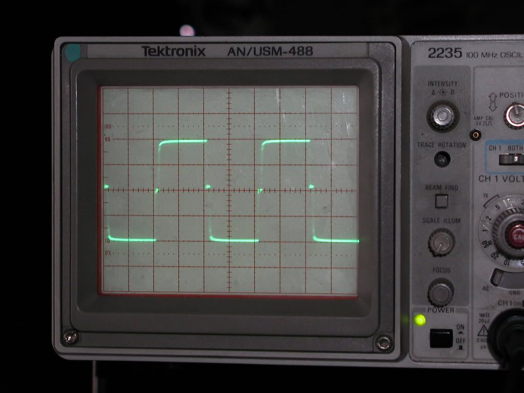

Hi
This is original waveform with no snubber

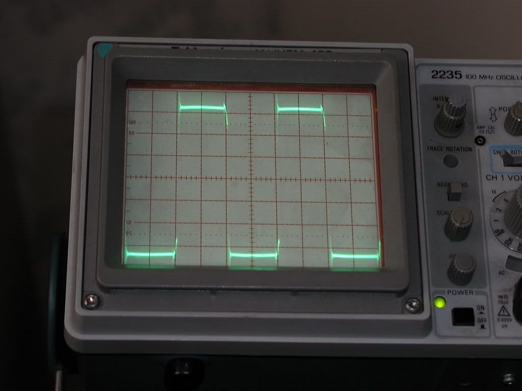

Then I've put snubber on. It is made of 3.3nF and 89 ohms. That 3.3nF is way better then other caps that I have here, it is also really big for 3.3n, but all it is writen on is (3.3 k 4 and below that w6c and simbol of company that makes it)
This is how it looks with it
What do you think, is that good enought?
snubber
Luka
Is this waveform taken across the primary, I don't see any deadtime. what about the waveform of the gate to source and also the waveform at the diode before the inductor. However I think that you have snubbed the switches correctly, I see no excessive ringing.

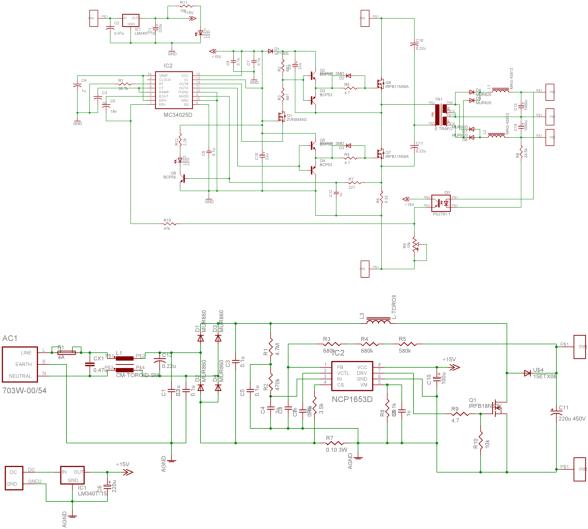

Michael Price's Project
Luka & N-Channel
Michael sent me an email with the schematic's of his project and with his permission I am posting them, this is his work and I will inform the forum they never got the supply to work but the amp does.
chas1
