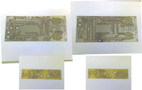

boards
well here are the pfc and 50 amp 16 volt charger boards

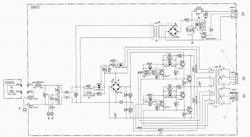

Hi Luka,
I've just found an interesting smps schematics: YAMAHA YST SW800
something like 1kW without any ic driver, just discrete approach (6 bipolar transistors) switching @40kHz i Think.
I would like to try it what do you tink about it ?
I'd like to try it with a FT240-77 core...
Hi
If you want to build it yourself, I don't know. This is selfoscilating and is the most difficult to make it work right. It sure looks good, but I don't recommend it. And it is unregulated. Transformer is a key to make it work. It produces main power, but also transistors drive. I wanted to make one such as this, even if for low power. But I have been convinced otherwise by guys/girls here that know thing or two about this king of smps.
If you would like to buy one, I hear that smps from coldamp is great for damps
